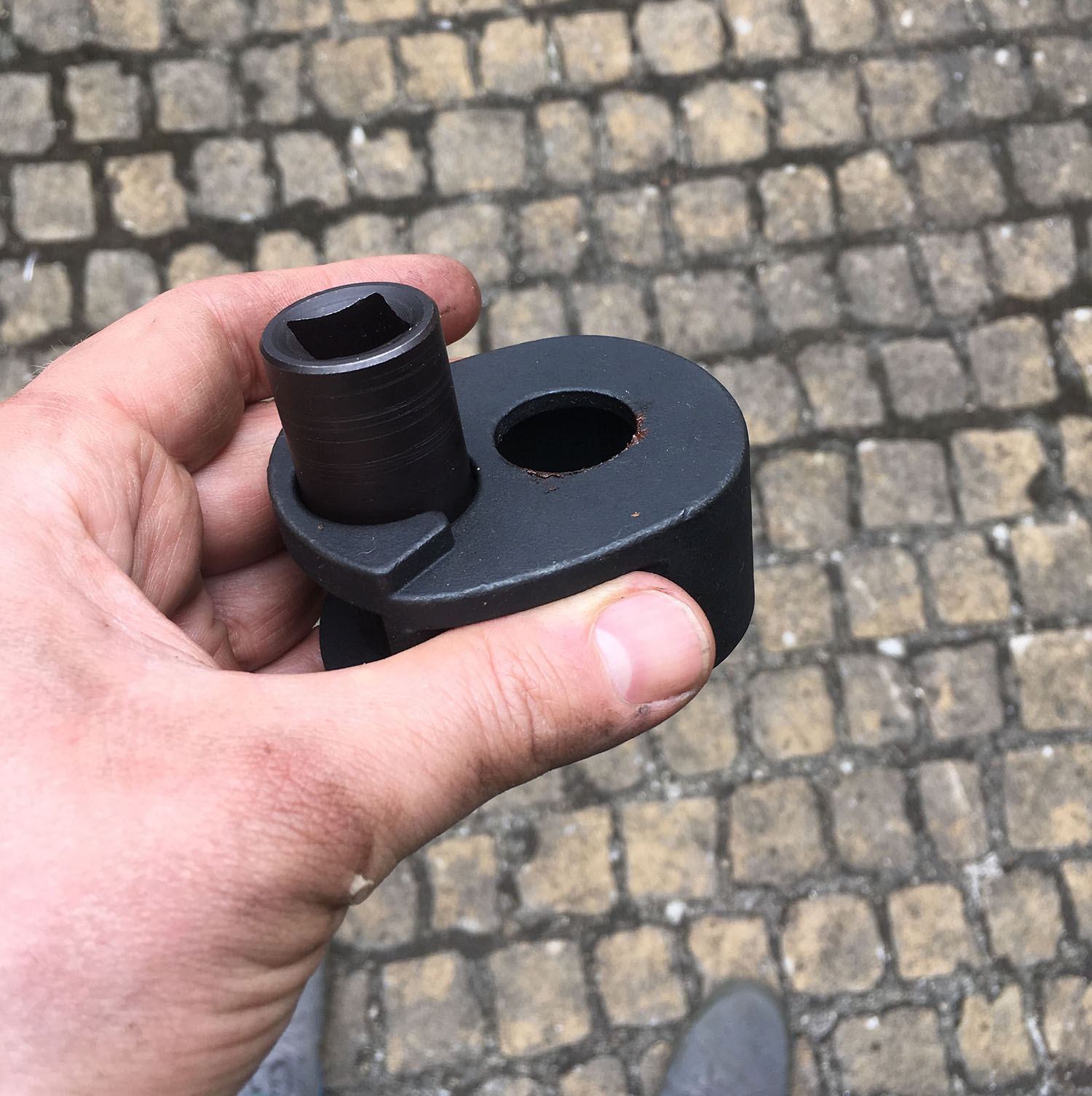

Decided to tackle my tie rods today. First off I couldn't get the wheels off since the refurb meant the lacquer had jammed them on. Managed to get the nearside off (the one without play) and it was easy. Outer tie Rod popped off no trouble, and the inner tie rod tool I got off eBay for £12.99 worked like a dream.

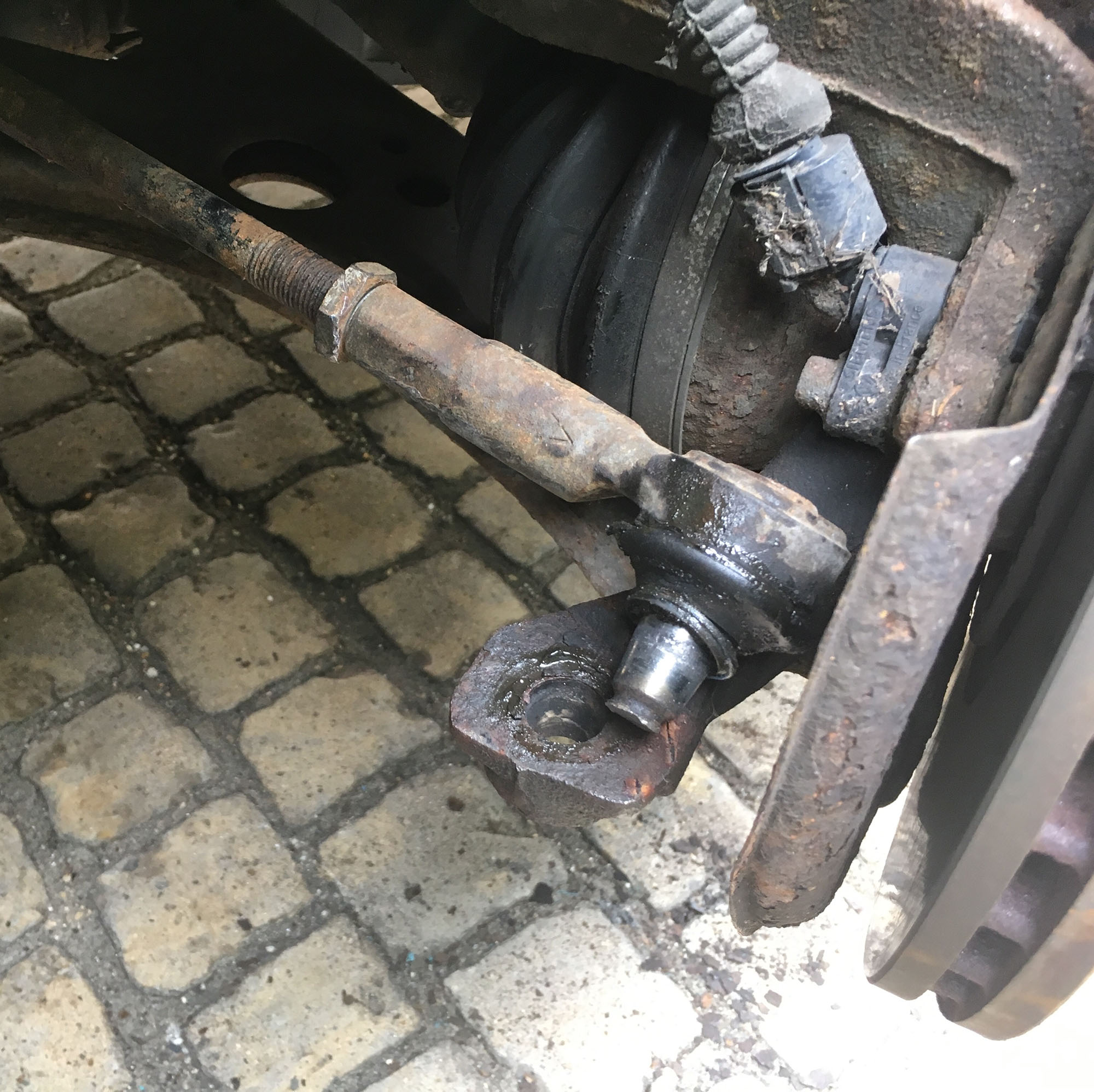

The other side has been a different story. I don't think it's ever been replaced since new - 14 years. The outer rod is seized solid. In the end, I got enough of a gap to be able to saw through the lower part, and was expecting to just pop it off, but it's solid.
Looking at it, there's absolutely nothing that should be stopping it from just popping off, but I've been hitting it with a bloody great mallet for ages and it hasn't budged. I've sprayed Plus Gas in there but nothing is happening.

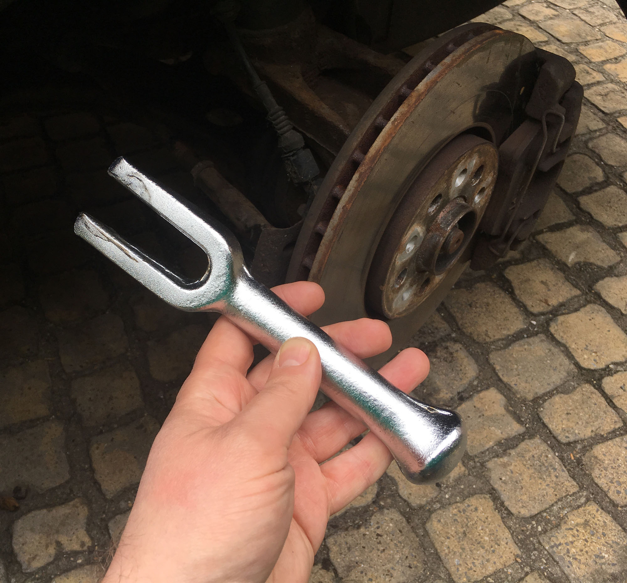

Has anyone else had this problem? How did you solve it? I can pick up one of the fork style separators tomorrow, but don't know if there's anything else I should be trying. Is it common for them to fuse here?

That's why I had to saw it myself. There's a slot for an allen key at the bottom of that bit, but it was so stuck it ended up rounding off the slot. Luckily there was enough space to get the saw in there without damaging the bit it's pushed into (I have no idea what that bit is called).
I've tried tapping it from underneath, but the issue there is just having enough room to actually get enough of a swing of the hammer to knock it through.

Thanks - staying calm is probably the hardest thing to do right now, when I've got a car that can't be moved sat on my parents' driveway. It sounds like the 'pickle fork' approach is looking like the best option, as they cost between £10-20 and I can probably use it for other stuff too.

Went down to Halfords this morning and picked up a bearing splitter, and having spent the best part of yesterday afternoon pounding at the outer tie rod arm with nothing happening, four or five hits with the splitter and it was out. It only cost £7.99, and for the relief it gave me it was well worth the money.
It's mad how much difference the right tool can make - I've seen a couple of YouTube videos since, where someone's taken a huge great hammer and smacked it over and over and nothing's happened, only to take the fork splitter, tapped it a few times and it pops out.

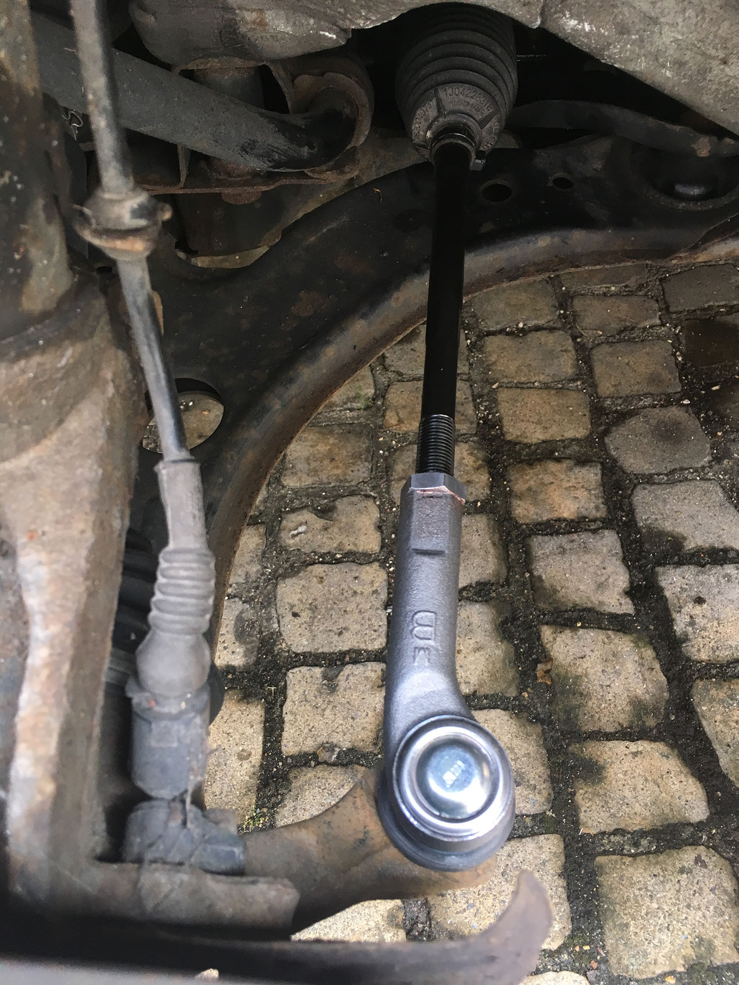

It was a pain in the arse getting the boot off though. I ended up ripping the boot off to get at the inner rod and take it off so I had more room to work. I'd bought two new boots just in case, so I was fine destroying it. It was pretty weathered, so could probably have done with a change. Wiggled the clip off and then put it all back together. Copper slip on the outer threads.
For anyone wondering, the inner tie rod tool was incredible. I got it for £12.99 on eBay and wasn't sure if it would be able to do the job, but with a couple of socket extenders it took something like a quarter of a turn and it just came unscrewed. I'd seen reviews saying the cheap ones were soft metal and didn't get any grip on the inner tie rod end, but this didn't even show any sign of use after I took it off.
