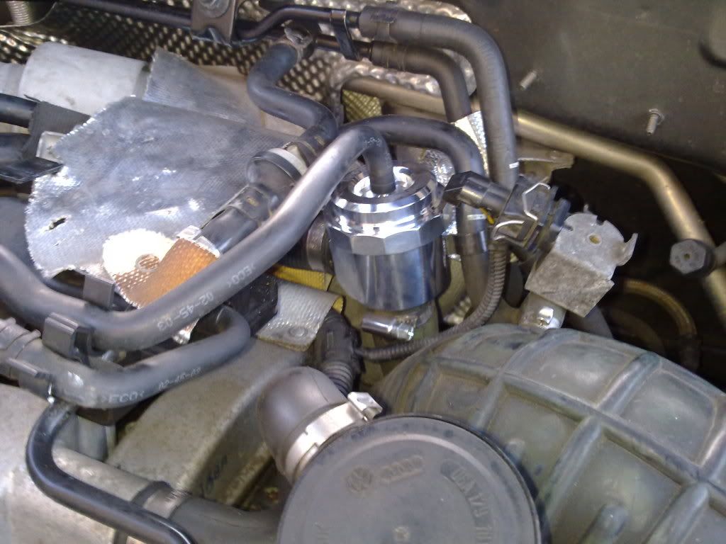

I've got a cable tie on the top for the exact reason Ronin has mentioned.
Been like it for a year and been fine :)

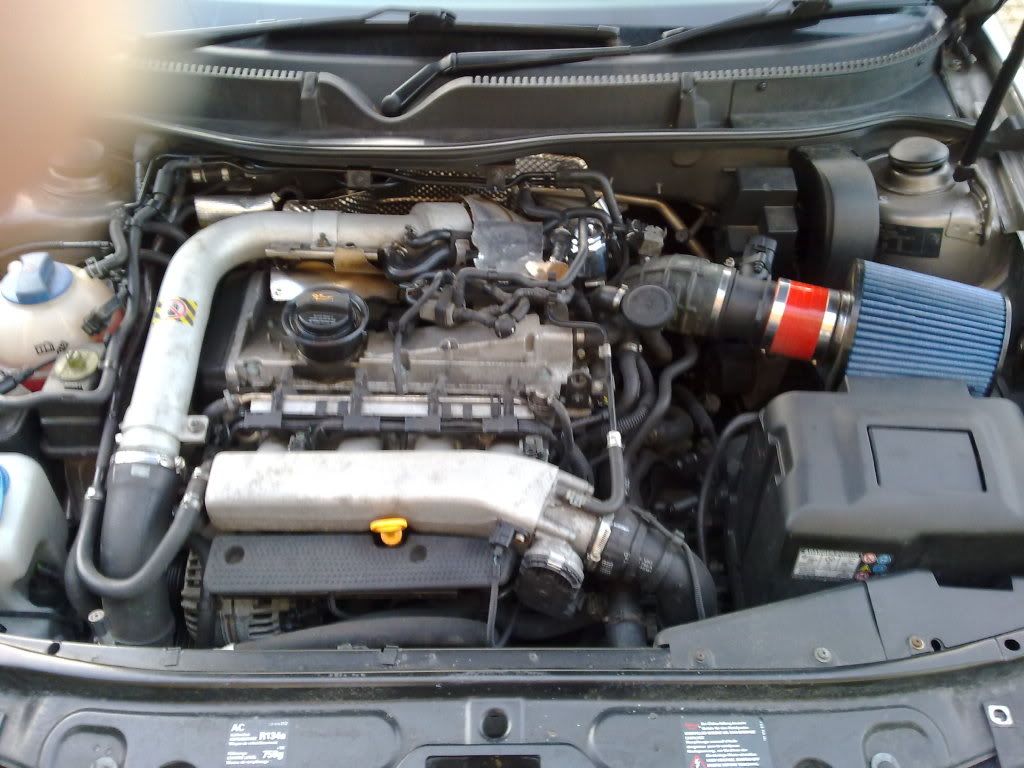

On another note it's not until you see a more oem bay with the standard TIP fitted to realize how big the 3" one really is.
Yeah yeah, stop showing off. One day my time will come :rolleyes: Drive didn't feel or sound any different with the new DV but oh well, it had to be done.

i Would recommend just using a cable tie on the nipple on top
It will give adequate grip without being able to be pulled over the bead
If you do jubilee it be careful as this pipe wont have any ply reinforcement and overtightening will start to cut the pipe
Thats how mine is and it's been fine.
You can do that yes, altho if you have to remove it you'll need to cut the cable tie, which you'll obviously need to do very carefully or risk damaging the hose. Forge DVs need serviced every so often so it's actually a case of when you need to remove it, not if.
Due to the nipple being recessed into the cap even if you get a small jubilee (which i did previously) you clamp on the fatter part and not below
You buy cable ties at pennies so i view them like oil, a consumable, 2 or 3 cable ties over a year is nothing
The OE ear clips work on the same principle - clamp, cut off, replace
