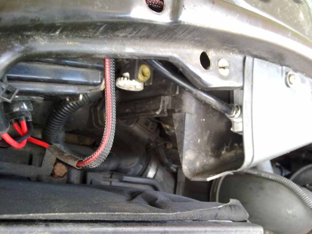

Unclipping, unplugging and removing the original bulb

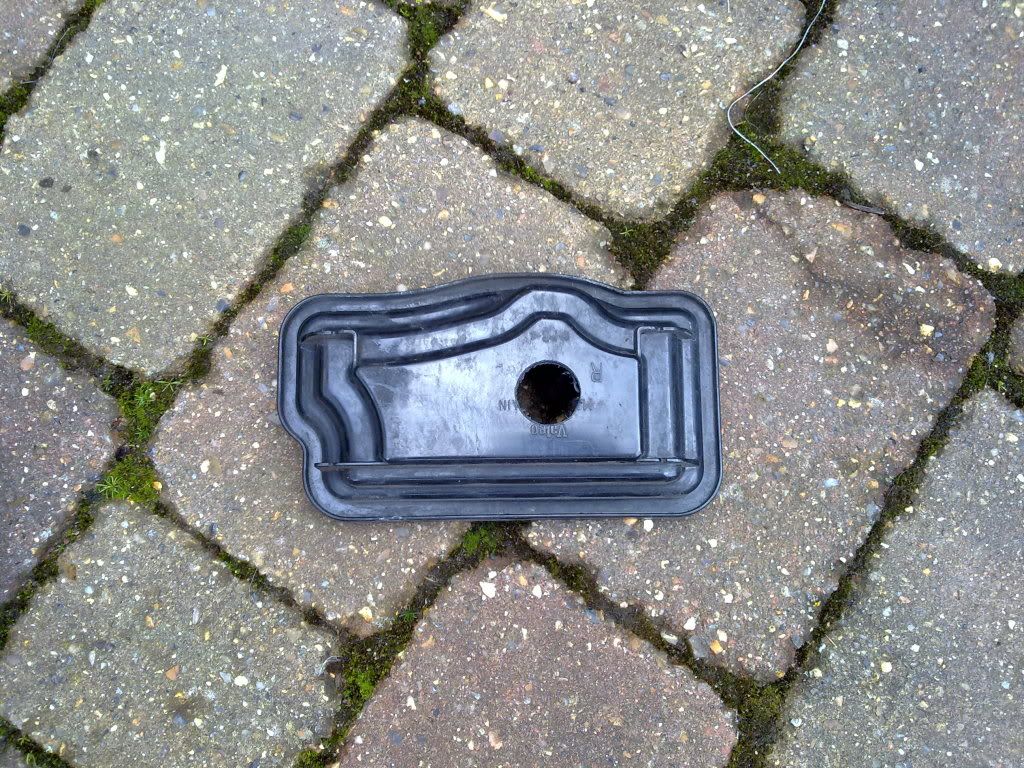

25mm woodbit to make a hole in the back plate for the grommet

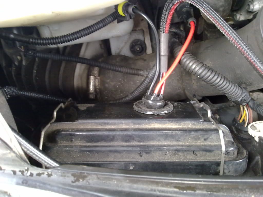

After bulb swap, a bit of jiggery pokery with the bulb clip, connecting the cabling and getting the grommet in place.

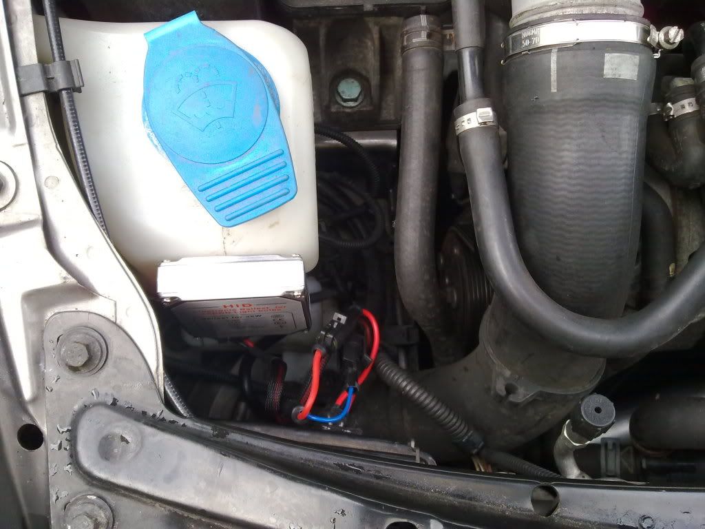

This is where the first ballast is, will get a better fitting some time when I'm not worried about sudden rain.
After doing the same on the passenger side, this is where I left that ballast.

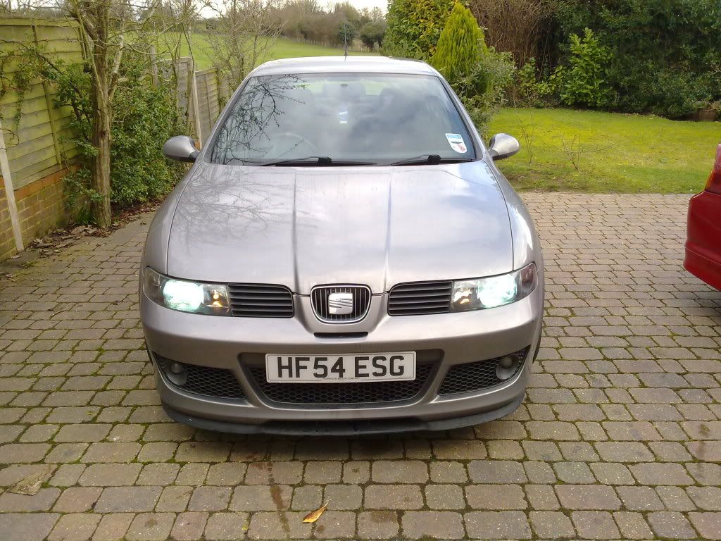

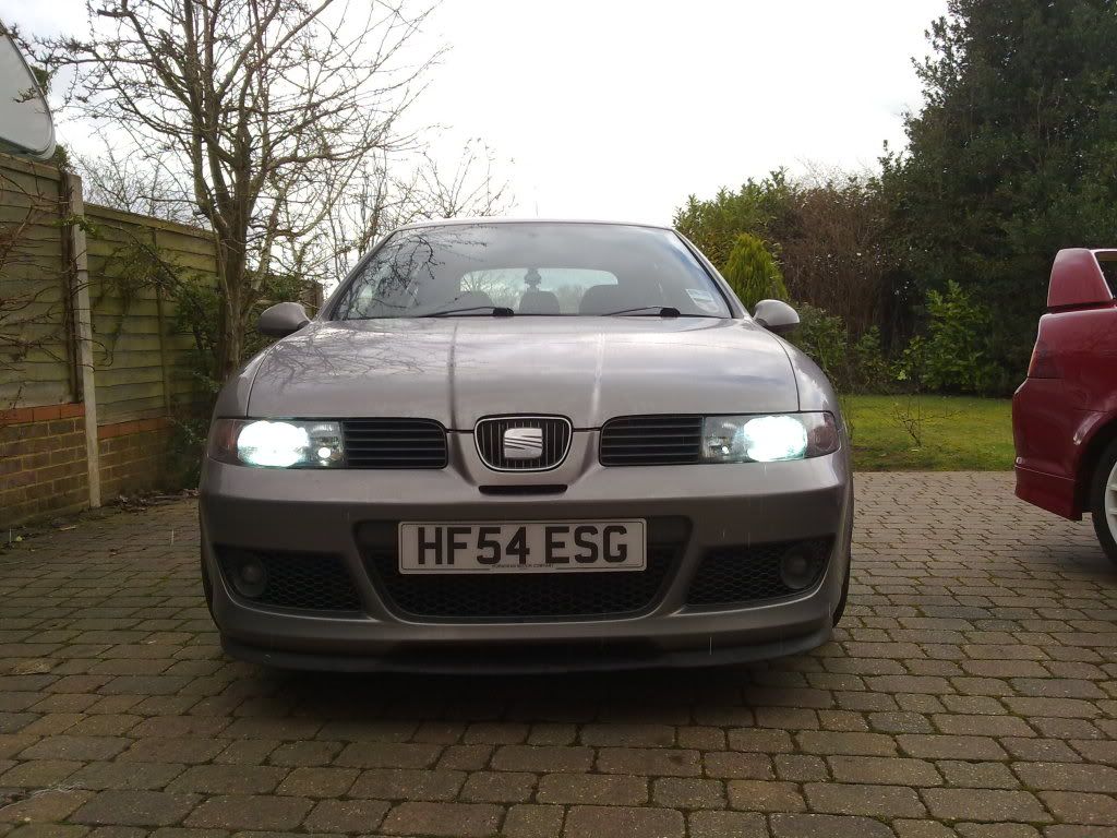

New HID's compared to OEM sidelights
HID's and LED sidelights
Cheers Tom, the sidelights were a pain in the arse with my sausage fingers :lol: They don't seem very bright either? I'll find out for good this evening though. Nice cheap easy mod that looks the part :)
Looks like you have located the passenger side ballast in the cold air ducting??
Much better places than that also will get wet as air/rain mix from grill will be forced in here
Oops, maybe I have. I remember reading someones post on this forum saying there was something 'shelf-like' right by the headlamp on the passenger side and I assumed that was it. Might go and change it now if you're right.
I've just used the sticky pads to put the them on washer bottle and innrerwing. You were right about the cold air ducting, thanks for pointing it out. I haven't got time to spend on it today as it keeps pouring with rain intermittently.

Here is a pic of the lights on at night, both the sidelight and headlight seem brighter on the drivers side :confused: it appears that way while driving it too. I'll have to look at them tomorrow but the difference is amazing, no need for full beams at all. I drove down some unlit country roads tonight and they are so much better than the OEM lights. Lovely colour too :) Pretty sure my old side lights were much brighter though, the ones from this kit are pretty crap to be honest.
Pic is taken from the top of the drive hence the glare.
