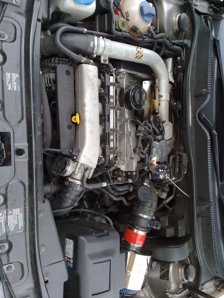

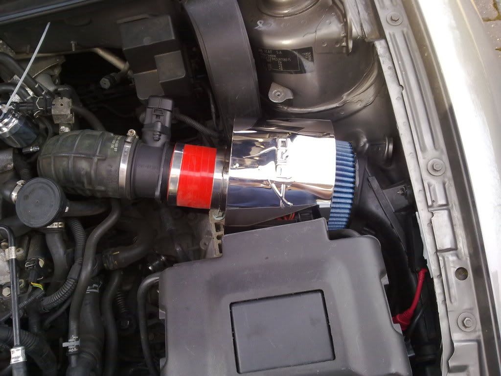

Put my cheap little heatshield on today, thanks to super_electric for showing his off in his RR. Probably get mixed opinions but I think it looks cool and it was mega cheap! Took the sound proofing off the bonnet as well and it sounds much better :D I tried the 007P in reverse, took it for a drive round the roads by my house and it was embarrassing to say the least. Tom you were right it sounds like a very gay bird, people were turning round looking at me like I had something wrong with the car lol. Switched it straight back to normal afterwards. Off to get some new tyres now, will put pics of the heatshield on in a bit.

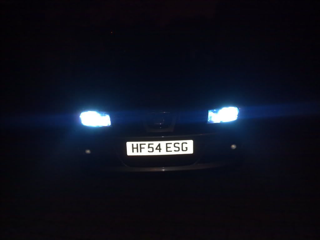

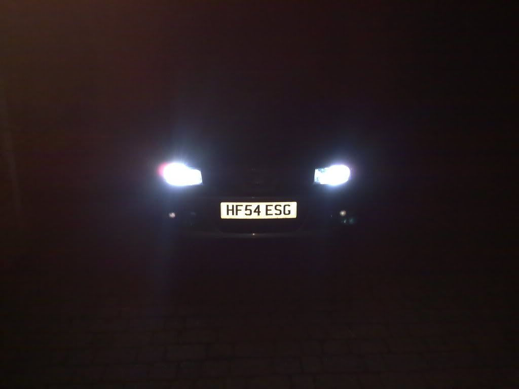

Before - this is with the old set of HID's and the crappy sidelight led's they supplied for free.
After - faulty flickering (and sometimes failing to turn on!) HID's replaced and new 4led sidelights I spotted on another RR from a toledo.
Looks much better. More even beams and brighter sidelights (hard to see in the pic really, but much much brighter when on by themselves. The old led ones were hardly noticeable.
Also worried my apiro heatshield is restricting air flow, performance slightly down since fitting that and the 007P. Need to get a DIY cold air feed in there as soon as I can.
