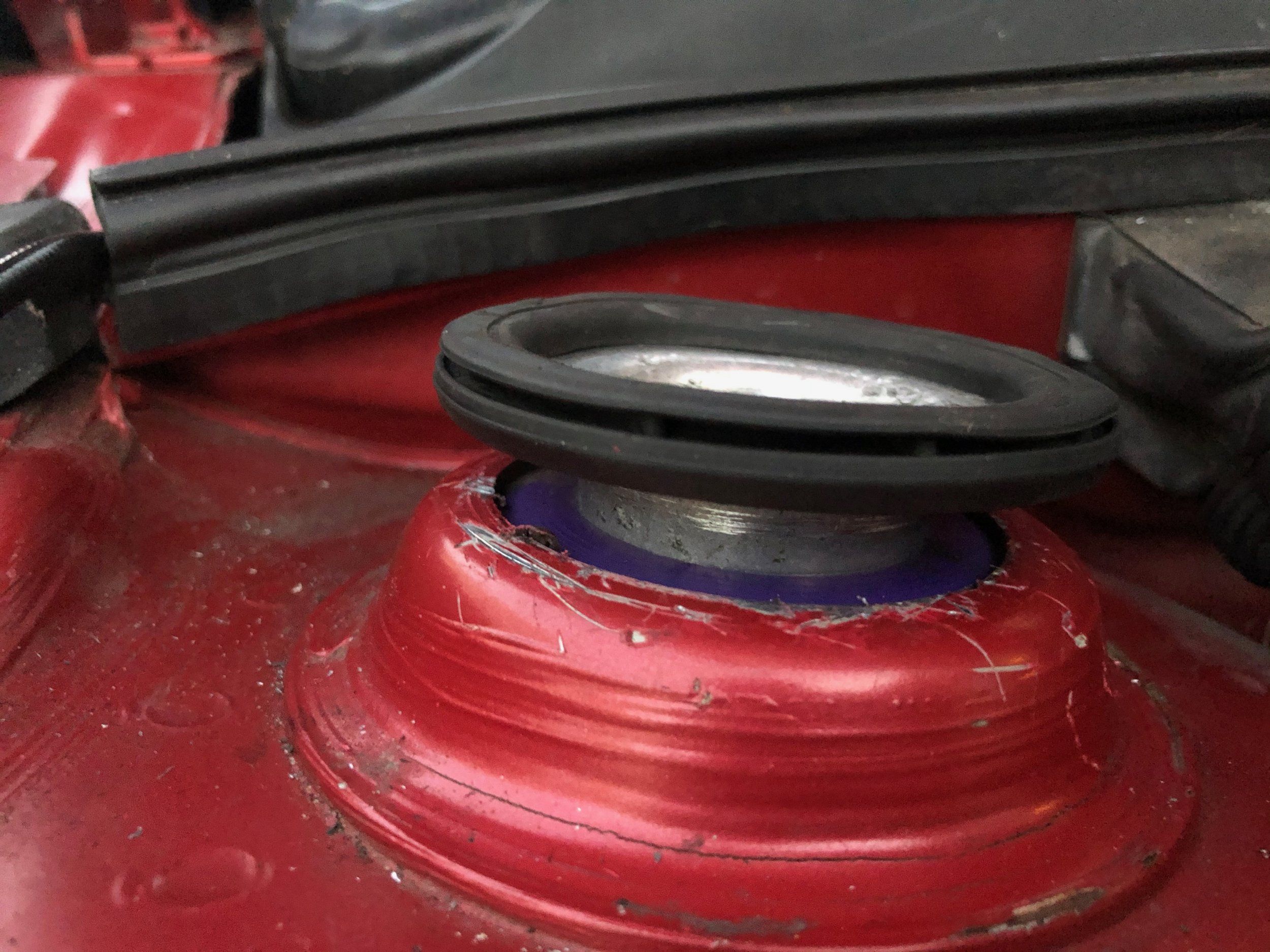

(cupra 180) what have i done wrong here? surely this cant be how they are meant to sit? recently installed Stance+ coilovers and thought id install powerflex top mounts at the same time.. the cup is sitting on top of the bushing rather than inside like i assume its meant to?
thanks for any help and apoligies if this isnt in the right place, first time posting but couldnt find anywhere that solved this!

Haven't done this yet but someone told me you need polo i think cups

I have the same setup amd mine don’t sit like that at all
My cups don’t sit inside the bushes like that on my pflex, (I don’t think?)they are like a flat to flat surface. Then again I have the -10mm ones.
The yellow arrow is to show that there is meant to be a gap between the cup and body, as the cup will swivel slightly as you turn. Recheck you have installed them correctly.
