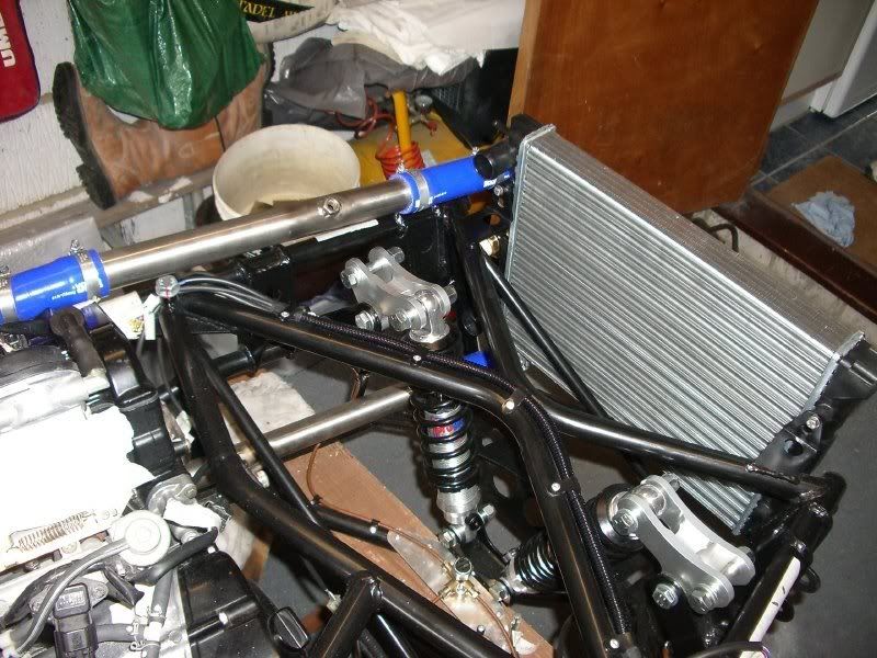

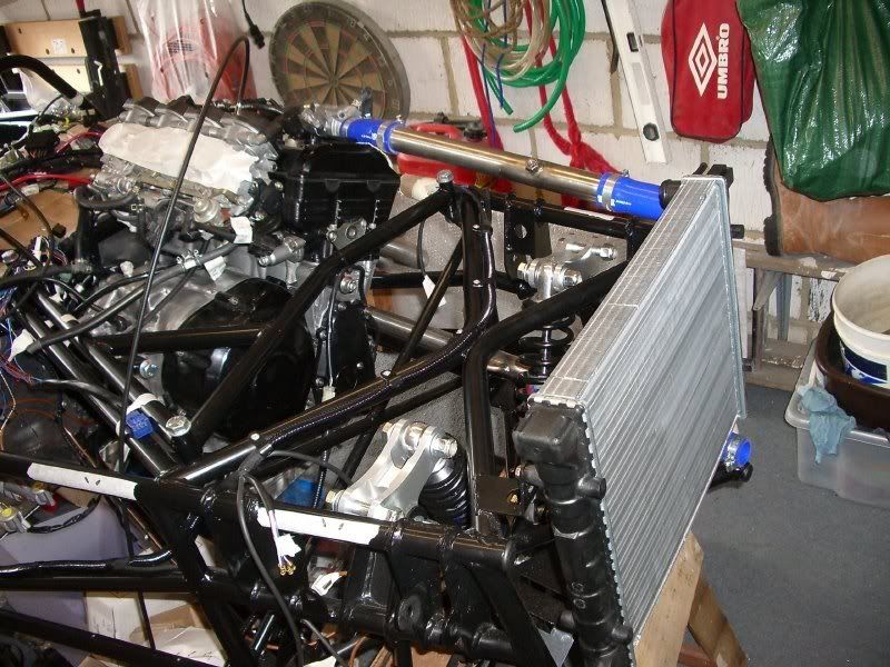

With the engine in i could fit some custom cooling hoses and pipes. There blue silicone but im thinking of going for black at a later date to keep the engine install very OEM looking plus its too expensive to replace all the original R1 hoses:D. Theres a welded nut on the top hose ready for a 1/8npt temp sensor that il fit once ive selected and bought the right gauge. The radiator has two middle locating lugs pre installed to the chassis to hang the radiator and ive tapped through the top of the radiator casing to secure it with a bolt to the top of the chassis.

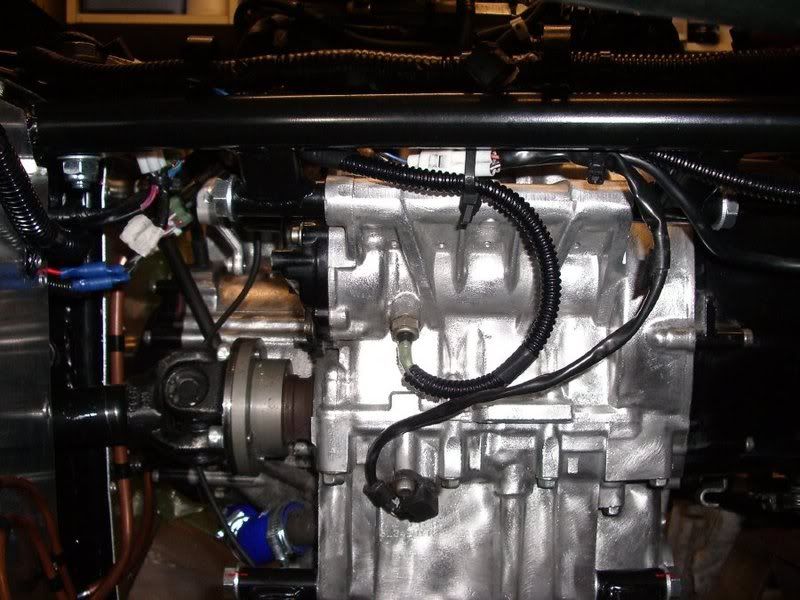

Once we made all the necessary connections, removed unecessary components and loads of other bits we started tidying up the left over mess. Its been p clipped to the chassis and covered in convulated tubing that i've borrowed from work:)

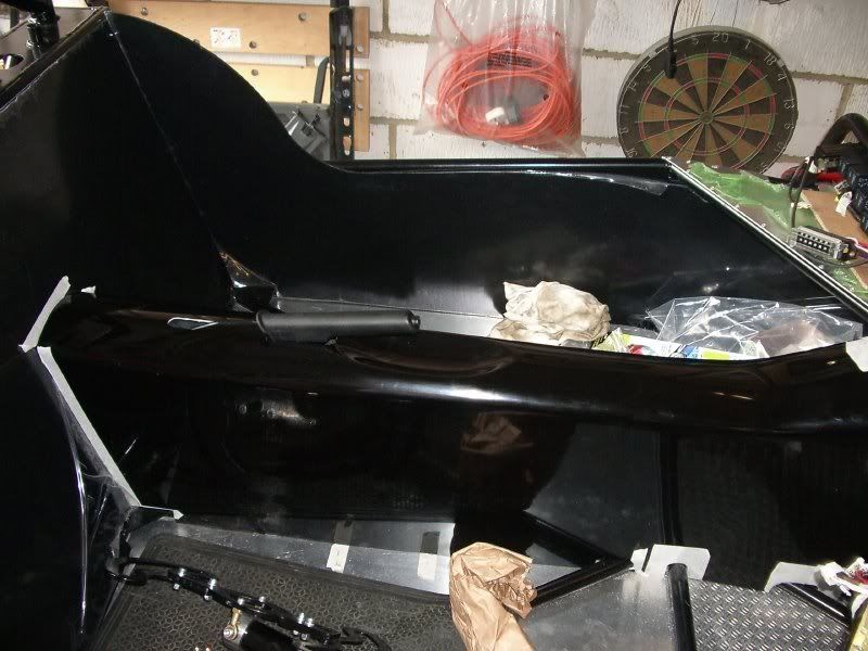

To finish off the interior panels we have a GRP gloss black tunnel cover. Its taken a lot of work to get it to fit as it has to be a tight fit on the sloping back panel so minimal amounts were trimmed off at a time. Once trimmed we mounted the handbrake although we still need a gaitor for it.

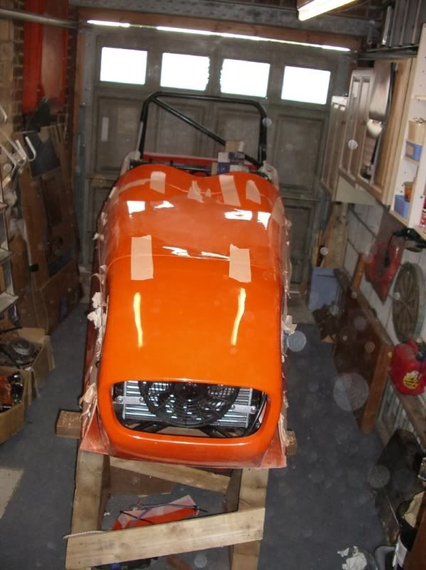

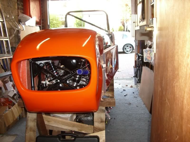

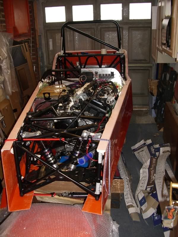

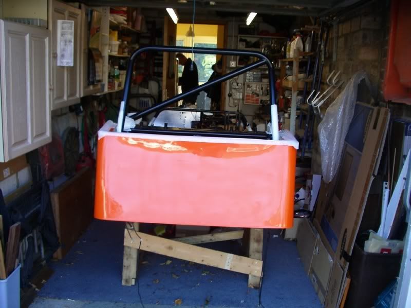

Hi, Finally got to a stage where we can get the body on. the body comes as a 5 piece kit - the main tub, scuttle, bonnet, nose cone and wings/arches. First to fit is the tub. Its all the right shape but getting it to fit is something else. On the day we started i think it came off then on again about 20 times trimming it very slightly each time then finding it would rub somewhere else. Sounds like an easy job but really is time consuming with files, dremmels, hole saws and drilling. After a weekend it was looking like this;

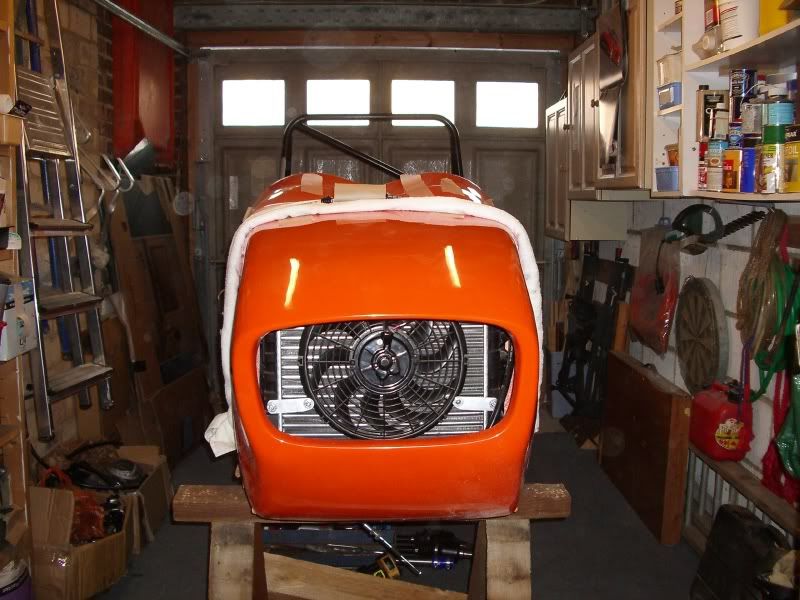

We had a little play with the rest of the body parts and the scuttle and nose will also need a lot of trimming. Heres a teaser of how the front will look. Notice the R feeling sorry for itself in the background :)
Its not all physically bolted down yet as there was still holds needed to be made for the suspension steering and exhaust. We also need to bolt it to the chassis and were not at the stage yet to do that as its comming off again to finish little electrical bits and the final engine plumbing etc.

Hello, been a while so thought id add an update. Done loads lately in the ice cold garage but not really much worth taking pictures of like the assembled exhausts, complete wiring, gear change brackets, brake resevoir, coolant tank, hooters :p, silicone water hoses, fuel pipes and filters, battery bracket and wiring, cut off switch and probably some more. Heres of few pictures of other stuff though.

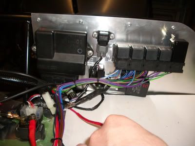

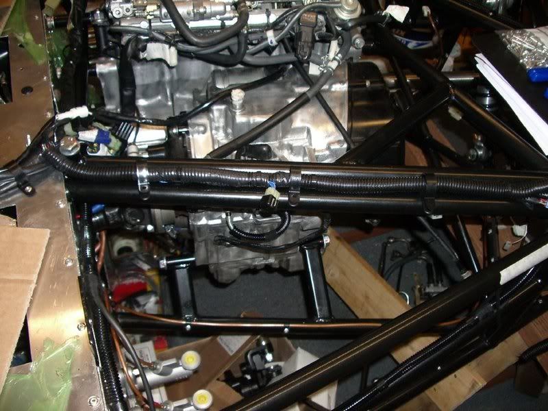

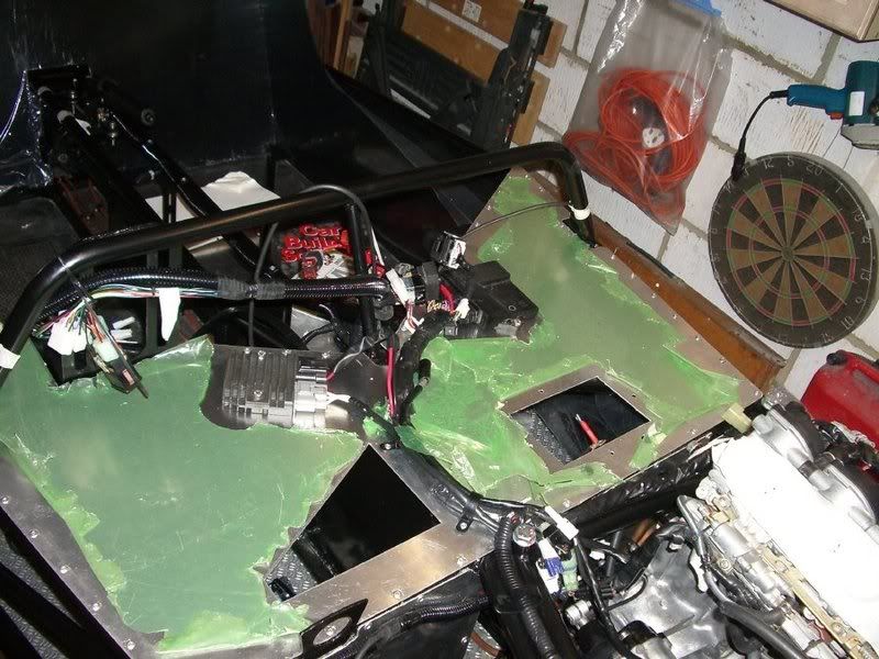

Mounted all the R1 wiring mess to the steering column support rail

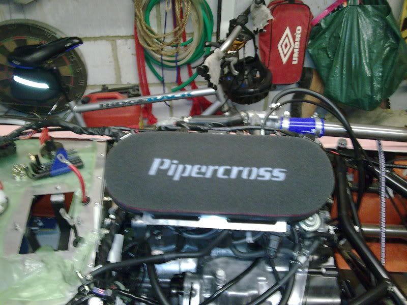

After waiting weeks for some R1 air cleaners we ended up getting some for free and i dont even know who from :). This allowed me to fit the air filter base plate and attach the pipercross sausage filter.

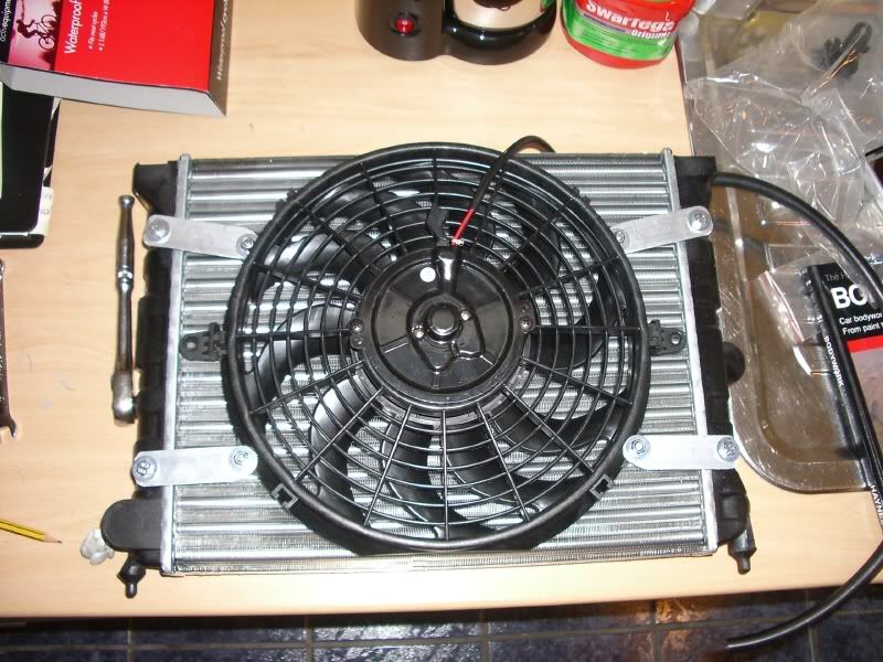

Tapped the core support to mount the rad fan - bit of a scary moment as too deep and you need a new radiator:blink: heres hoping it doesnt leak

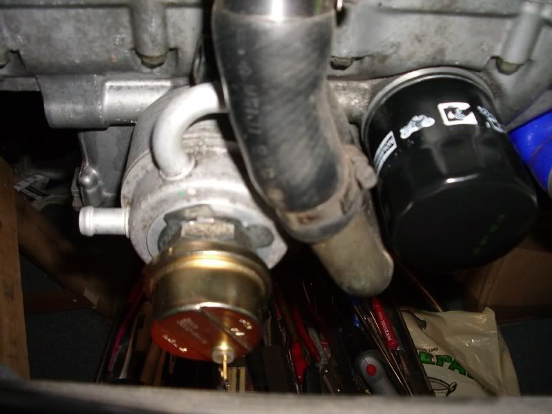

The even more scary tapped the oil cooler for the oil pressure gauge to help us avoid meltdown when on the track. Damn American sender meant we needed imperial tappered tap's![:@] Also fitted a new filter with some fresh oil.

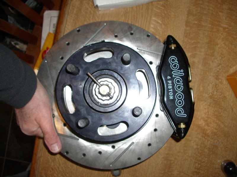

I was bored one evening so I assembled the small265mm's (compared to the LCR) discs, uprights, wiklwood 4 pot calipers and alluminium hubs.

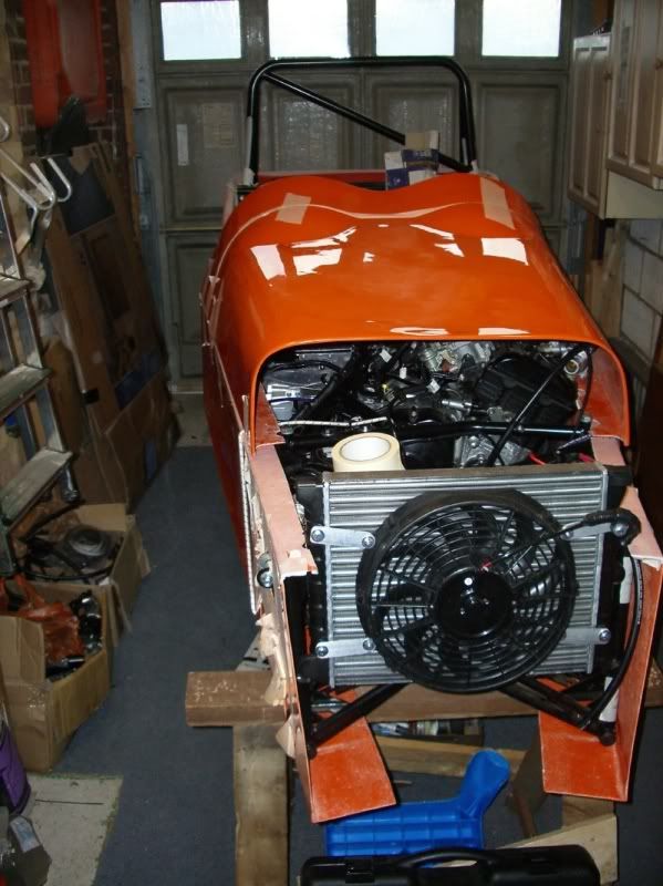

Before finally fitting the tub we checked the scuttle, bonnet and nose cone for fitment
All together
Held down while we made the holes in the tub using steel rivnuts and M5's with 2p washers

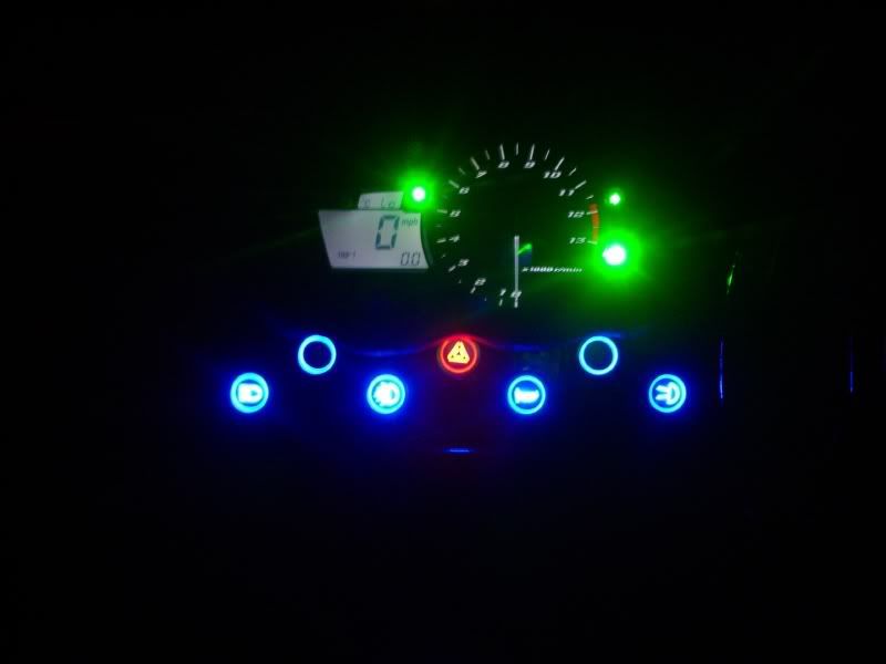

After loads of messing round with the wiring i soon realised the original loom has been completely butchered but well hidden as i thought it looked original. Looks as if it had a alarm installed or removed as all the wires are black which is fun to work out whats what. Other wires do no where, some just fell out and the others i aint got a clue. After all saturday and bit of sunday morning i was happy with what id chopped out, resoldered and bypassed so i thought id try and start the thing with fire extinguisher at hand :D
http://uk.youtube.com/watch?v=4jMFXMvojOE (you tube link)
Amazing feeling getting over that as your never sure if a used engine left standing for that long will work. As for the start I think my dad blipped the throttle to 4k and its got something like a 7k to go upto the 11k limiter so should sound really good :p . From looking at the clocks we think the bike has only done 2,400 miles as the clocks are original and match up with the other engine numbers so hopefully many happy years of track abuse
