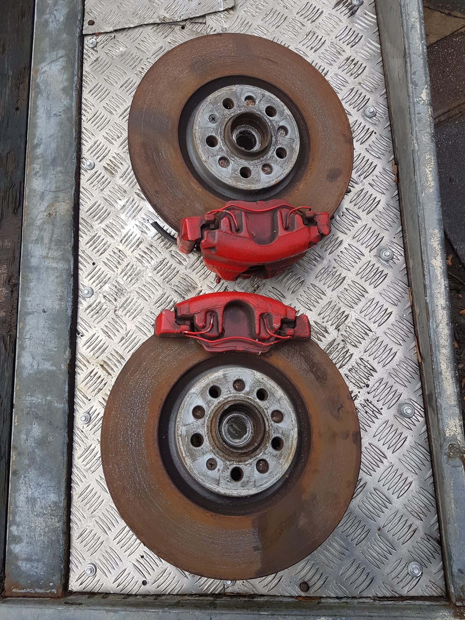

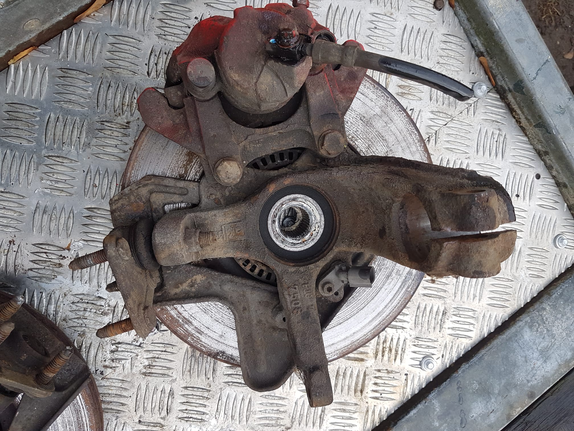

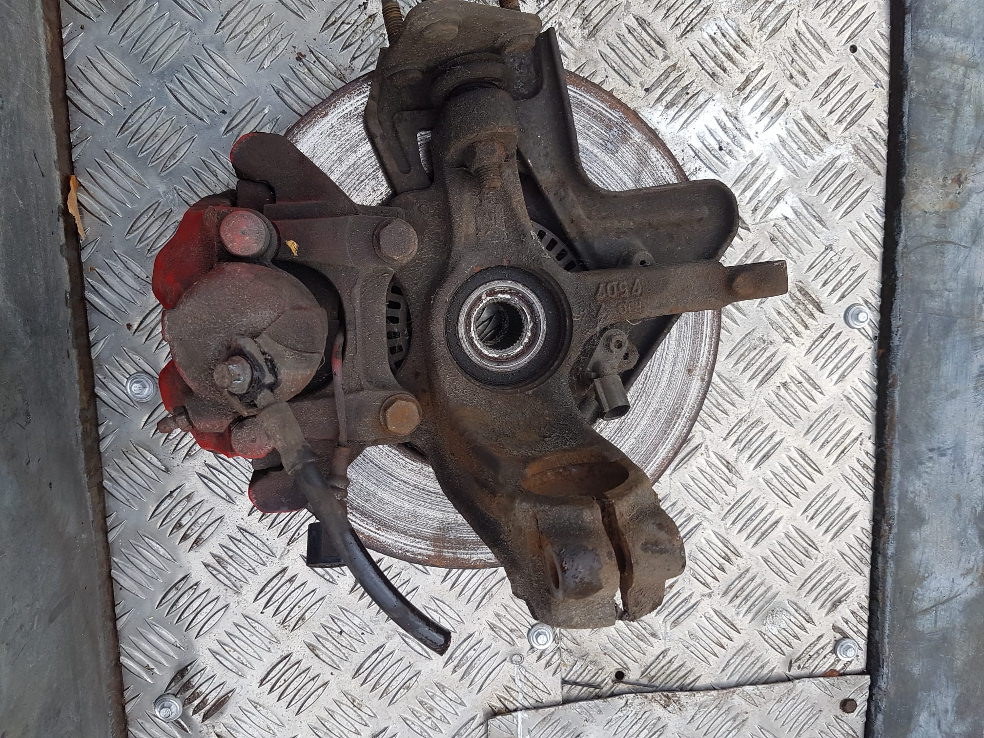

Here are pictures of my front TT hubs
Ok they're clearly from an earlier TT as they have the recess for the 30mm bi-hex nuts.
They'll fit your PD150 driveshafts.
Sent from my SM-G986B using Tapatalk
