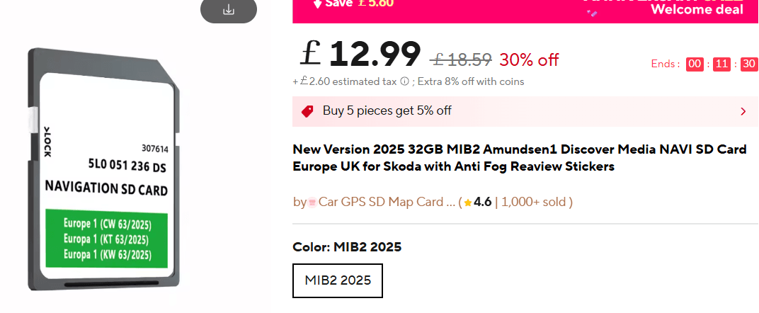

Thank you sooo much, I will look at it.
Can I use any mib 2 card to update my mib 1 maps or does it have to be specific?
eg

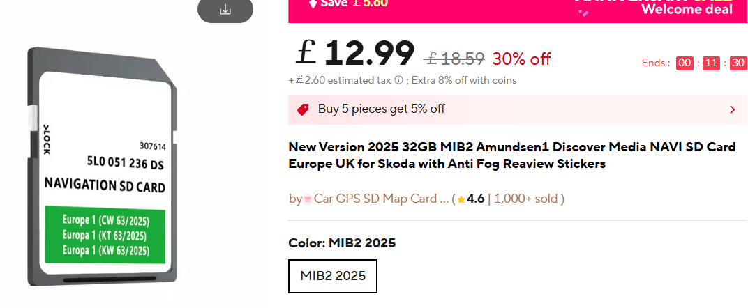

eg View attachment 47551
It should be OK. The CID on mib2 cards is fine for mib1. So yes. Europe 1 means it's a 16gb card... that's the zone Europe 1 in mib2 form. Mib1 cards are 8gb... the maps expand to need 16gb or you have to hack them. Mib2 that expanded to 32gb cards but packaged into zones.
Why I recommend keeping your existing card intact as a back up and using the 16 or 32 gb card as a new one. When you switch map cards in the units you do need to hold the on / off button for a few seconds to force a reboot else the unit holds the parameters read off the old card if the card swap is shorter than 20 minutes.
Ps note I did an edit to the post you replied to... mib1 used 8gb cards... 2023 maps in mib1 need a 16 or 32 gb mib2 card to use for the CID or you hack down the 2023 maps to fit. Getting last when I typed that.
