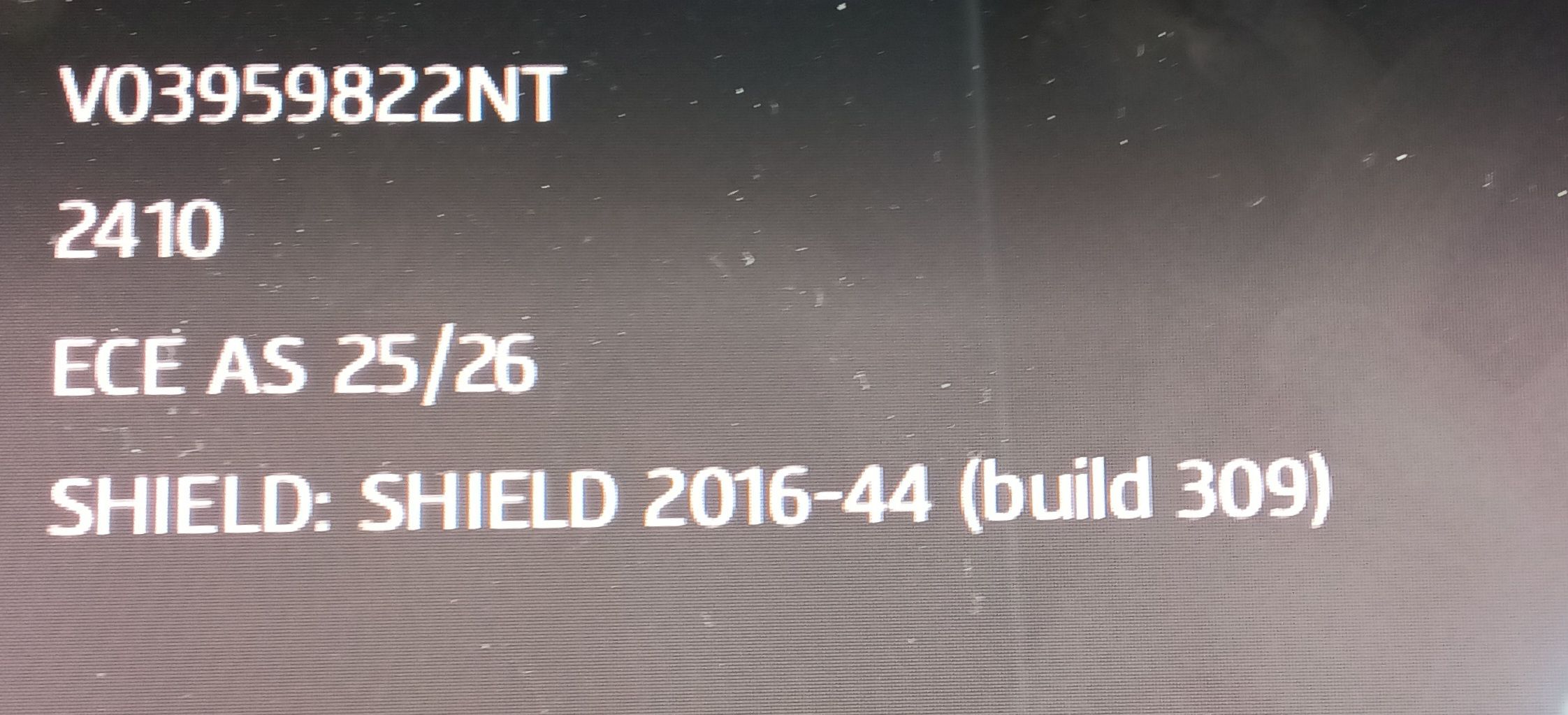

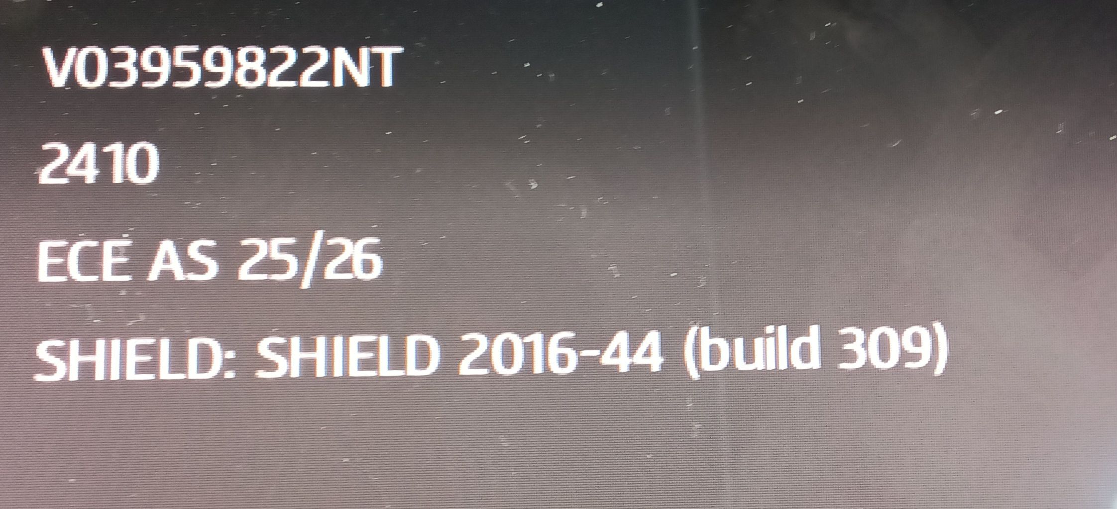

& the normal success picture on the the all European map but you have to use the workaround as covered. We await the professional file sniffers for the RoW files.
