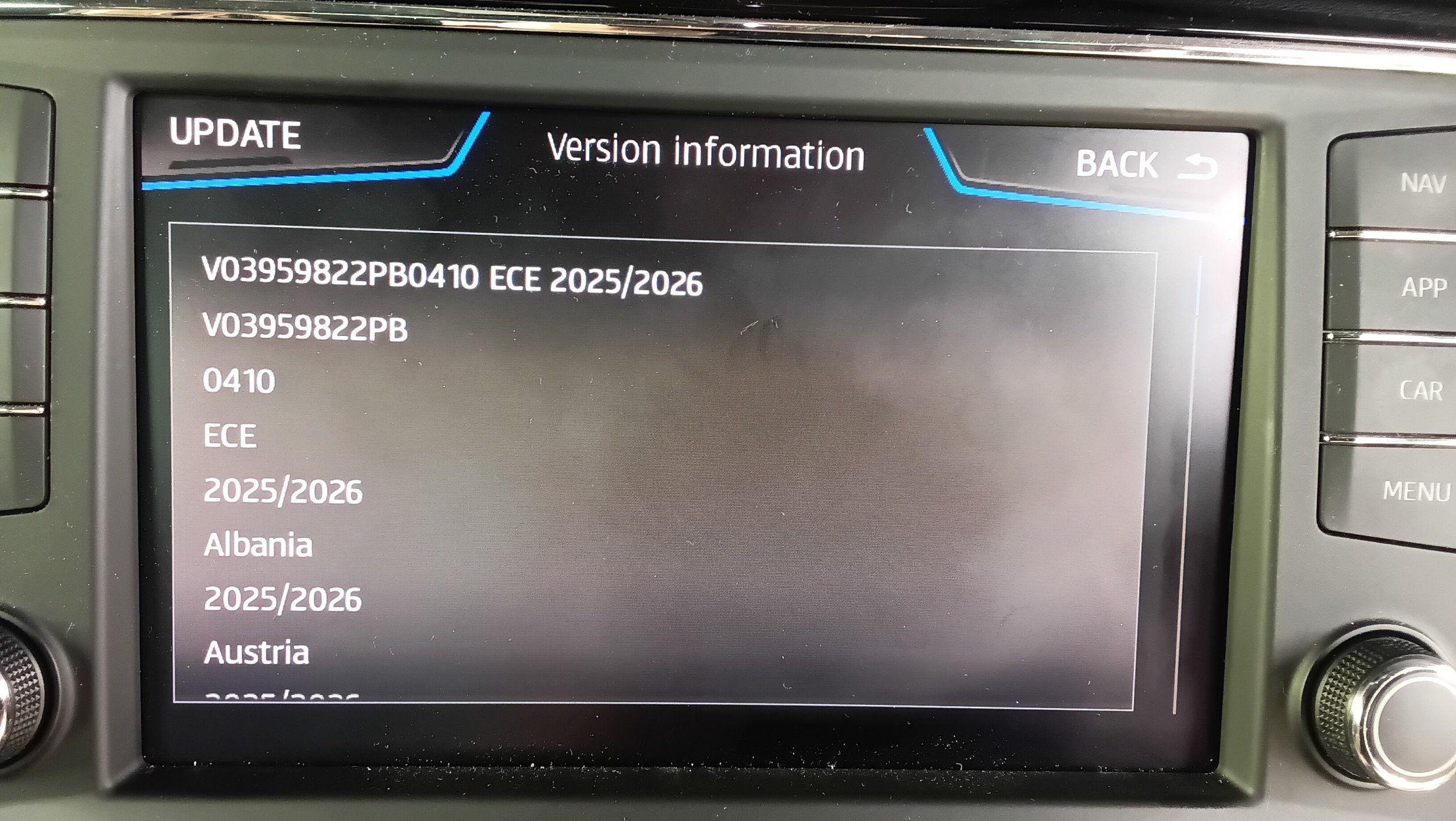

410 Success screen:

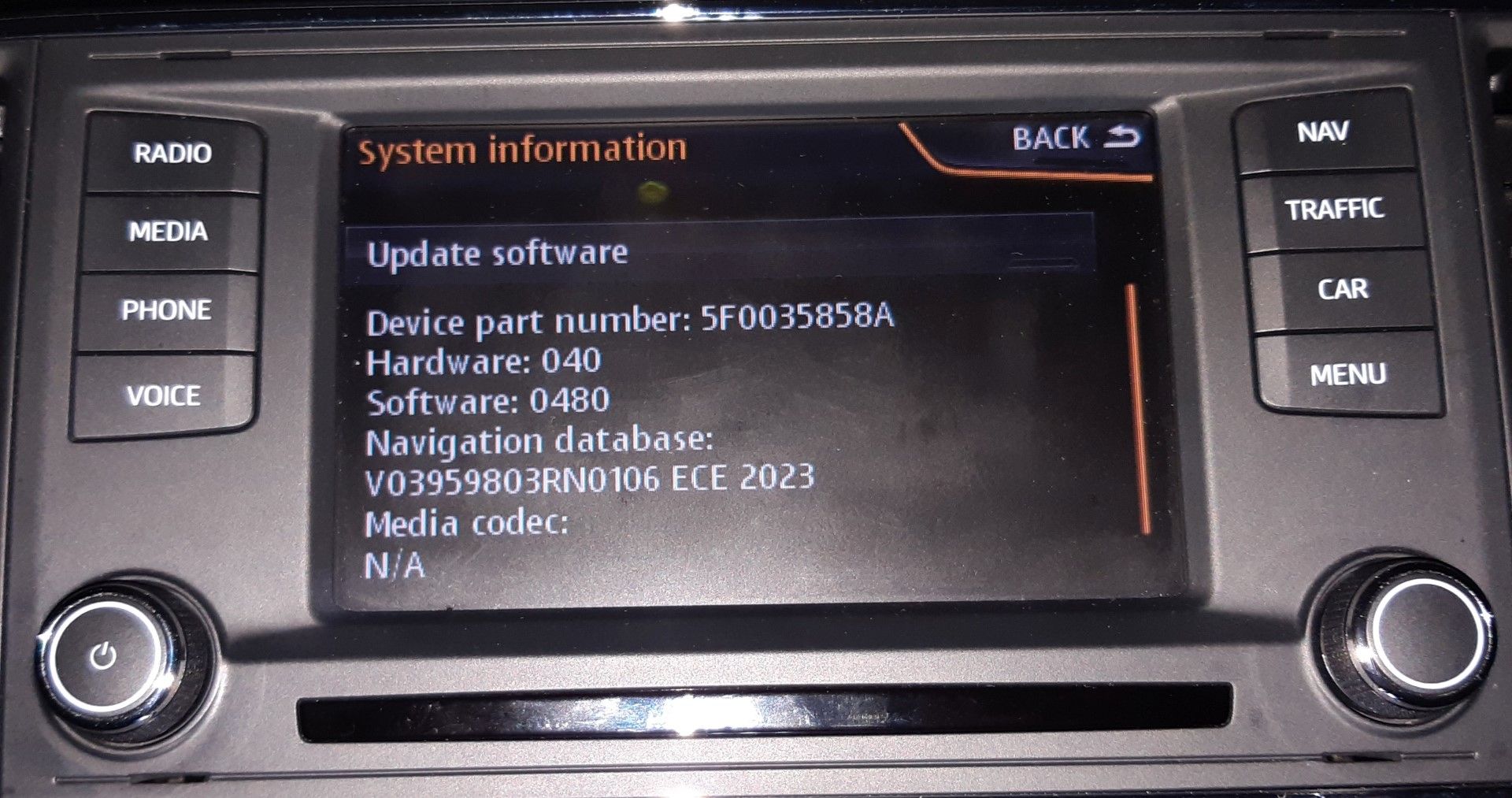

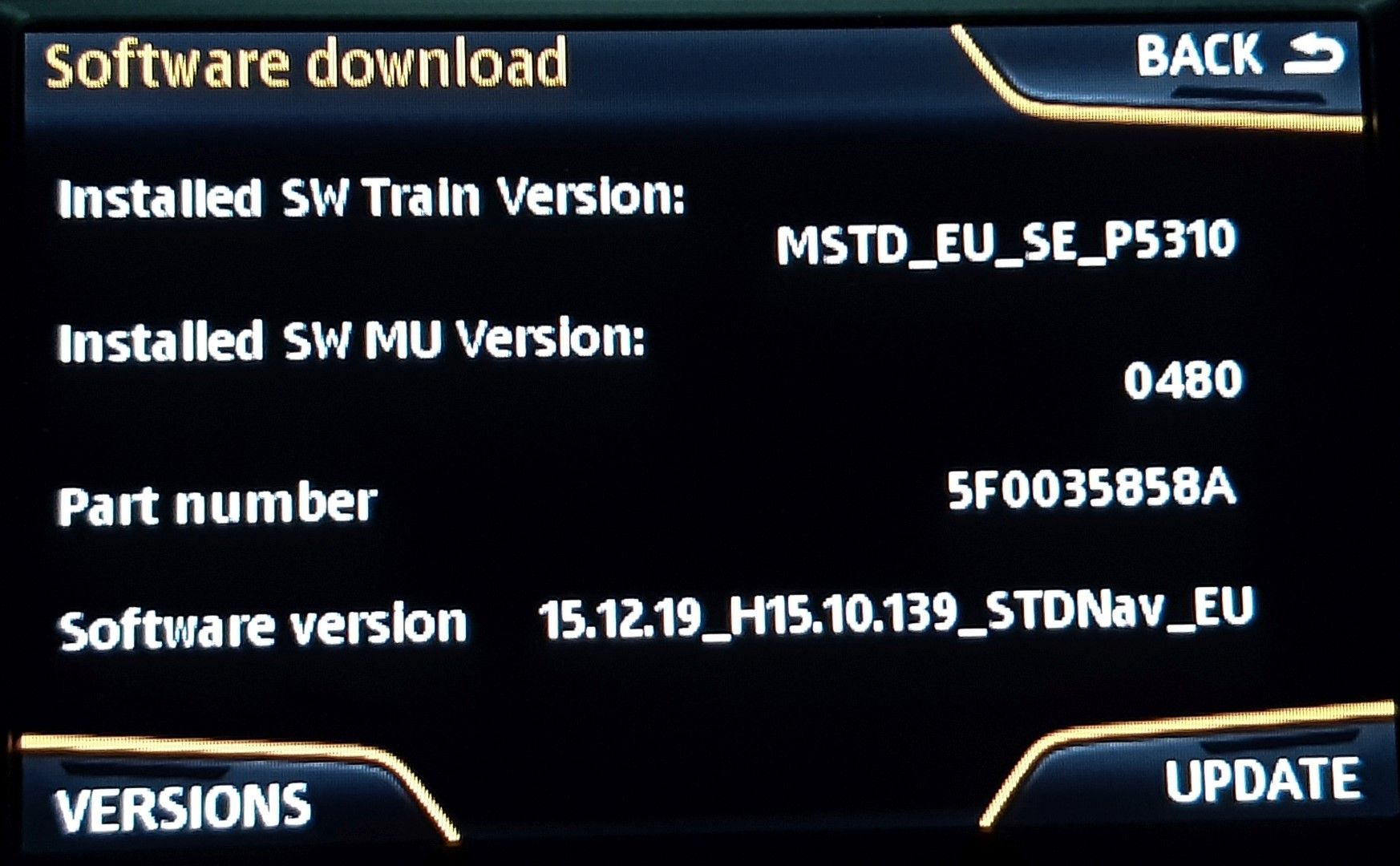

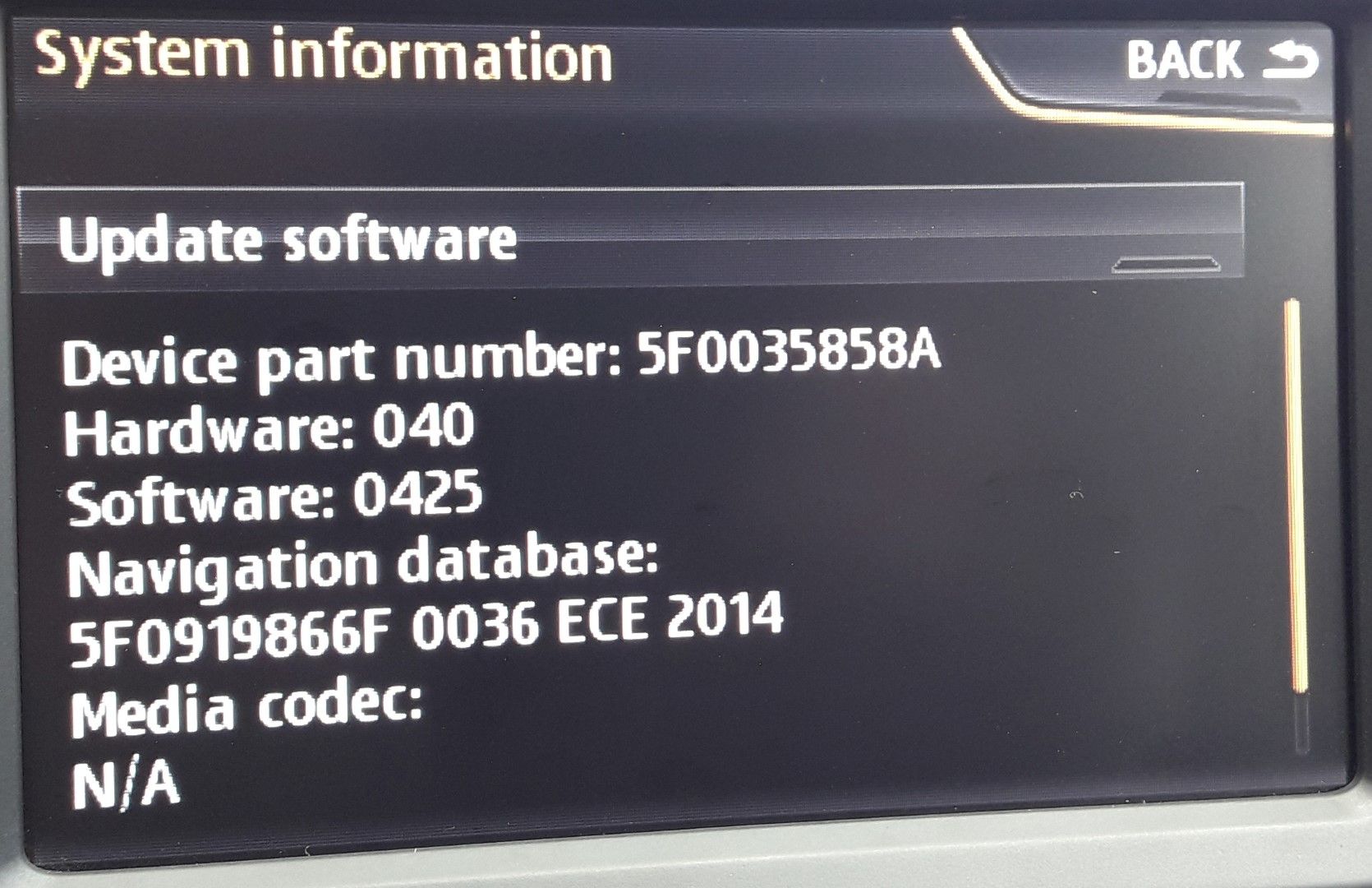

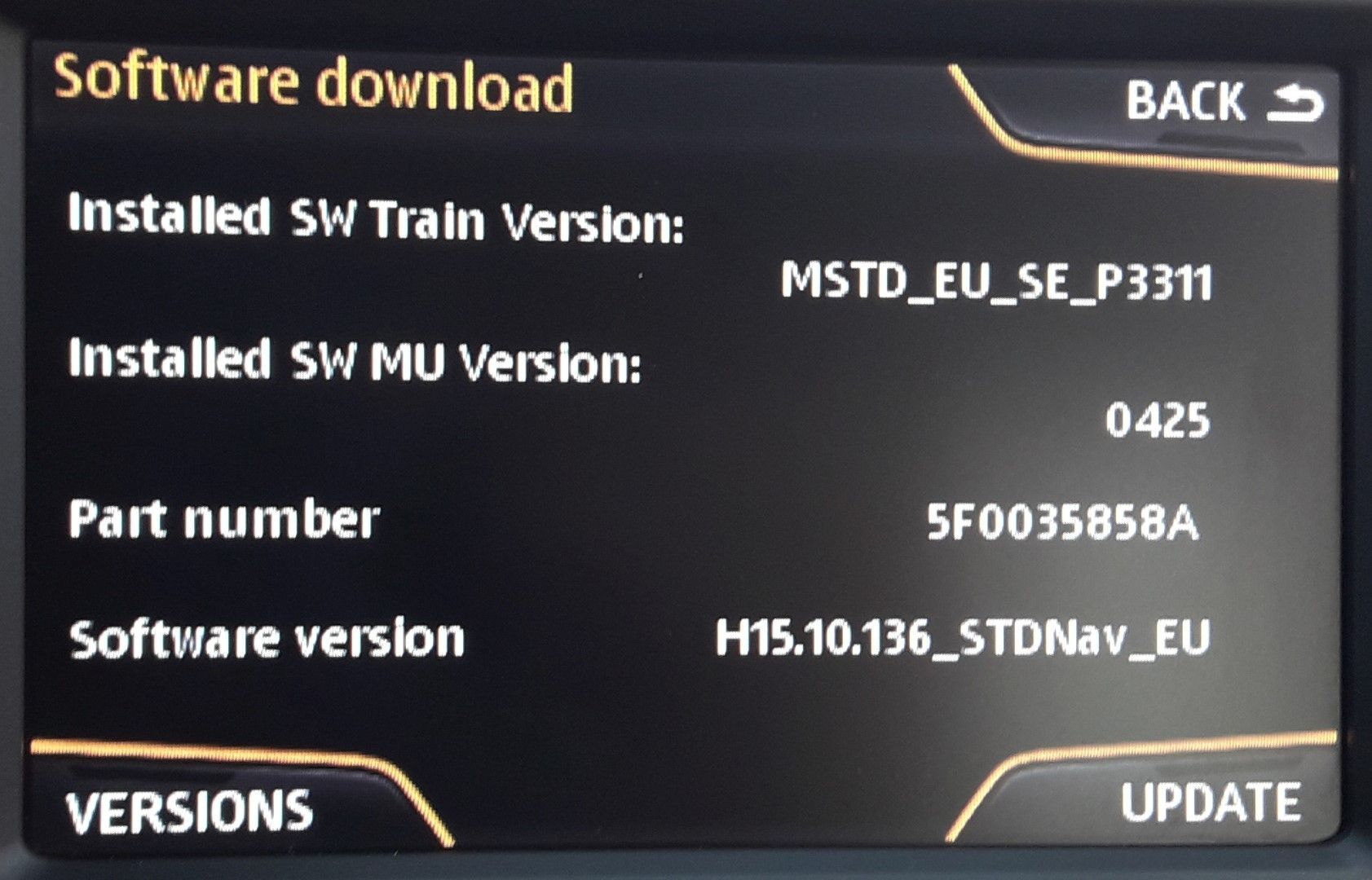

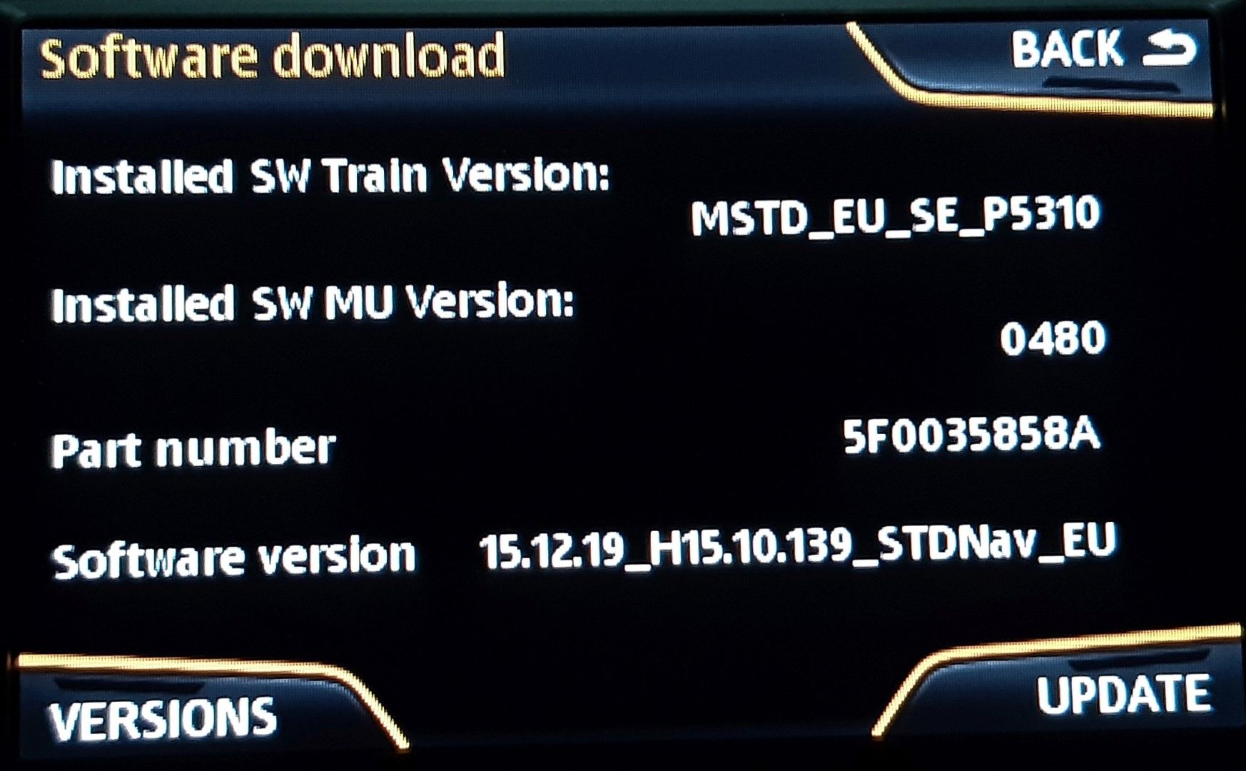

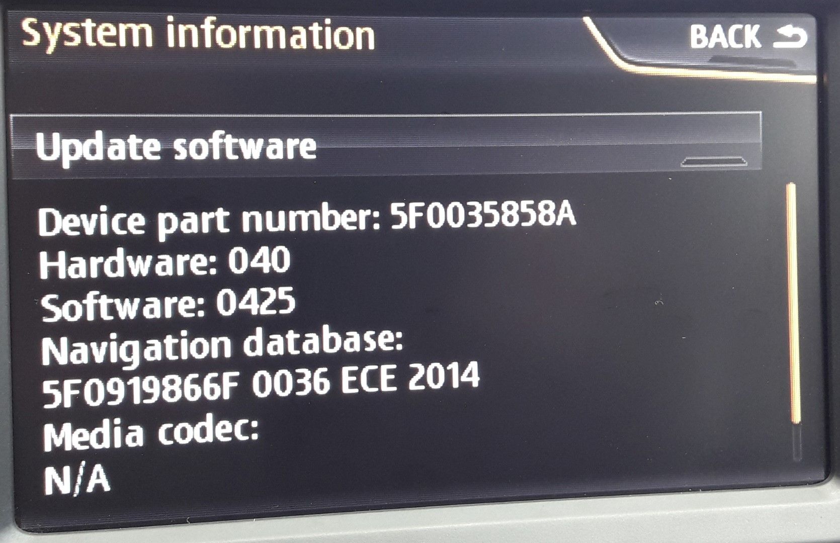

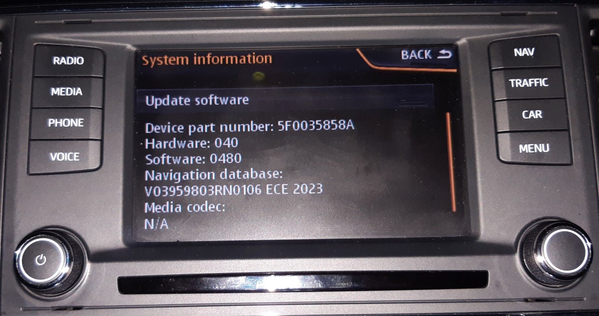

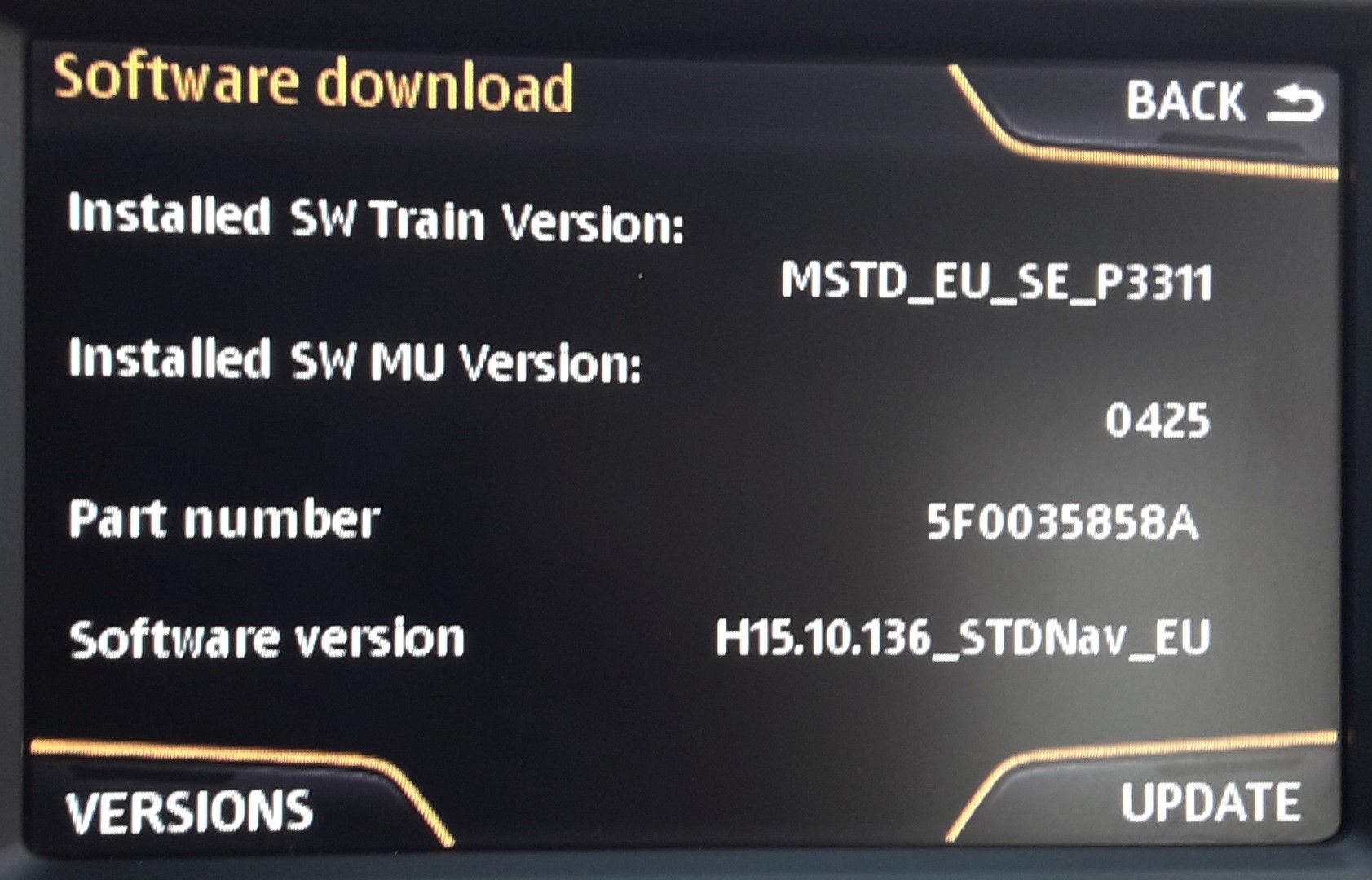

I managed to update our MIB1 Standard from 2014 maps to 2023 :cool: I found some info on a German forum. Here's what I did:
You might need to update your MIB1 to the latest firmware for it to work, I did it a couple of years ago. mib1_5F_480.rar [1.95 GB] (Spanish forum? I still have a Mega URL).
Backup original map SD to PC. [SEAT Navigation AT Europe (V4) 5F0.919.866.F] [4.46GB used of 7.48 GB]
Delete files on SD, probably best not to format it.
Download new map files, unzip on computer. P106_N60S3MIBS2_EU_NT (8V0060866S).7z [6.54 GB, 7.53GB EXPANDED ON PC] (mibsolution.one > Maps > MSTD)
Remove some files so it fits your SD, more than you expect due to cluster size? (Turkey, Ukraine etc). I ran out whilst copying, but I freed up 400 MB (just in case being completely full breaks the Sat Nav).
Change the following in the new DBInfo.txt (I didn't test if you could skip this step):
PartNumber1="V03959803RQ"
PartNumber="V03959803RQ"
TO
PartNumber1="V03959803RN"
PartNumber="V03959803RN"
Copy all to original SD.View attachment 40652View attachment 40653View attachment 40654View attachment 40655View attachment 40656
