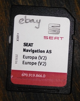

This is the card I bought and use:

I have the exact same card bought from eBay for £10 delivered when I thought I could just copy the update to it, never used because I updated my original card, maybe I should give it a try, nothing to lose?
Yeah, it would be nice to confirm that I'm not just going mad and getting confused with cards and versions.
Just plug it in as is, it should just work, but with it's older version of the maps
I assumed that Steves second card still worked with the unit. You'd have to revert your old card back Jim to be on the safe side if you still have the back up.
This might be how the guys three or more months ago got in a pickle. I know some people got frustrated with him as to why he just didn't do the standard work around.
The unit will have the new card CID stored in it, perhaps it can hold the Id's of two cards or passes that one on... I pass.
