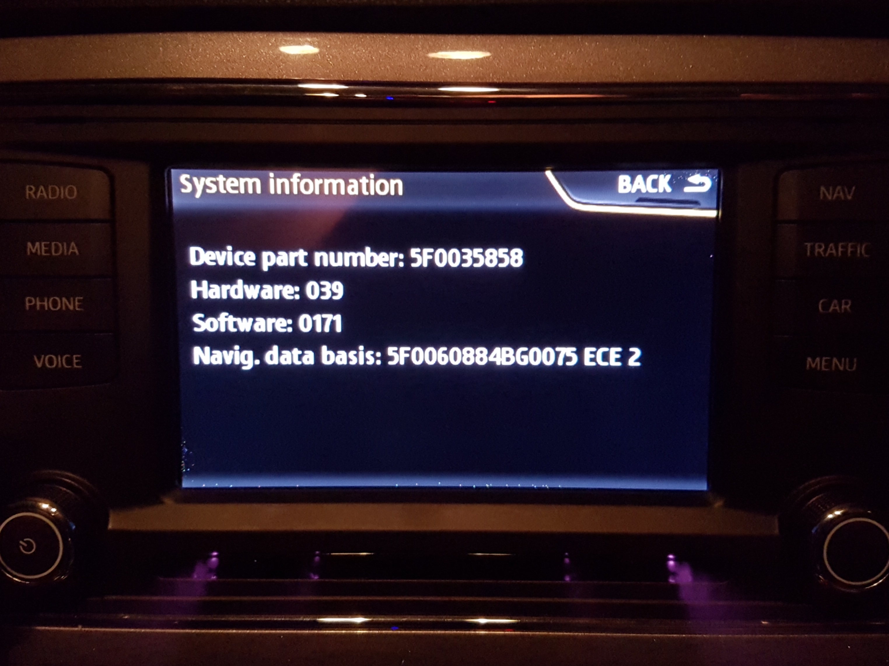

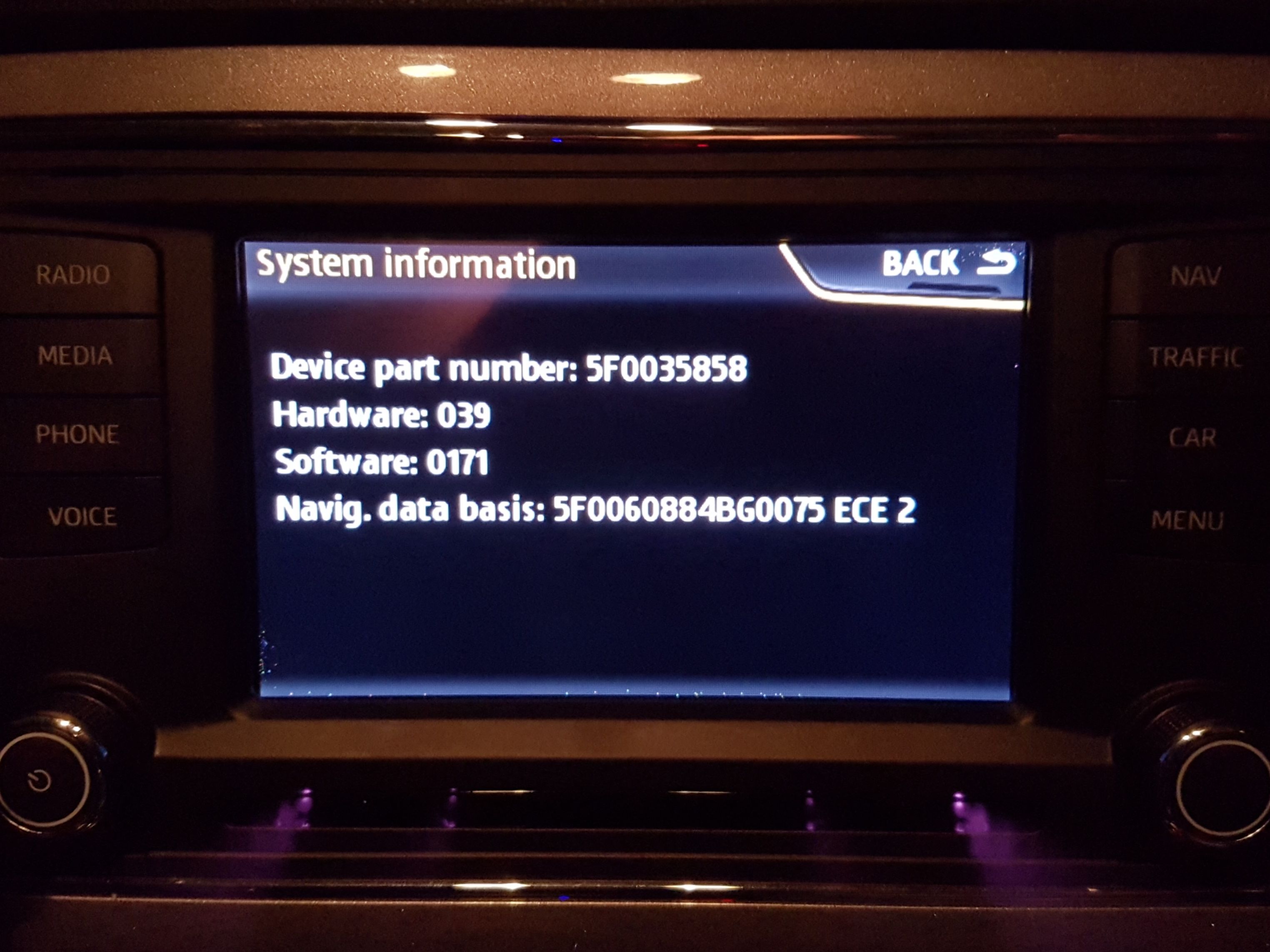

Hi All,
Please forgive me my ignorance but i have spend few hours going through the post but now I think I am stupid.
I have tried to update my satnav data as per instructions.
I do have a 2018 Leon with High system (photo attached). Downloaded file as per seat web with new maps.
As per Tell post #1423 (love statement that thread is convoluted but simple) using 7zip all files were extracted into the FAT32 sd card.
Card was locked and loaded into the car.
Message was shown that update is available.
And now the tricky bit. It doesn't matter do I use slot 1 or 2 and do I use Navigation - >settings->information or vehicle - >system information when I pres for update system start searching for updates and ends up with error that no updates has been found.
All pictures attached.
Do I need anything extra or doing something wrong?
Thanks,
Bart
Sent from my VTR-L09 using Tapatalk

The nav high unit can't be updated by the user without Mapcare unless you have the unit 'modified'.
Reactions: Tell and Bart300

Have you paid for Map Care update services?
Thanks,
Looks like this solve the problem.
When I purchased the car this option was not proposed to me.
So the simple answer is: No.
I will have to start reading the thread again about Map Care modifications:stars:
