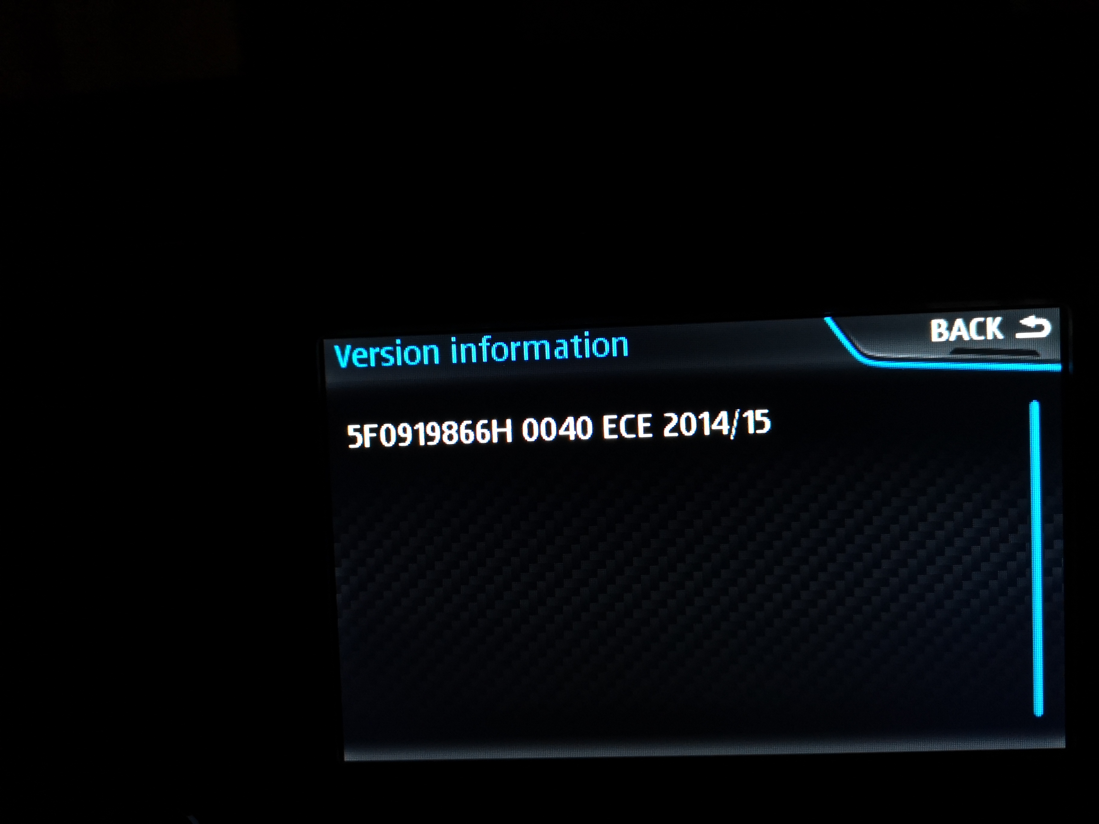

This is what I have.
So why did seat tell me I'd be OK with mib2 v6 map sd card? They also mentioned v13 gb maps
Well the version 13 would be this which is a mib1.
https://www.amazon.de/Seat-Navigationsdaten-Mediensystem-Standard-Europa/dp/B07HJBR97T
We know your unit is a mib1.

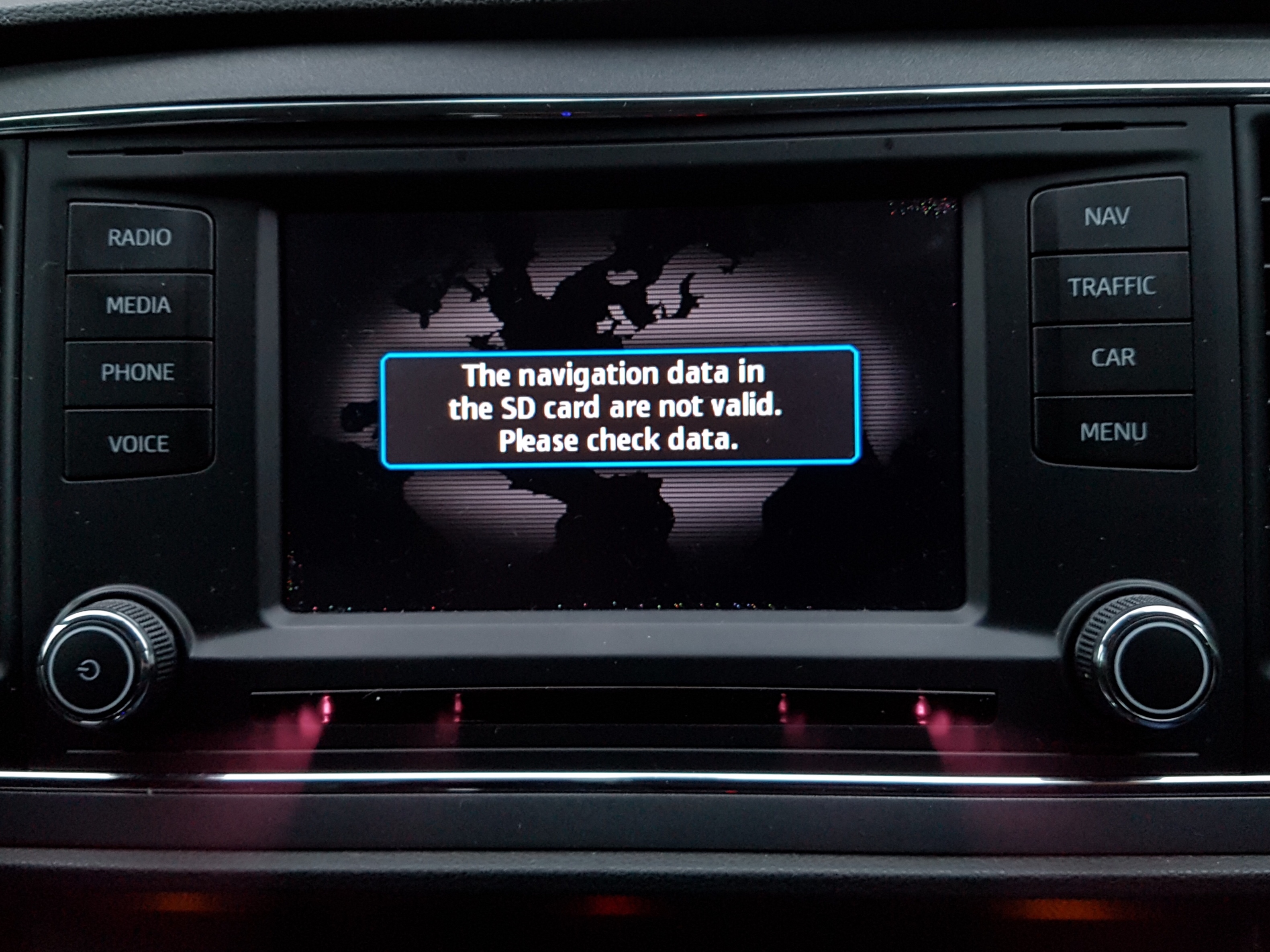

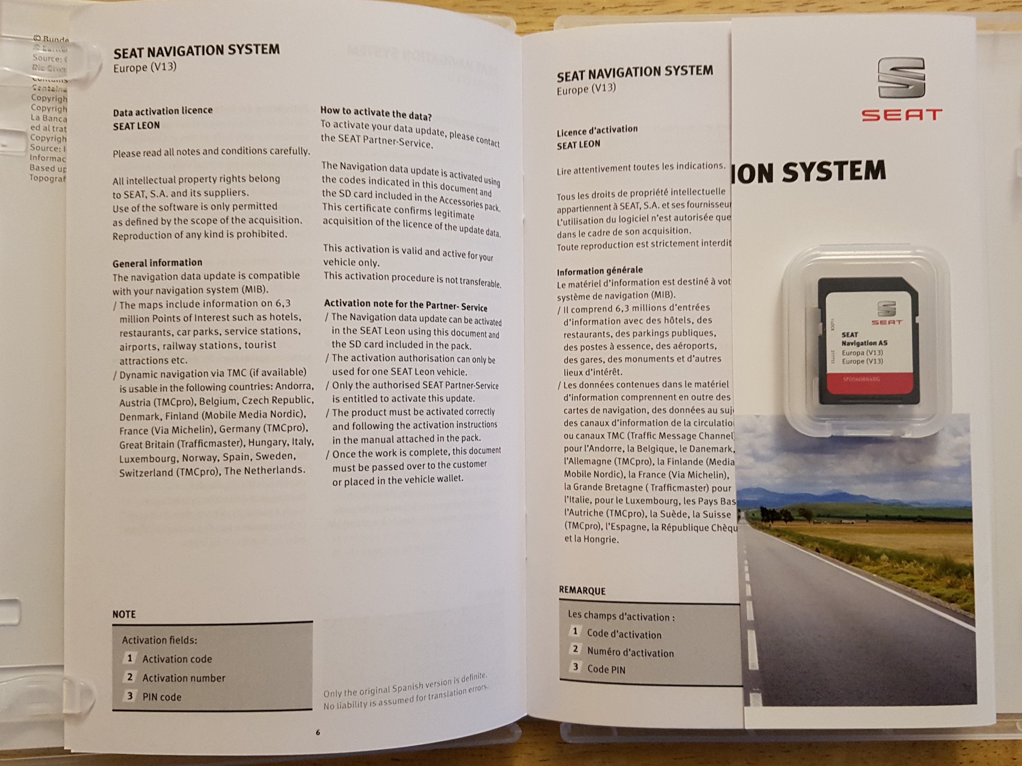

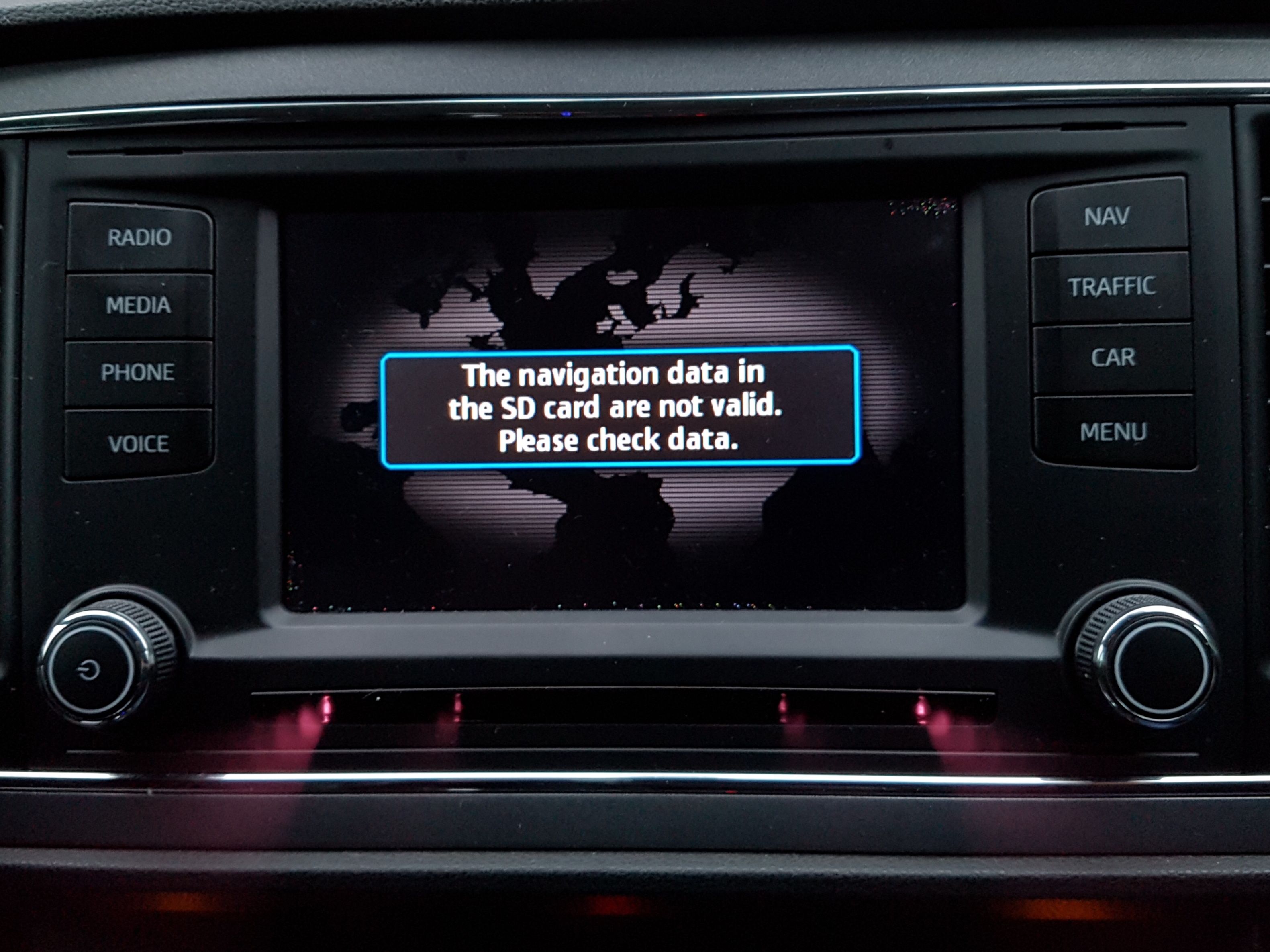

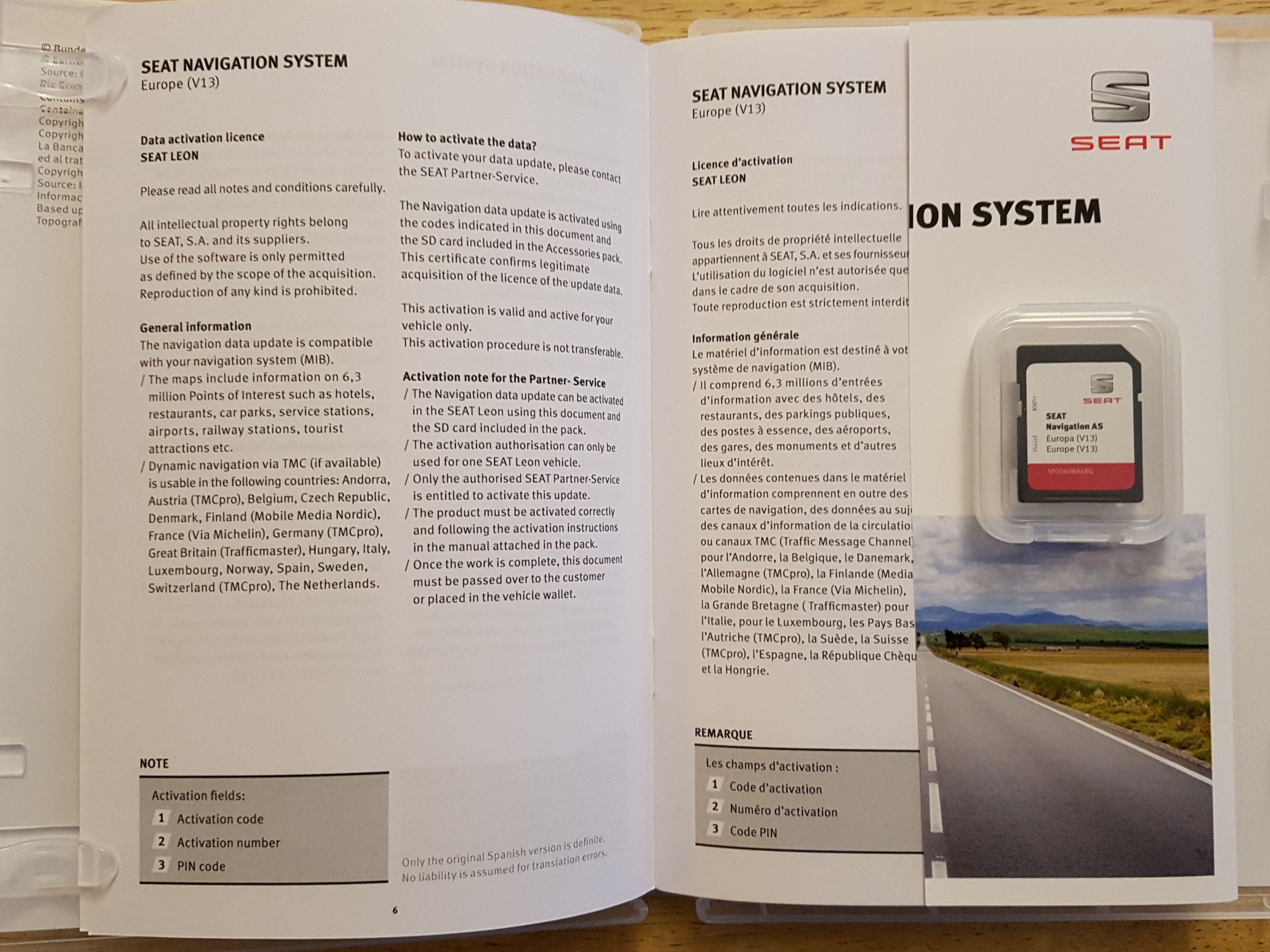

Unsurprised to hear you got dud guidance from SEAT customer services. I received conflicting advice from 2 dealerships as to which SD card is best for my MIB1 unit but when I emailed SEAT they wouldn't tell me which was correct part number, as apparently that's confidential info!
In the end I purchased a V13 card (5F0060884BG as Tell linked to in above post) from local dealership. The maps didn't update when I plugged it in, as expected, so have car booked in to activate data.
