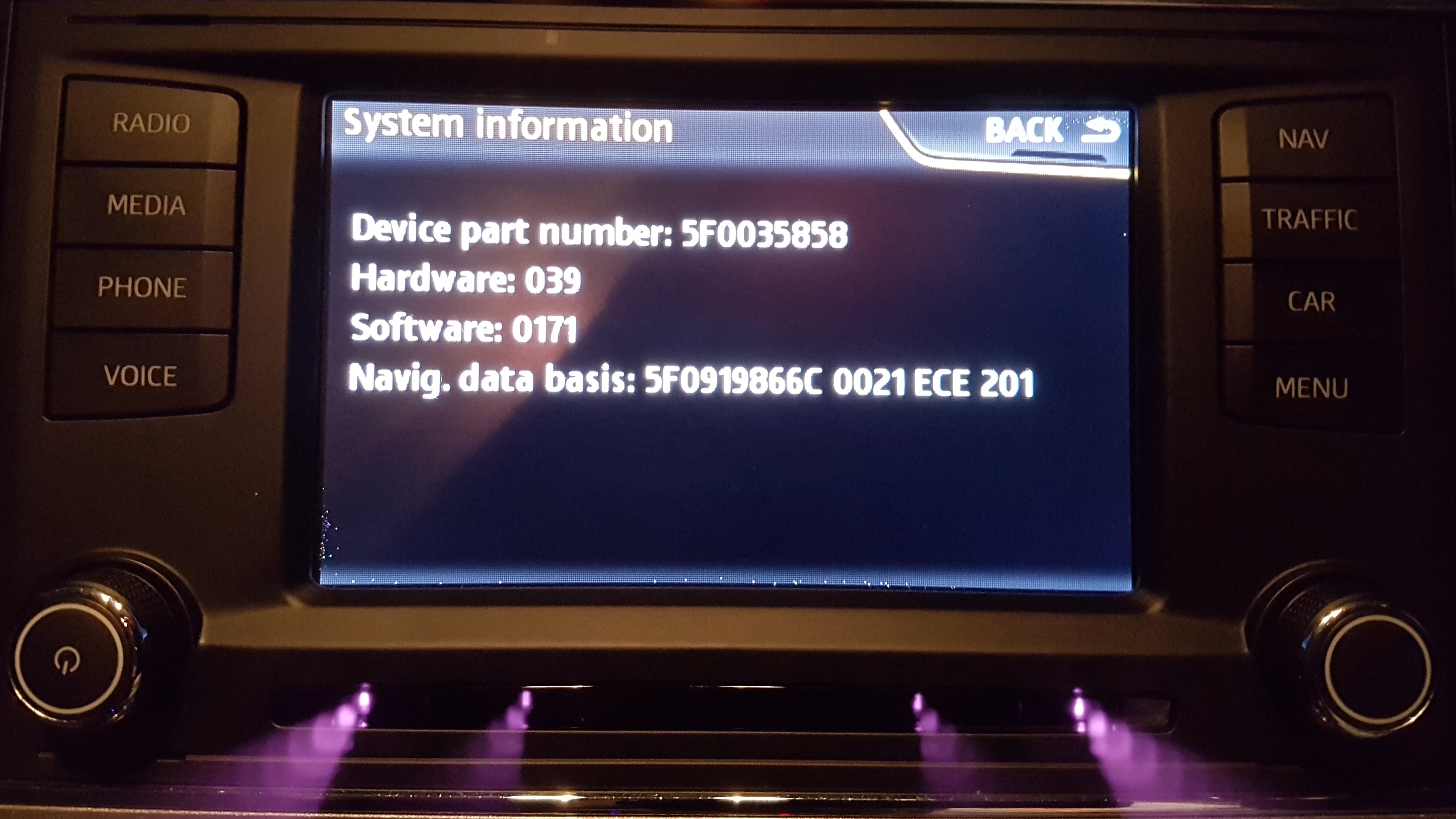

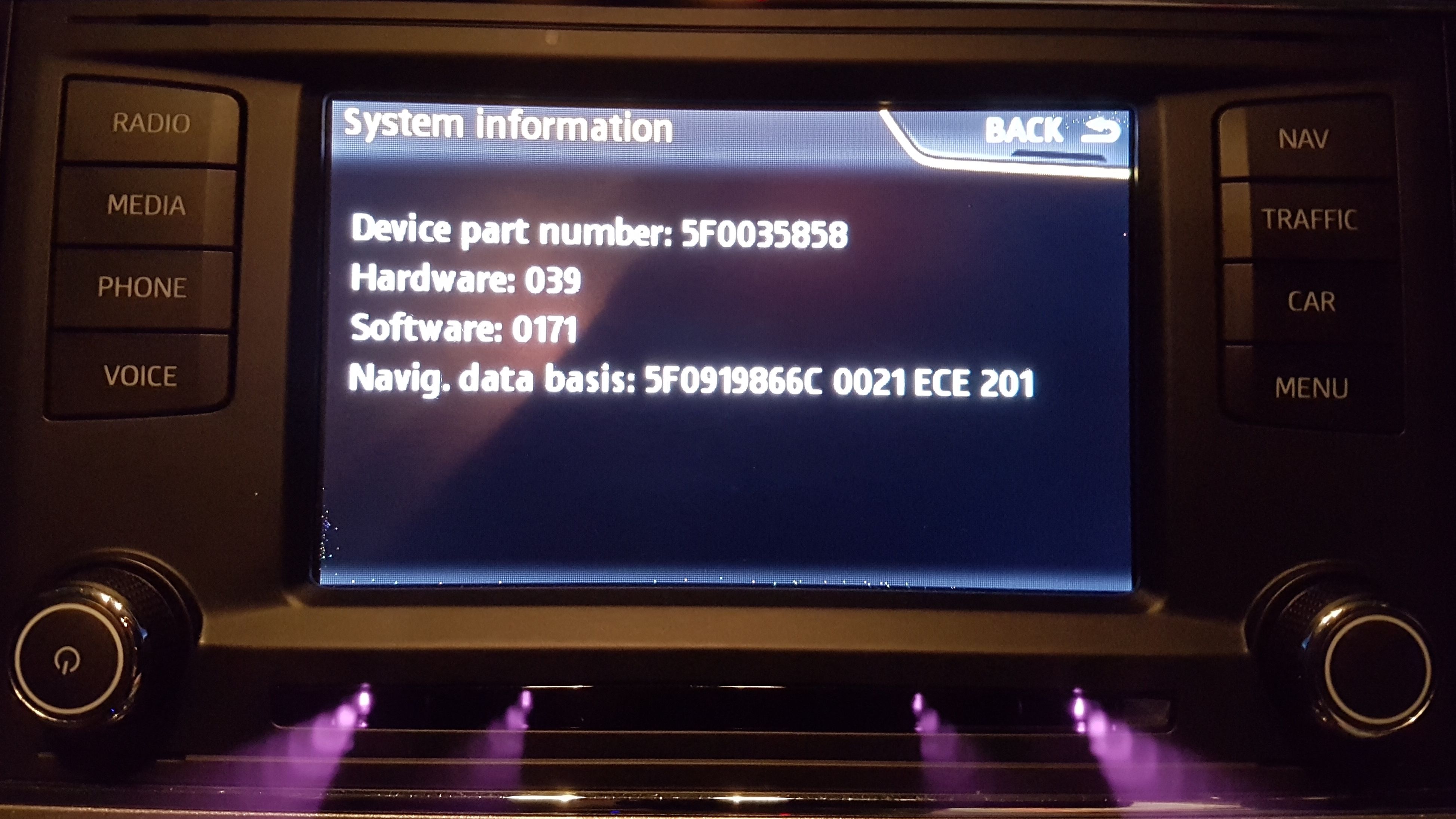

Hi, apologies if this is a daft question that was answered years ago but I’ve got a 2013 reg Mib1 unit with following system info.
Does the string 5FO.919.866.C refer to the software version and if I purchase a brand new SD card with that part number it should just plug in and play in my car?
As Listers online posted me this pack but my local Perry’s think that latest navigation version for my car should be 5F0.060.884.BG :think:
5F0.919.866.C - the '5F0' confirms you've a MIB1. The number is a part number for that specific map release. A later map release will start with '5P0' but different numbers after it.

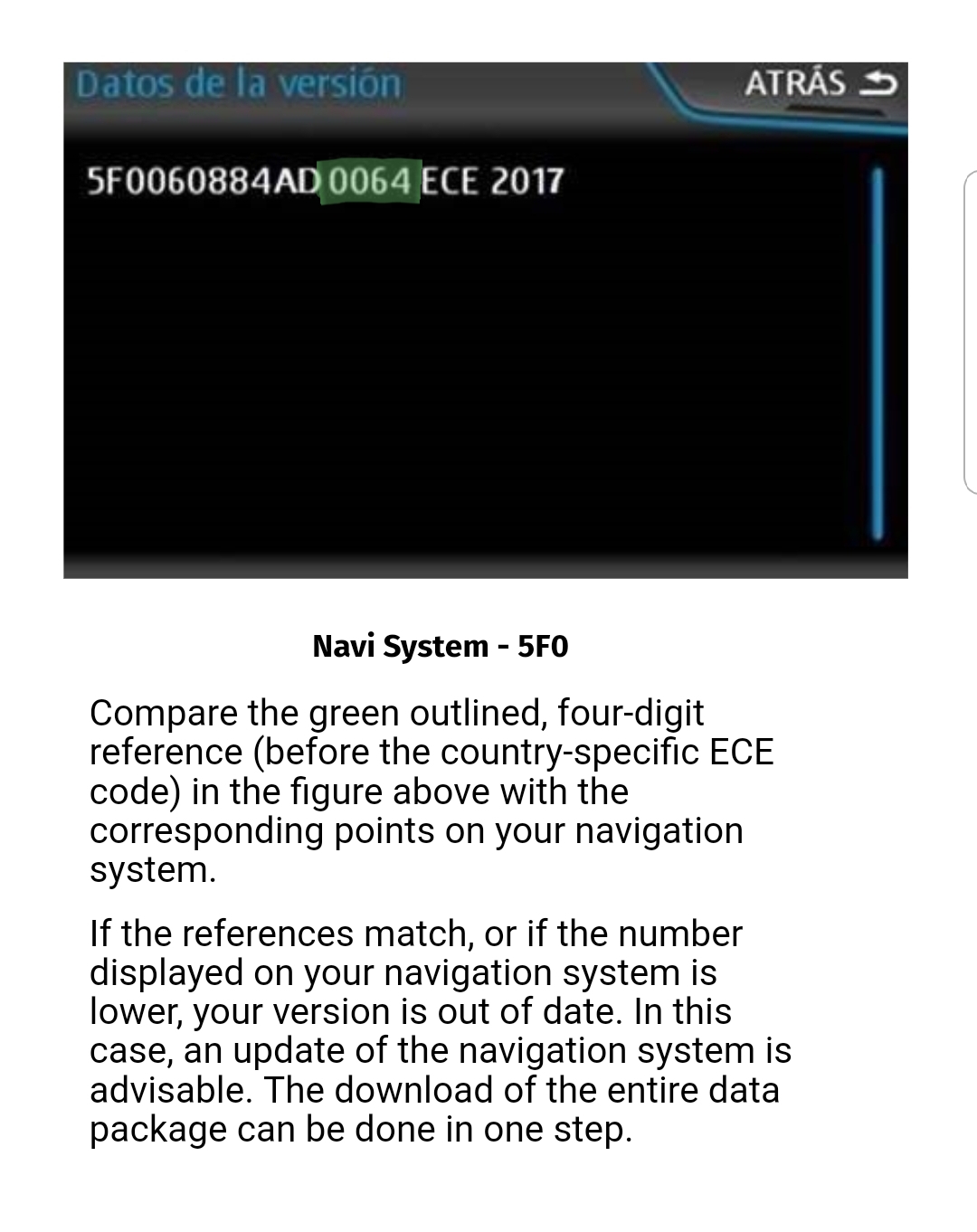

Thanks for the reply. So (if I'm understanding correctly) as the alphanumeric string matches that already in my car, I should be able to just plug in the new SD card and it'll work.
As just discovered the official navigation updates page, which only refers to the 4 numbers afterwards but those aren't written on the case; so hopefully it is latest updates and not an old card which has been sat in stock room for ages!
https://www.navigation.com/web/WFS/.../-/GBP/ViewContent-Start?EntryID=page.leon5F0
Tell
Full Member
The official Seat Navigation page is generally static in the text, just the files it links to change and then that is always behind what is on VW and Skoda servers which is why we look to them where you have the where with means to do an update if you have Mapcare, work around or retrofit.
Reckon the released SD cards will always run a month or more behind the release on the servers. That's why new cars get released with the map SD card to follow or one that isnt deemed to be current and people weedle an upgrade out of the dealer.
If the package is open I'd expect the year of release to be readable on the SD card. Not familiar with Mib1. You could download the latest update to Mib1 I made reference to and have a look. Was linked on that German Skoda board but I didn't repost here given the success of using Mib1 standard Mapcare updates is about zero in the UK.
