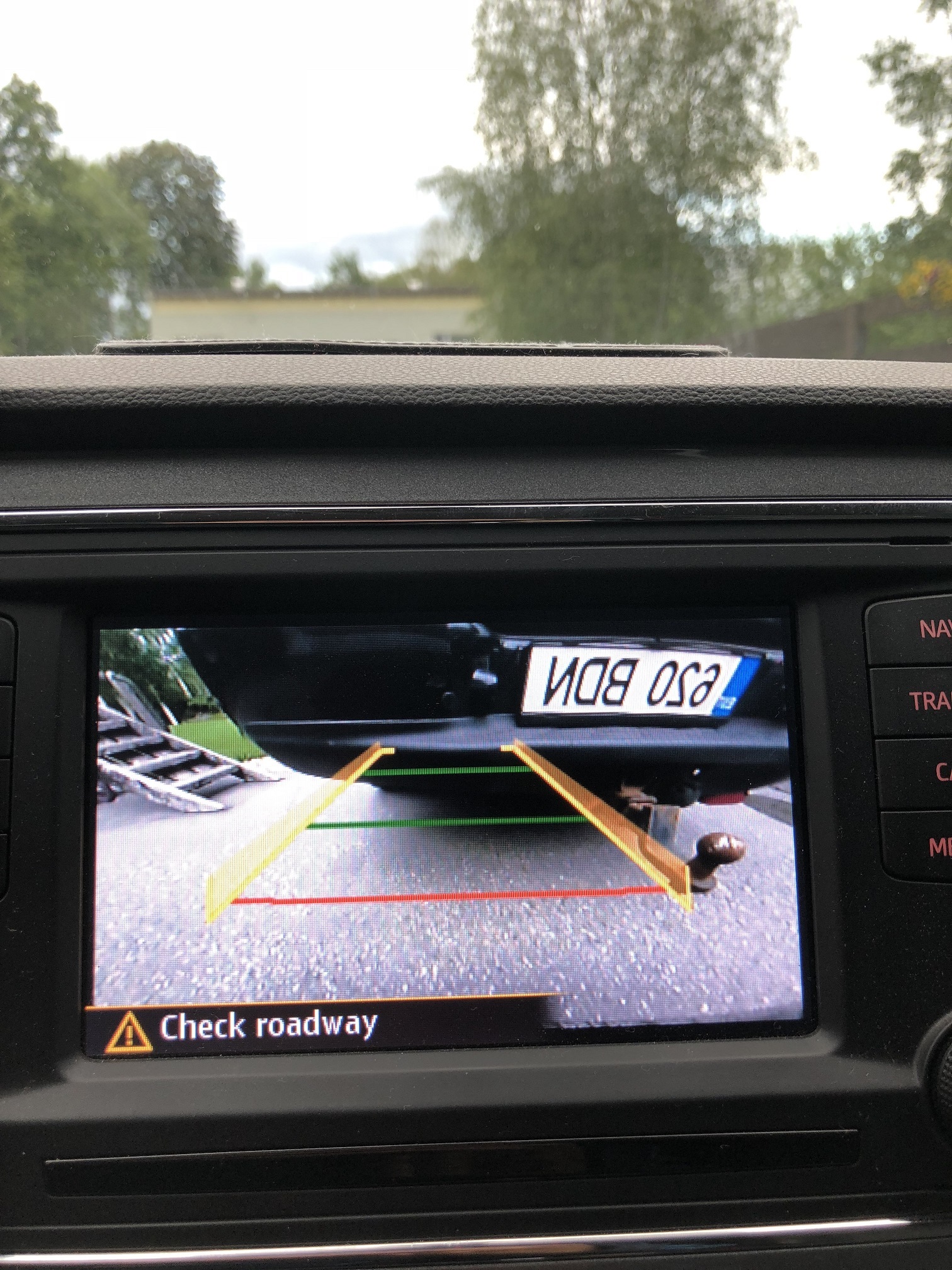

Okay, so wiring wise everything should be fine. Lets hope that vwmodul.de can come up with the correct parameterization that works on Leon.
Is your car a facelift model? I have seen two highline rear view cameras that have been fitted and working on a Leon, but both of the cars were pre-facelift models (Meich from https://www.facebook.com/mqbcoding/ and Rojas from https://www.clubseatleon.net/forum.php)
I have been thinking for a while about ordering a highline RVC from vwmodul.de for my facelift model Leon.
Now I have to patiently wait and see before ordering if they can do a working parameterization for you. Let me know when you get the camera back how things worked out. :)

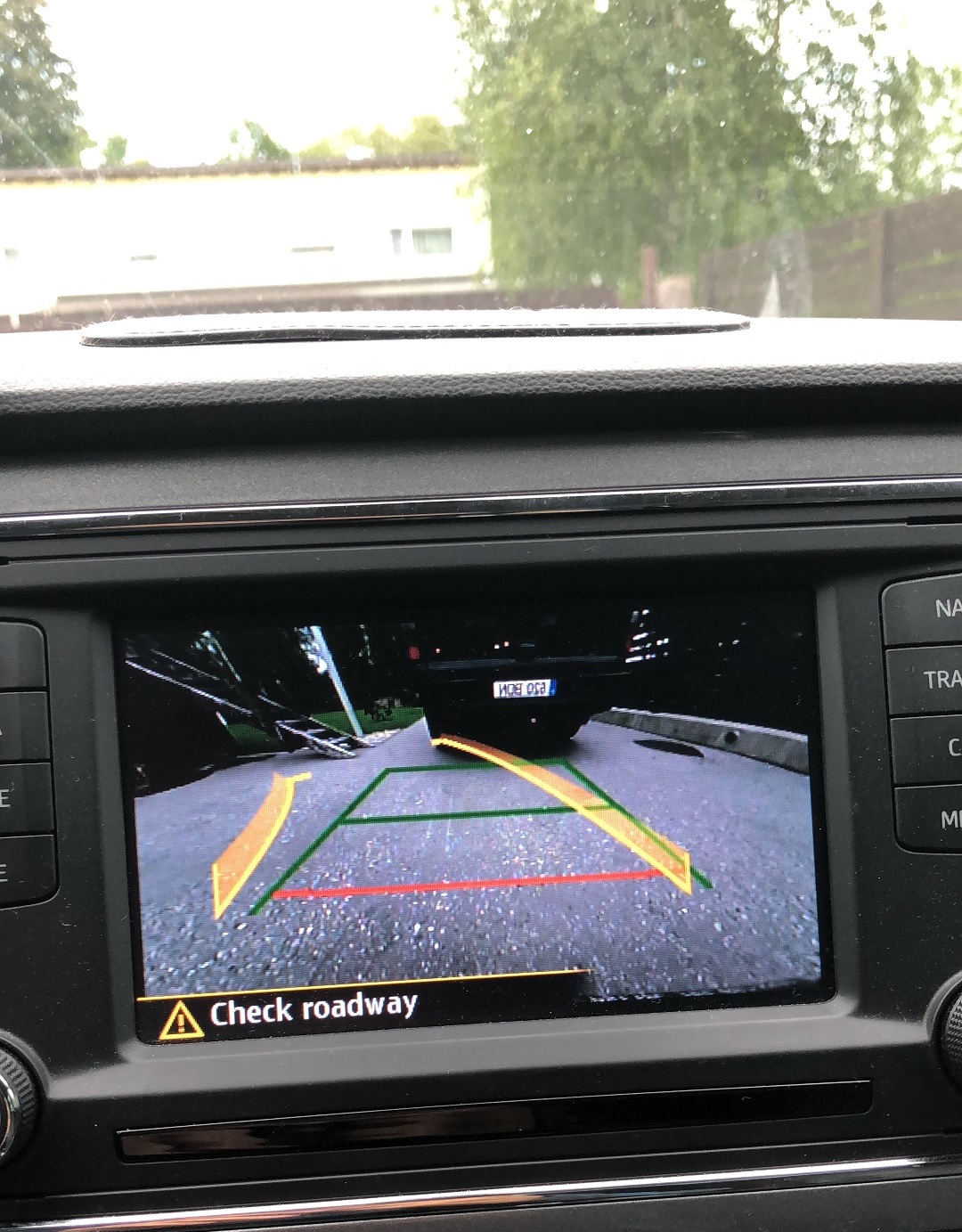

It WORKS!!! :cheers:
Parametrization was wrong, at first they did it for Škoda. Sent camera back to them and now they did it for VW and also coded it for me :)
Some pic's:
https://www.upload.ee/image/8640289/Untitled.jpg
https://www.upload.ee/image/8640298/IMG_5186.JPG
-antero-
Sep 22, 2017
60
14
Estonia
Great news -antero-!
Now I can start seriously think about ordering the highline camera.
Do you have a picture of the coding in VCDS that you have now?
Have you done the camera calibration with the dotted plate via VCDS already?
Sorry for late answer :)
Software Coding: 018402012600201F000040
I have not done the calibration and seems like I don't have to, video is nearly perfect. At least for me it seems perfect :)
