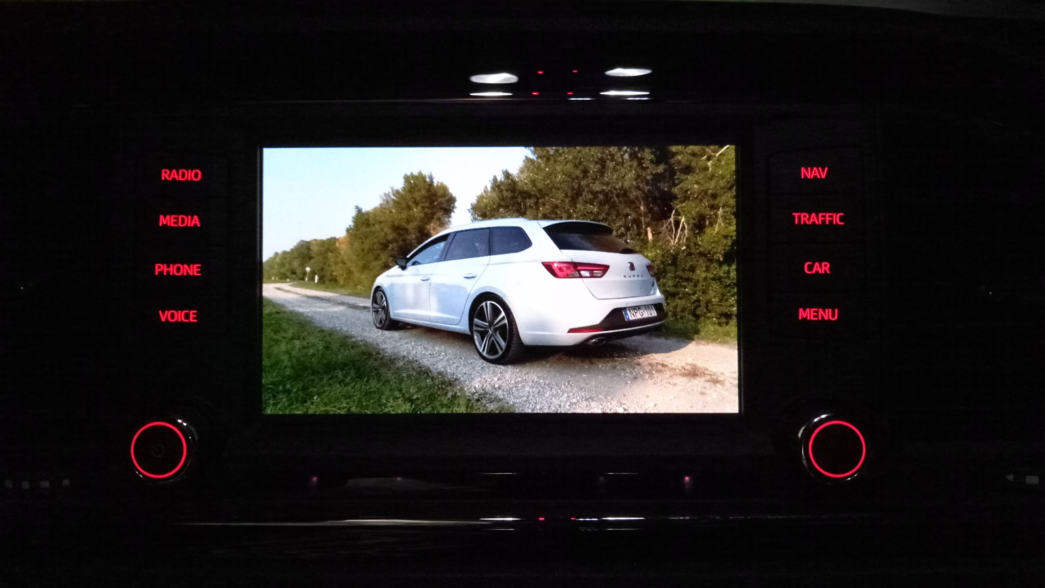

Hi everybody! I have a very simple question: Can my Cupra, with this head-unit play videos from USB, or SD? 50A 035 846; HW H24; SW 0245. Thank you for your reply! The fotos are working, but from video files comes only the sound, without picture...
