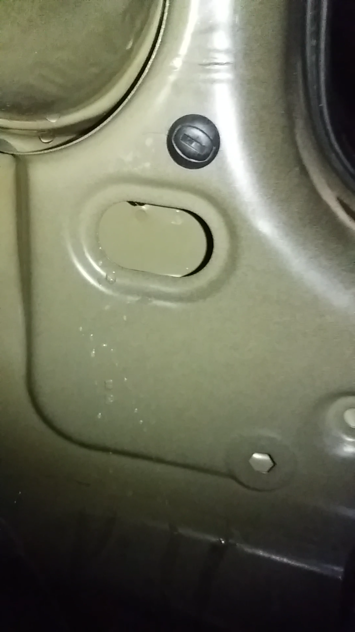

Can anyone help??? I own a 2010 Seat ibiza 1.2 5door I've got a leak in the boot at the rear drivers side wall I got a new rubber seal and tailgate light from Seat but still the leak is there anyone be able to find the cure!
At the trunk door hinge, check. Try to poor wather there and see if is coming in the trunk
Trimis de pe al meu ANE-LX1 folosind Tapatalk

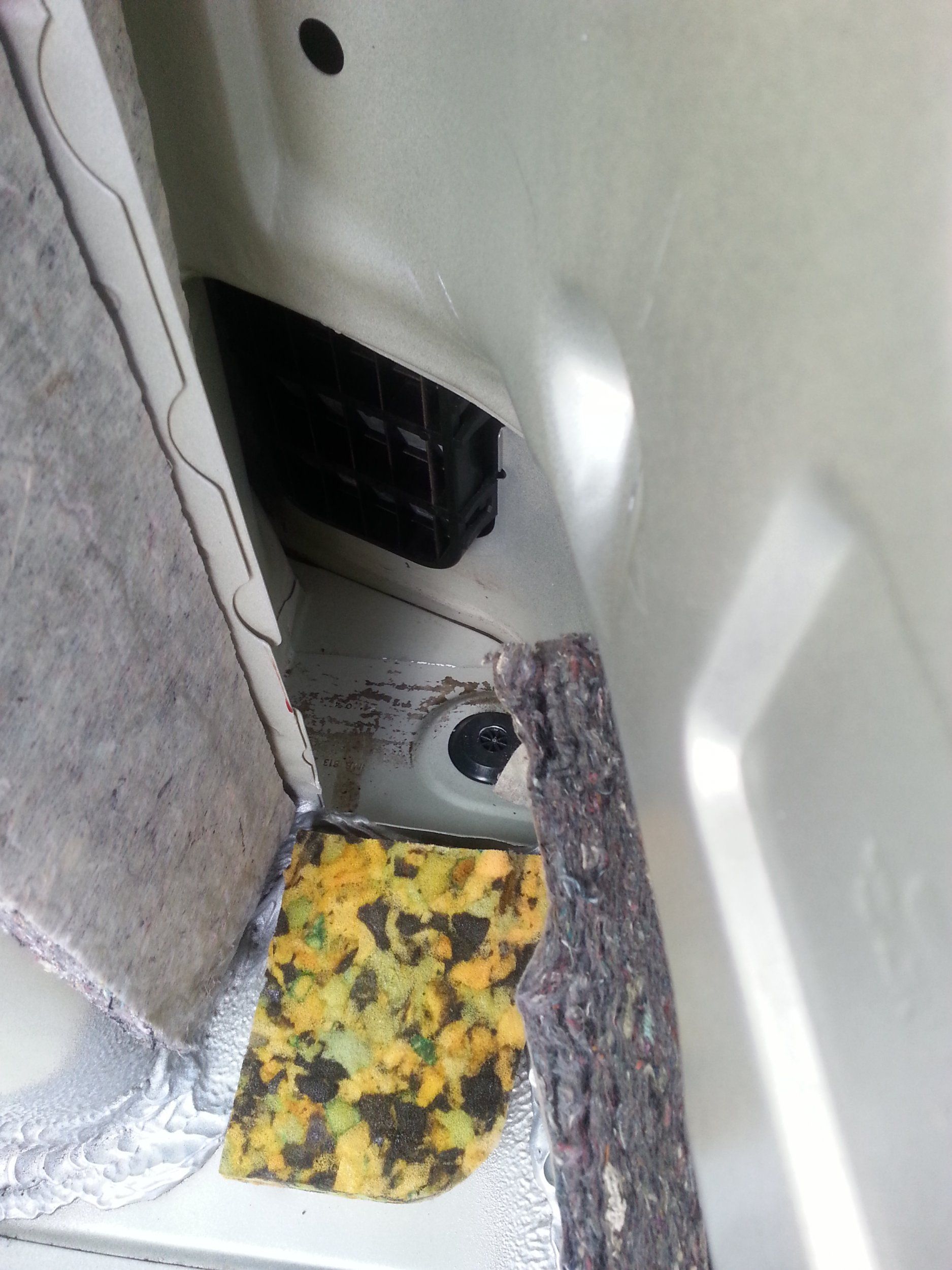

I watched the water come round the back of the arch to this box section...
You can see some of the most recent water from a rain shower in the photo

Iv got water coming into the boot as well. Its collecting in the box section at the bottom between the arch and bottom of the lights. Seems to be coming in through the rear spoiler. Already resealed the rear lights and aerial.
For sure not from rear spoiler is coming. We believe that the boot hinges, but not sure. Write here if you discover something new.
