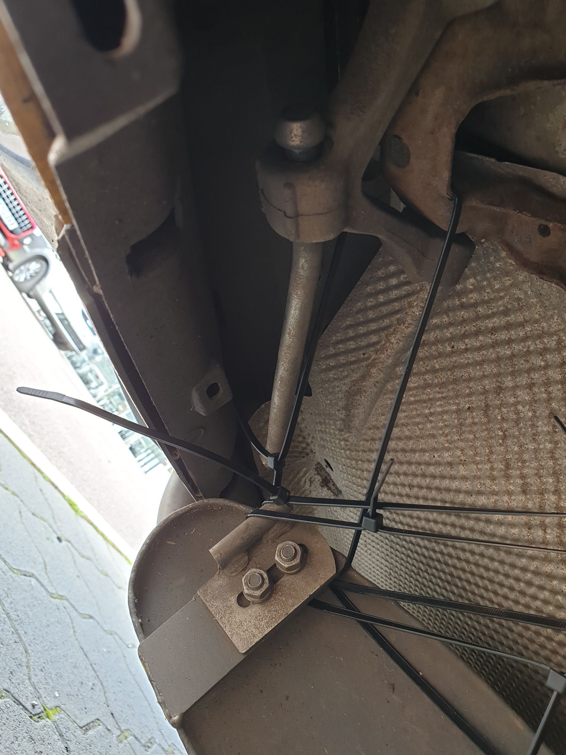

Pulled into a garage as the exhaust looked droopy one side and it was the right hand bar bolted to the backbox had snapped. New one going on tomorrow.

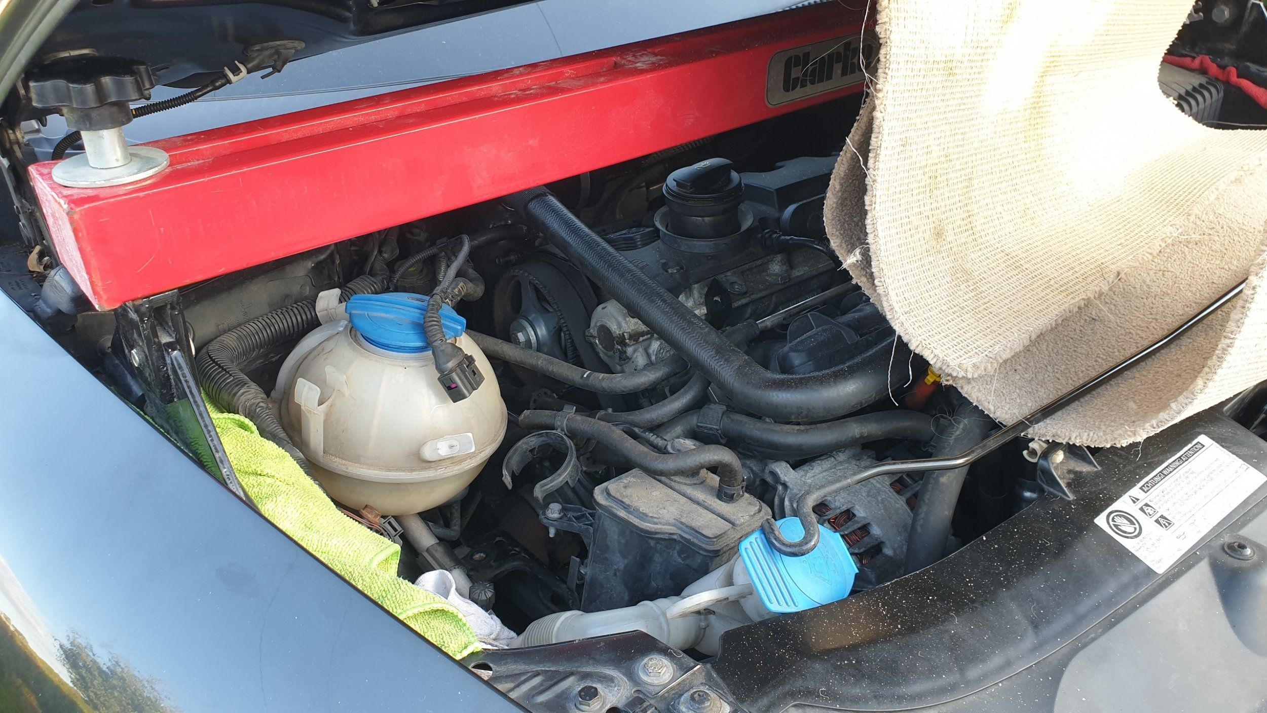

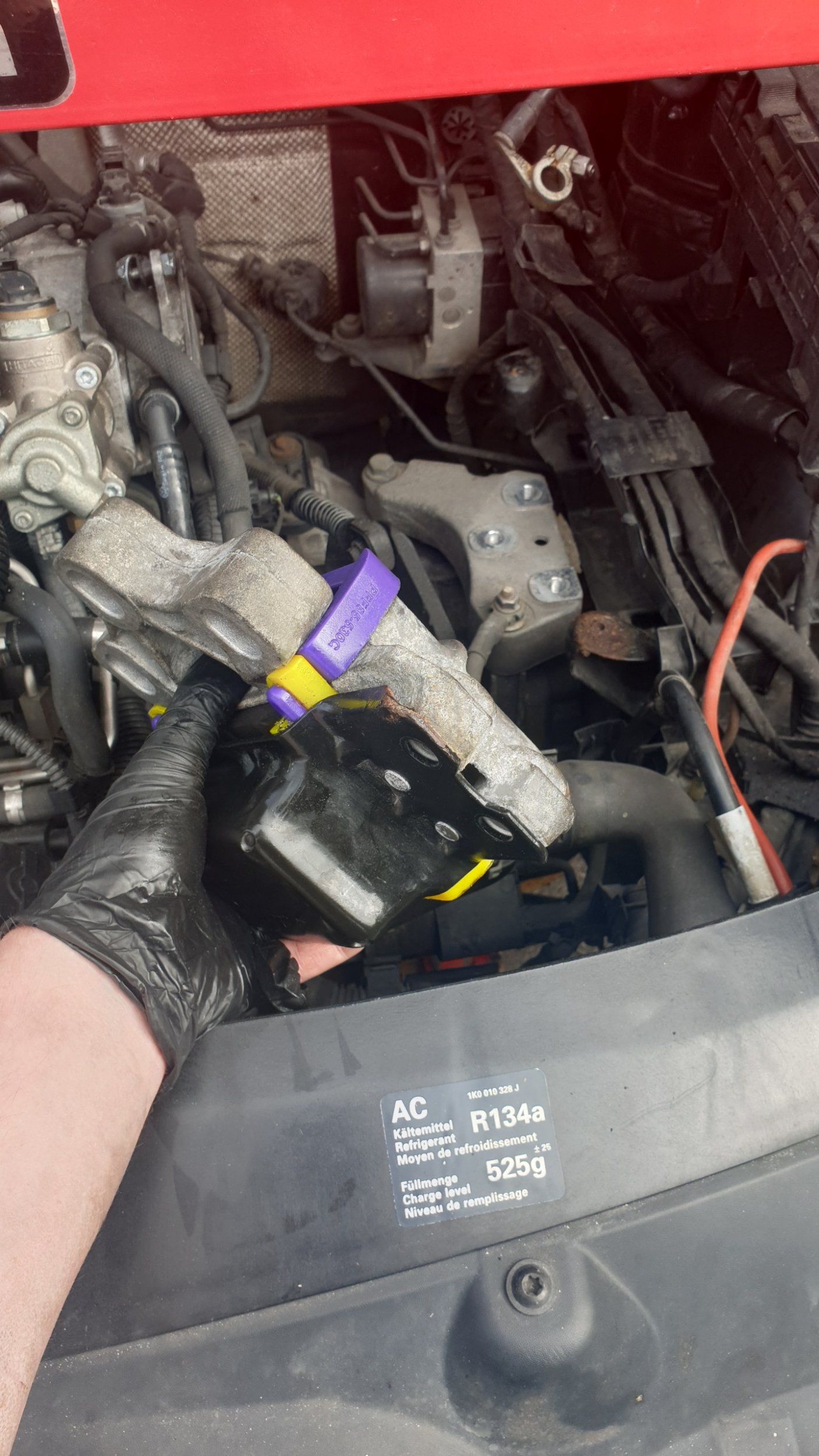

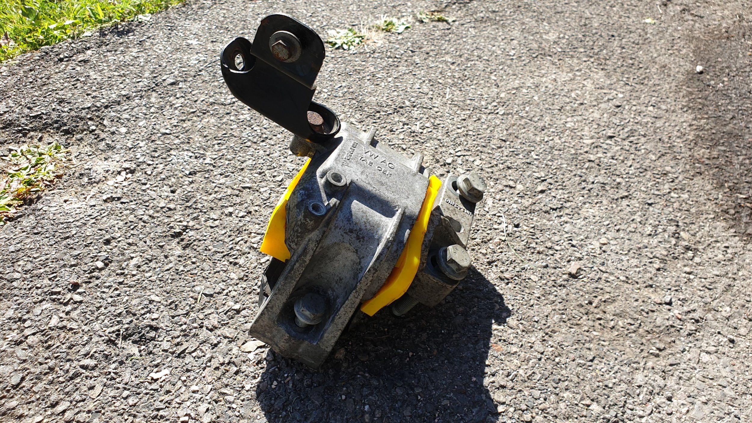

Don't think I could of done this in a day! But rather in 3 :p
Replaced:
Timing belt
Auxiliary belt
Water pump
Coolant
Timing belt idlers
Tensioner
New install:
Powerflex RH and LH engine mount inserts
Powerflex lower engine mount bush (small)
Powerflex lower engine mount insert
I'll post a review of the engine mount inserts on my Readers Rides if you'd like to know more about them - https://www.seatcupra.net/forums/threads/chriss-mk2-cupra-r.448113/page-2#post-4922167

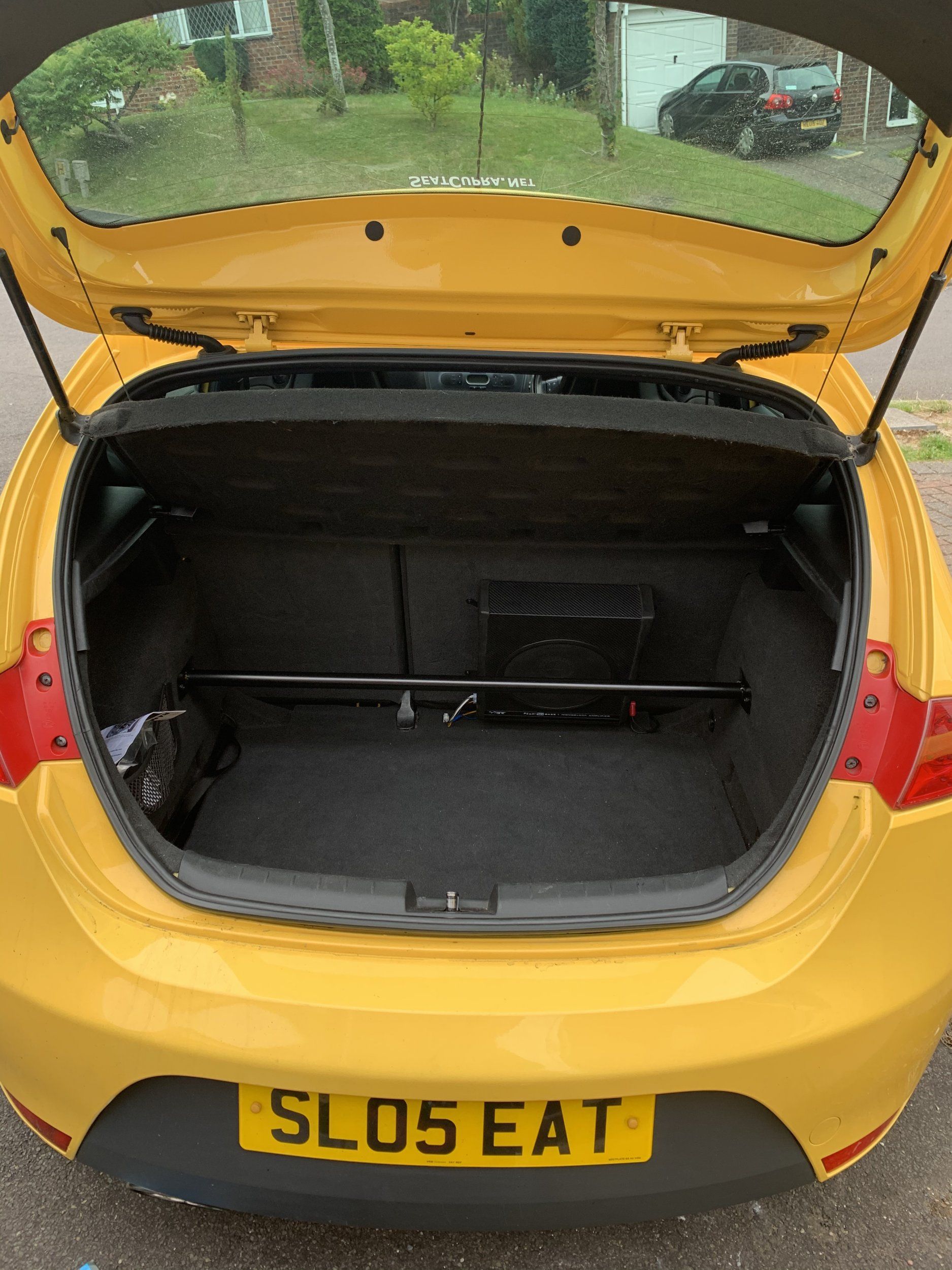

I fitted a whiteline adjustable rear anti roll bar and rear strut brace to mine now worth every penny. I have got a front strut brace in the way too and am gonna order the matching whiteline front anti roll bar too when it’s in stock.

Exhaust hanger bar snapped so a garage zip ties the exhaust up so I can get home.
Can't get the part in it's own by the looks of it which was annoying but managed to get someone I know in a design and technology dept to weld it back together with an added brace ?

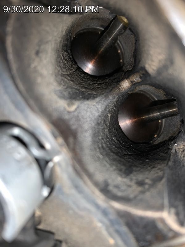

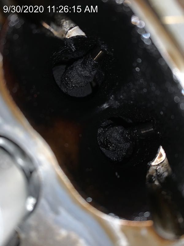

Had my intake ports cleaned for the first time (68500k), engine started and ran fine with none of the usual symptoms of valve build up, but it was bad.
Now much more responsive and more power.
I had the walnut blasting done at Dukes Park Automotive, they are in Chelmsford. They gave me a loan car at no extra cost as they need most of the day (engine has to cool down), excellent service.
