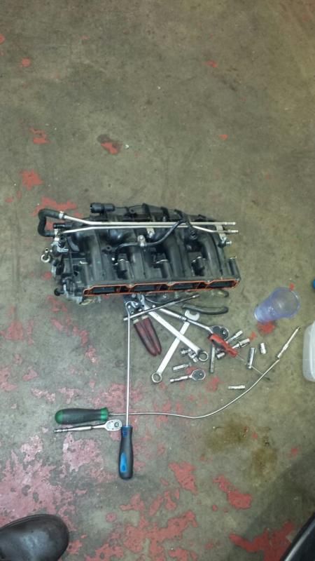

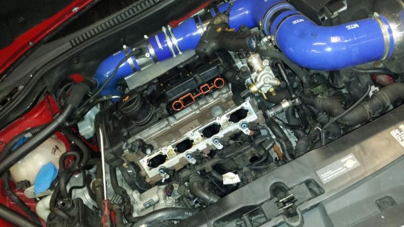

did you remove the inlet mani and clean the valves?

was reassemble as bad as disassemble?

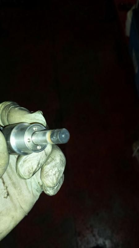

whats that in the last picture?
did you get any pictures of how clean you got the valves?
My phone battery died by that point mate as it was gone 10pm lol
The valves were 1000x cleaner I sprayed them with forte cleaner and left it to soak for 10 minutes and then hacked away at it slowly with a flathead screwdriver.
The reassembly was harder than taking it off yes, the throttle body plastic pipe was a *******!
The last picture is the failed injector mate
Sorry if I'm being dumb, but where did all the crap go josh after u cleaned the valves and hacked it all off?
