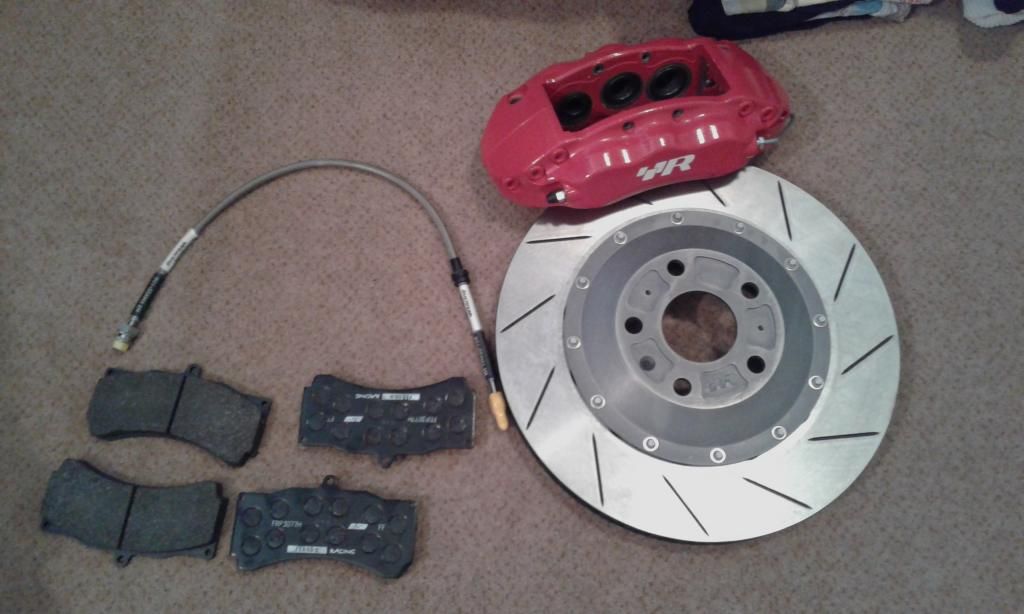

Good job on the change of brakes. Not too hard is it?

Nope not too difficult. Rears are harder than fronts, access to the 14mm spline bolts is bad and also you'll need a right hand thread piston tool to make it easy to push the rear Pistons back in!
