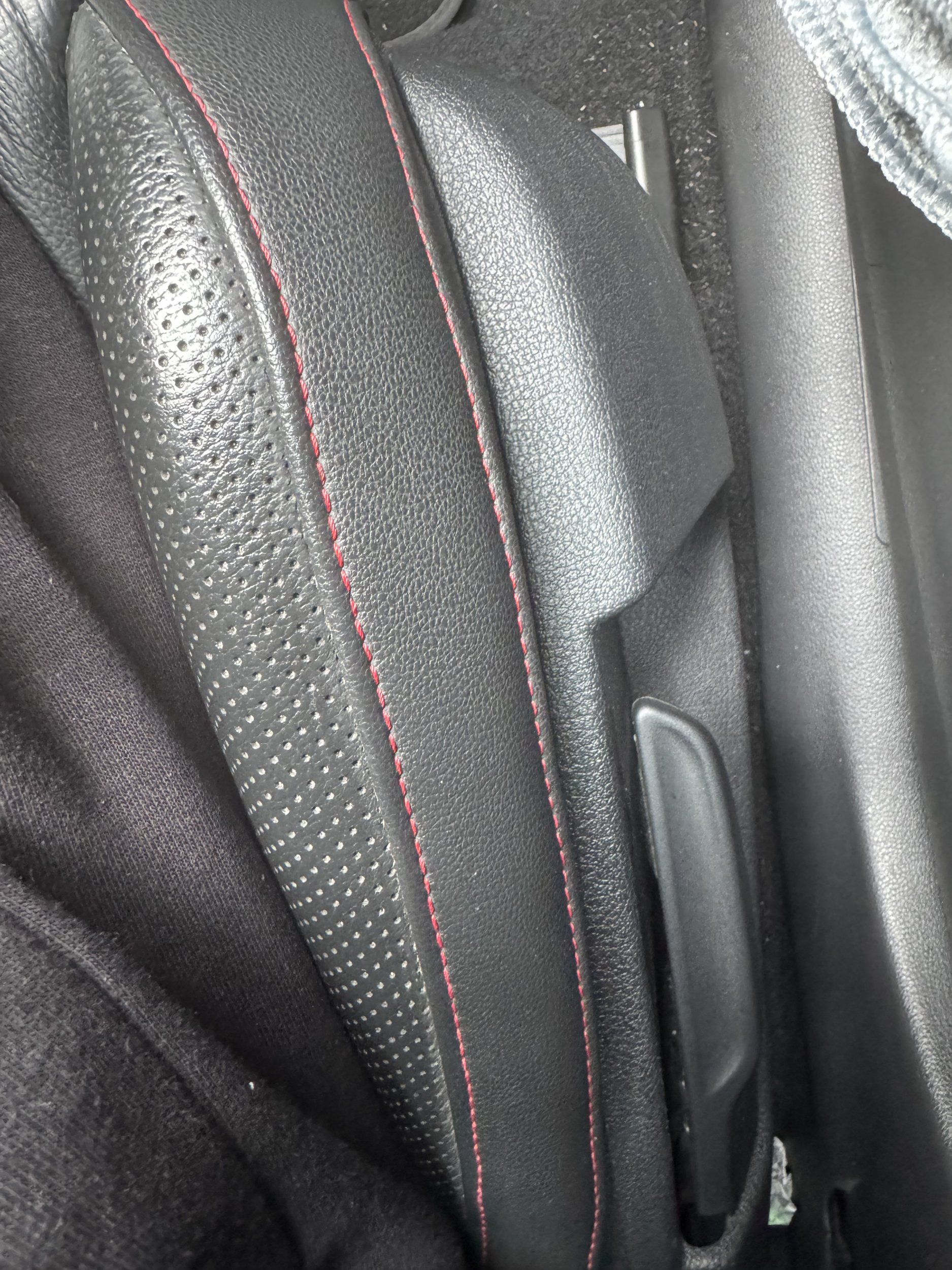

@Tester01 Yes, I also have this and the fix is very simple. The lower seat padding is making contact with the plastic of the chair. I put in a piece of foam between it, so the lower seat padding does not make contact anymore. Solved.
Is it easy to access? Would I have to remove the seat?

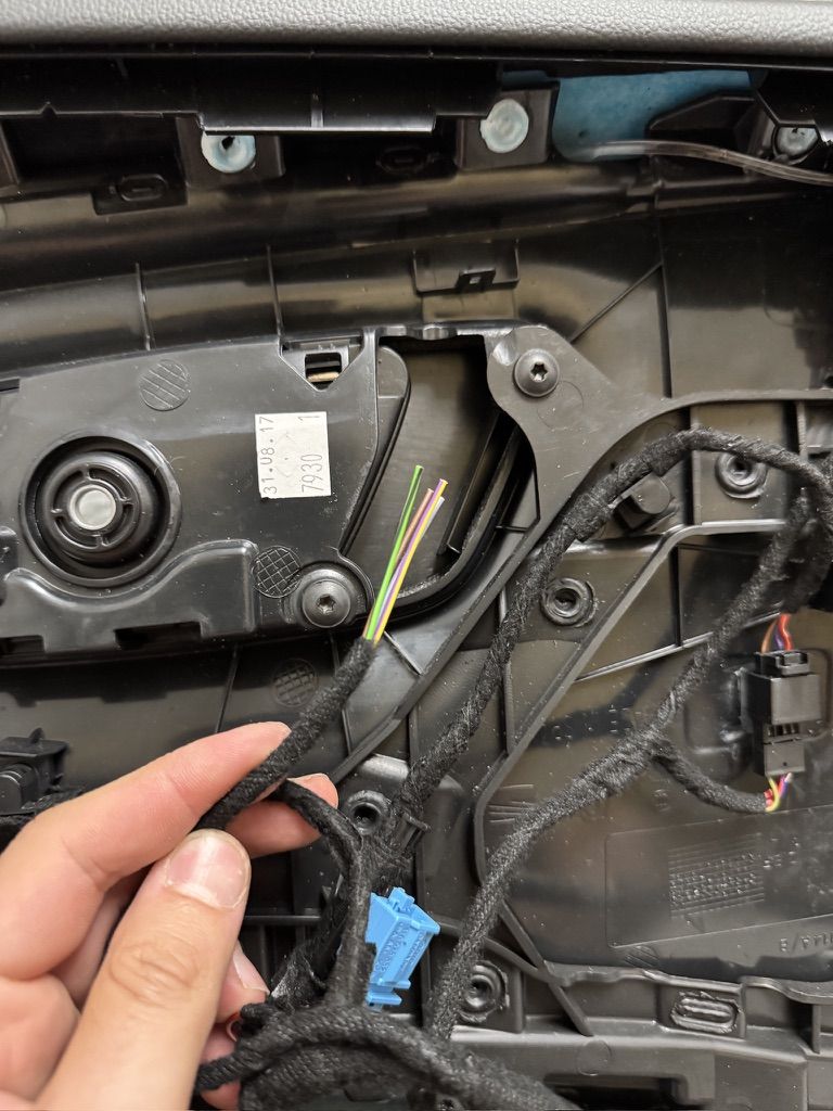

Recently I was messing with wiring in passenger door. After looking through wiring diagrams I found out that Audi A3 8V could have door lock button on them. I thought that Seat cannot be worse than Audi so I present to you modification nobody asked for :ROFLMAO:
I've used door handle from UK version and due to white illumination I had to swap electronic to Golf 7 button. What is funny is that this button was already coded in my car and it started working right after I've plugget it in!

No, just push the lower bolster to the side and put some foam in between it. if I remember I will create a picture for it (y)
Take it you mean between here?

Hope it’s source of mine.
Now to figure where to buy foam I guess Amazon, tried the local shops near me nothing.
is yours a prefacelift? As my facelift FR has those buttons already (along with auto lock when you start driving, unlock when you turn the engine off)

Hahaha ah that’s a good point! It’s never bothered me not having them on the passenger side mind you. Is the wiring already there then? Just swap handle frame and away you go?
Me neither, but I was looking through wiring diagrams and though "ahhh screw this, let's do it!" ?
Unfortunately not, but it is relatively ease to fabricate. 2 new wires from 32-pin connector, 1 wire tapped into ground wire and 1 wire tapped into button illumination wire - that's it.
Is there a need for more detailed instruction? If so then I could add something into Leon 3 resources for that one silly guy who will look at this and think "that's exactly what I needed!" :ROFLMAO:
