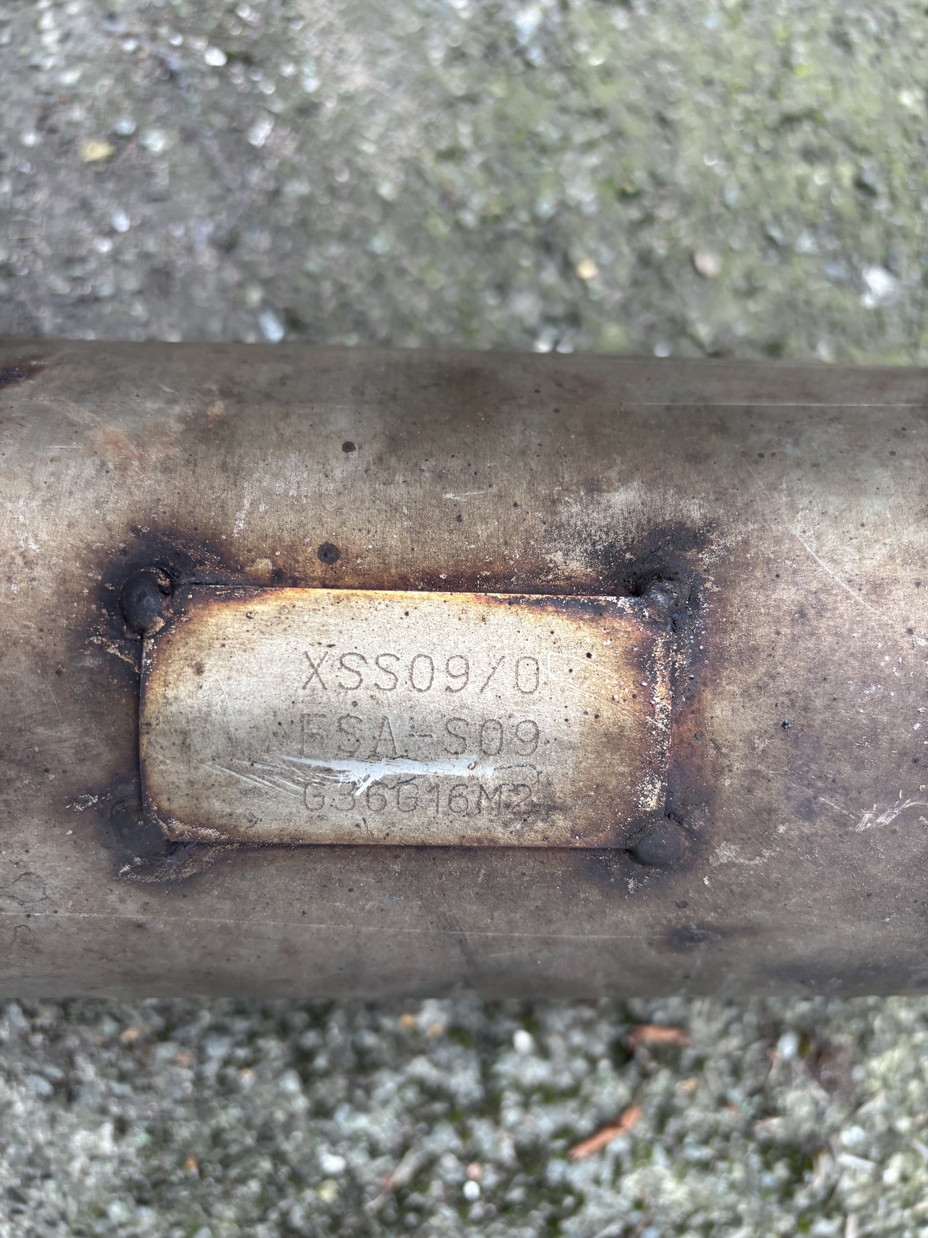

Anyone know where this is from? Found it under a seat
