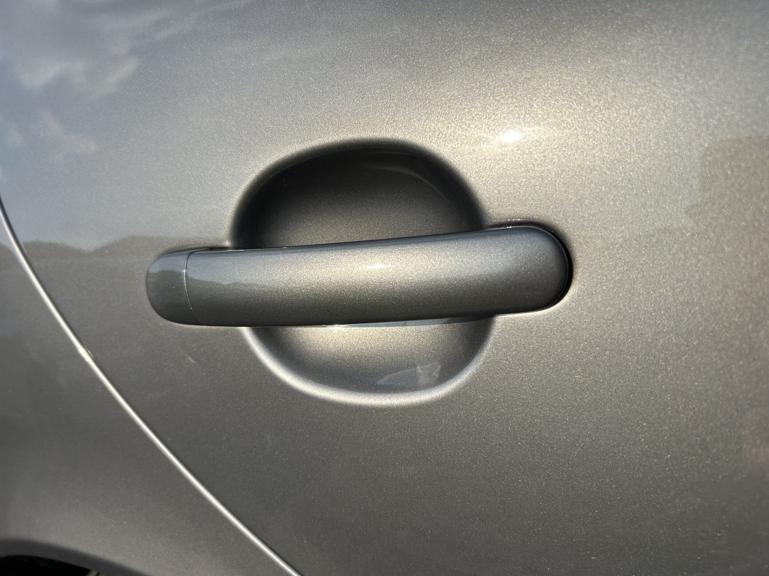

I painted a full set of door handles and barrel covers. This project was started about a year ago and I finally got round to finishing it off.
Handles were sanded, primed followed by base coat and 2k clear coat. I then wet sanded the orange peel and polished. Quite pleased with the results given I don’t have any prior experience at paint.
Hopefully it’ll be a durable finish.
View attachment 54057Now for the sting in the tail - when swapping old for new door handles I’ve loosened the lock ring carriers too much on both the front doors and the lock ring has dropped into the door cavity. Looks like I’m in for a full door strip x2!!

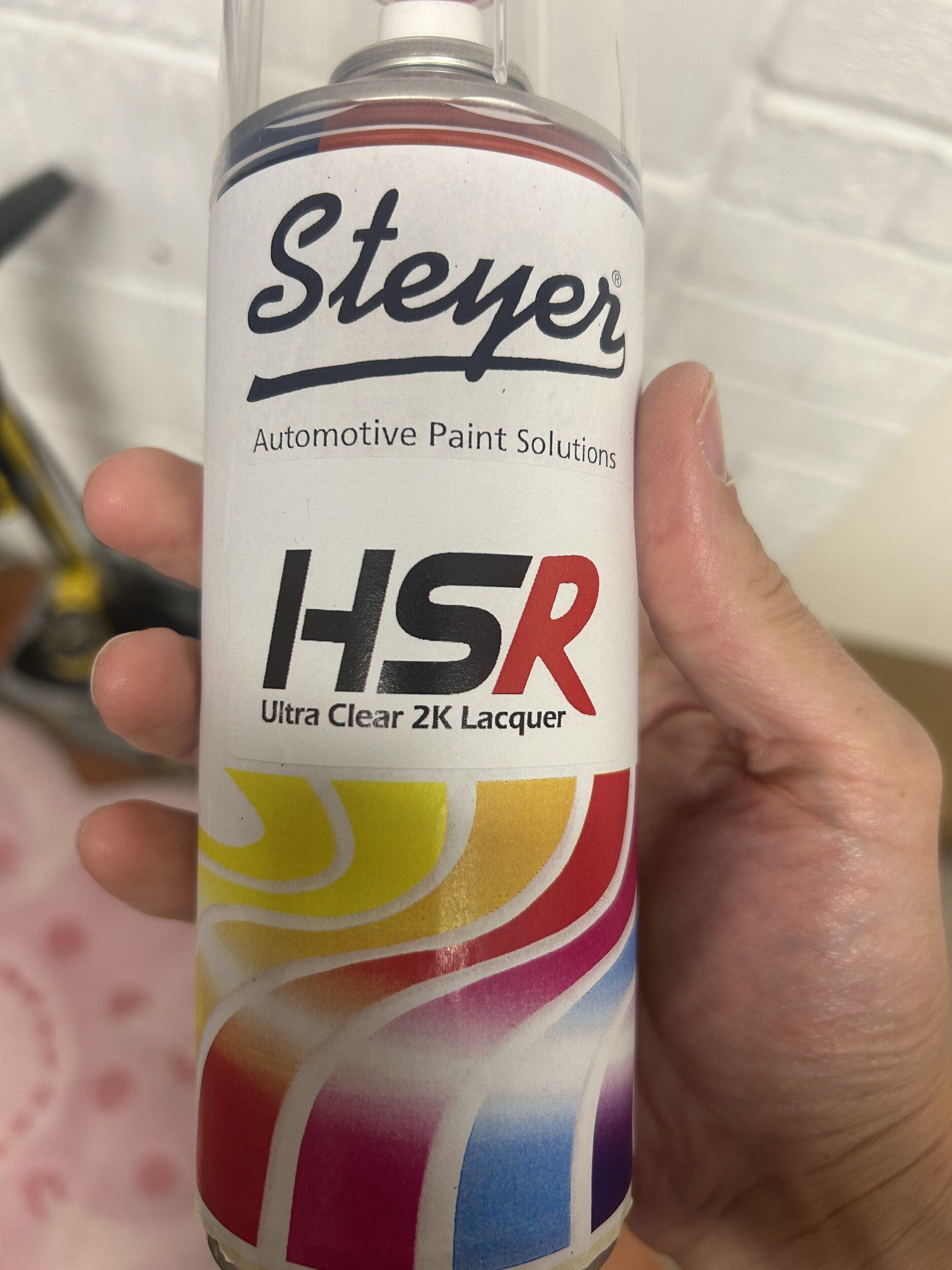

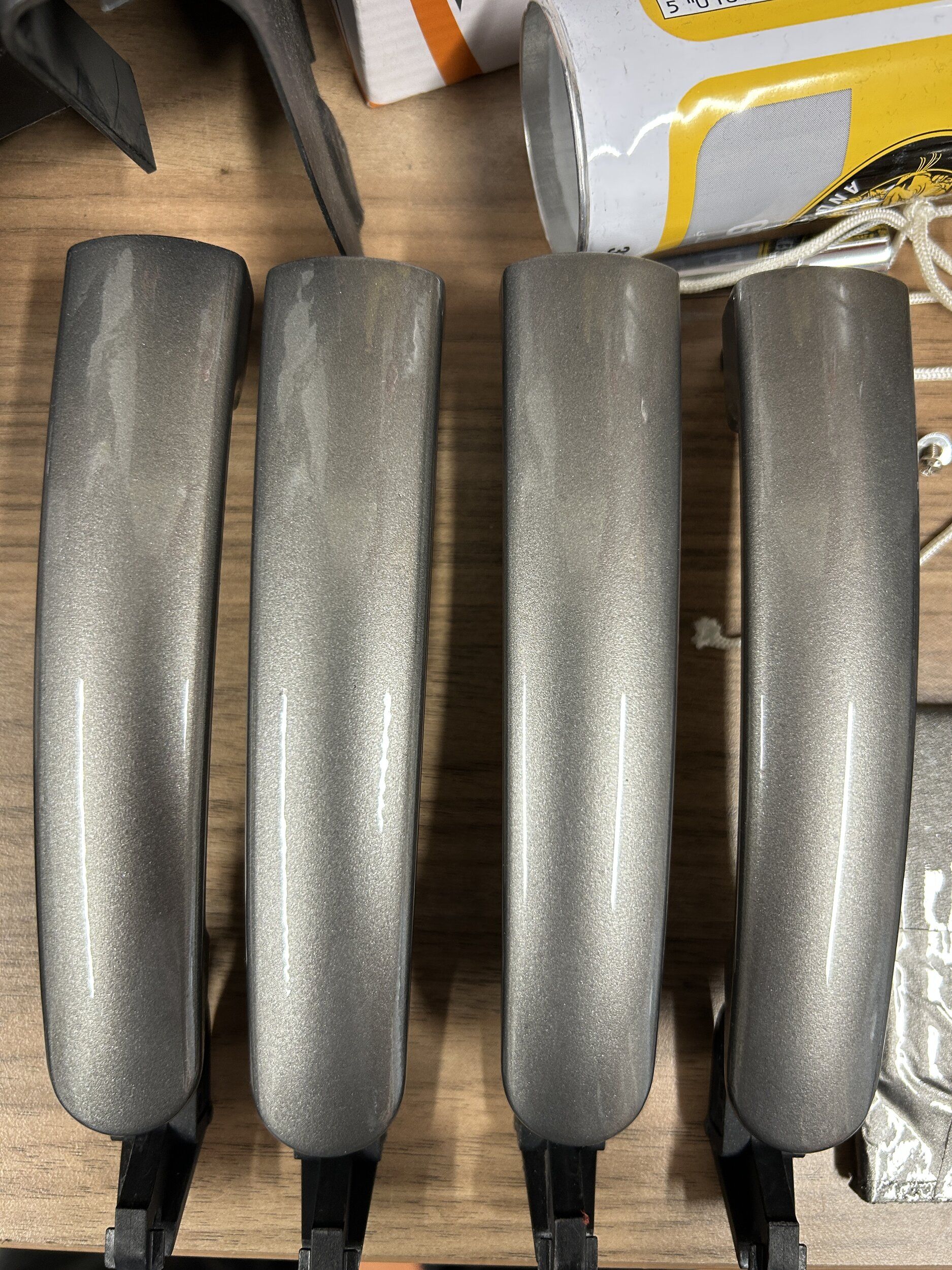

How did you match the paint? Looks perfect. šŸ‘
Just used the paint code for platinum grey. For small parts like door handles, I don’t think paint match is a big problem due to the different angles the light hits. Maybe I got lucky too?!?
this is what i did but paint was slightly faded you don't see it until its on, the same local autopaint shop then matched the paint , mine is red and some paints fade worse than others, i had paint fade on the bonnet and rear bumper when i got it but buffed that out.. if i had one of the detailing machines ill bet the whole card would go back to the same code .. as when i did that trim i did that side before hand and it come back up and i wished i did the bloody passenger door also lol , i said ******* like Sean Bean
