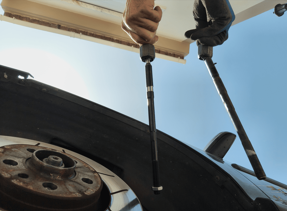

MOT is always a pain but this time I got to give them a good tip in the jar :)
They told me the car could be (or not) having a wasted inner tie rod. In fact, when braking I felt like a pulse on the brake pedal, like a bent brake disc or one side braking more than another.
So I went for it and took off the right side tie rod. The picture speaks for itself - left one is new and is stiff like a rottweiler and at the right you see that totally loose old piece of tie.
Now the car brakes better without vibration and no more clunk noise during bumps on the road. Just need a wheel alignment (second this year) and good to go win the MOT.
Note: Changed both sides and go for Lemforder ones.

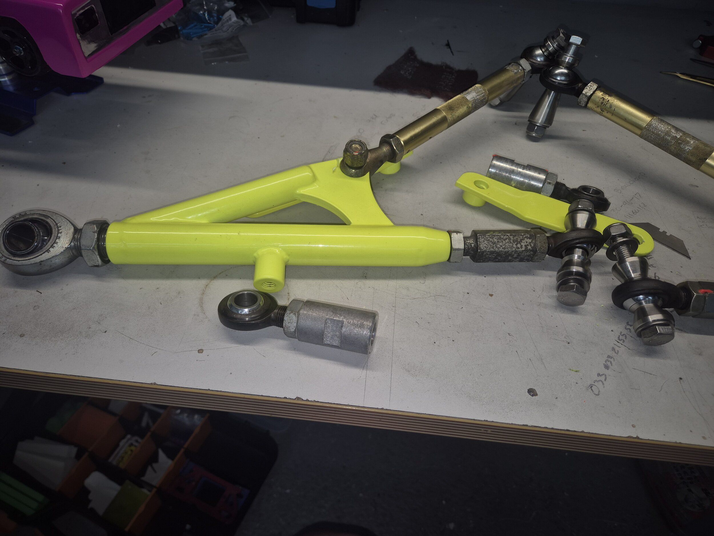

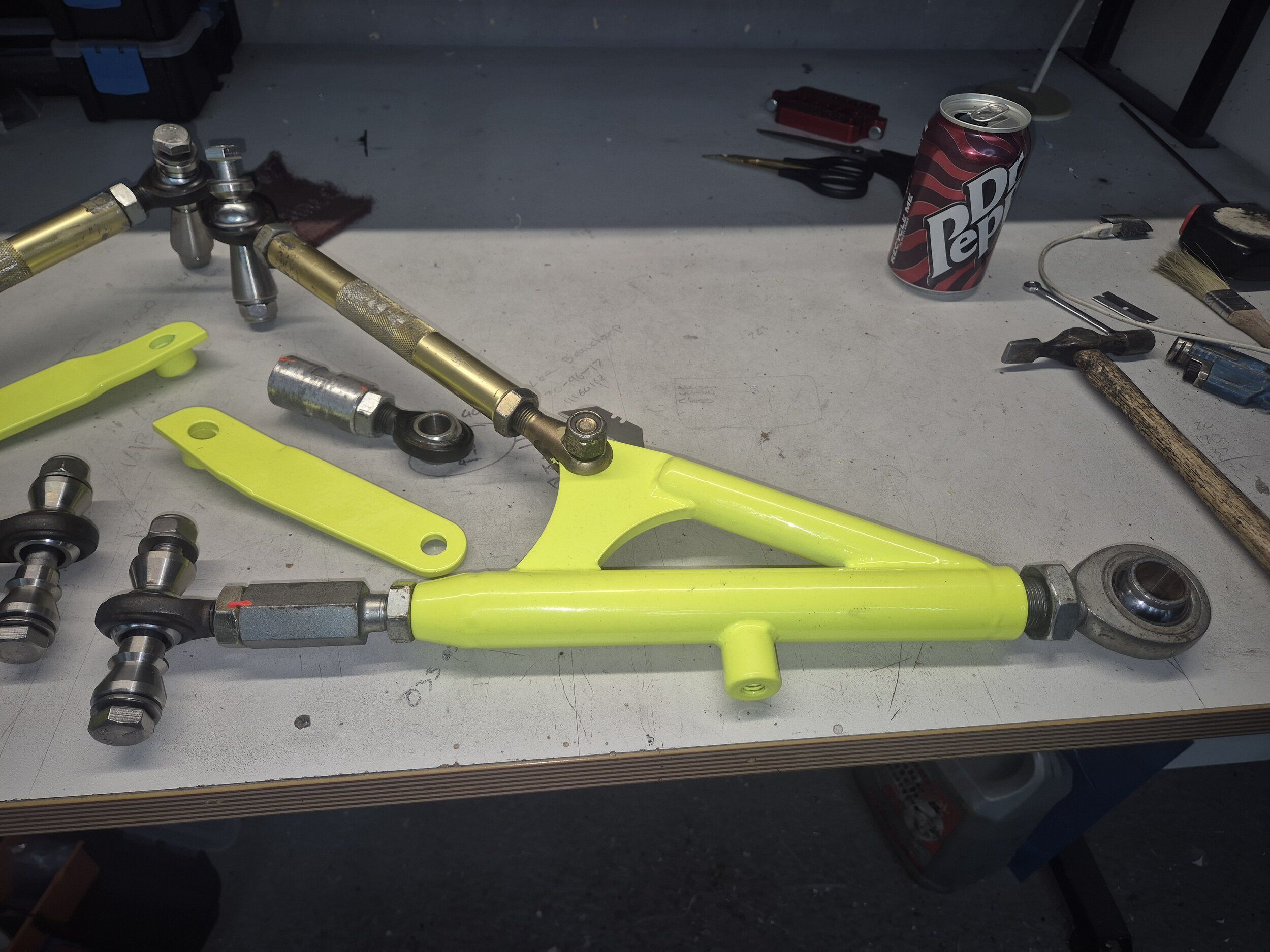

Evening all.. right ... there is some clever ones among us.
Just wondering. Does any one know the dimensions for the centers of the lower arms.
I am rebuilding my adjustable lower arms . But wanna set them "factory " for a starting point.
. Also.whats the wheel base. Center to center if anh one knows
Not me, I'm an idiot. But I do have a silly amount of data
Balljoint centre to front LCA bush centre - 395mm
Front of front LCA bush to centre of rear LCA bush - 340
Don't know balljoint to rear bush centre
Also.whats the wheel base. Center to center if anyone knows
2513mm is spec
