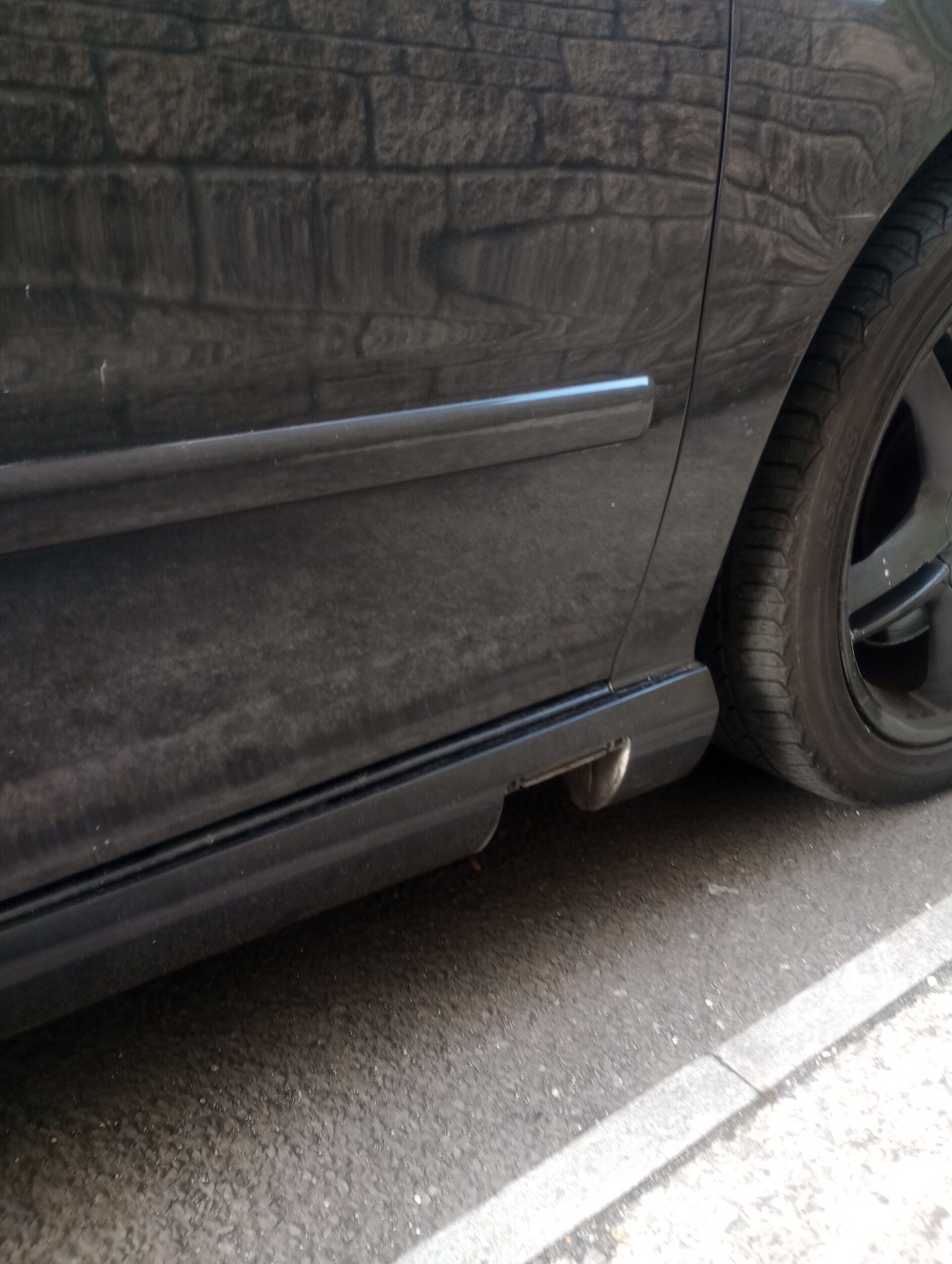

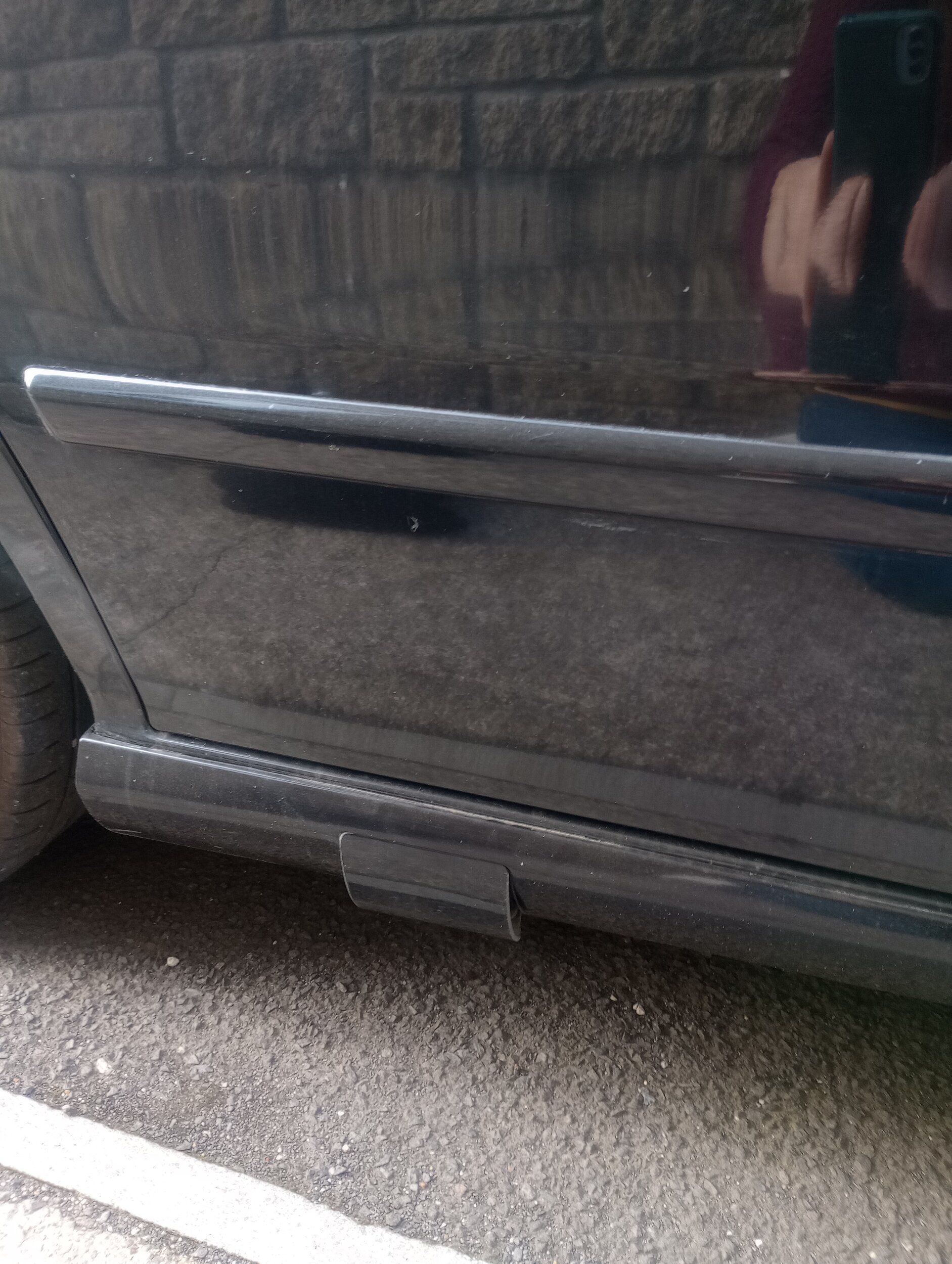

I also had this issue and there was tension on the sideskirt, due to the jacking point on the car being crushed over the years. By trimming the sideskirt, I was able to relieve the tension and the cover clipped in again no issue
Before:
photo_download.gne
photo_download.gne
After
photo_download.gne
photo_download.gne

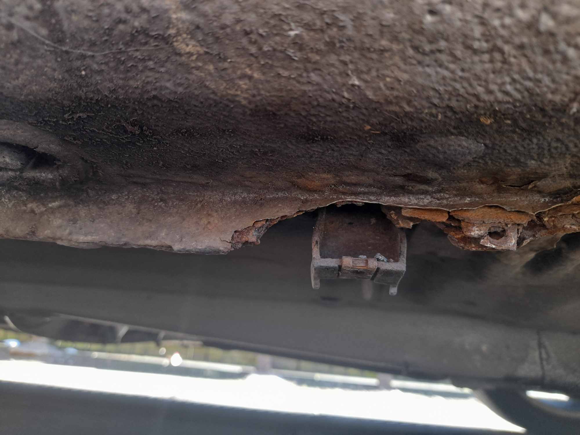

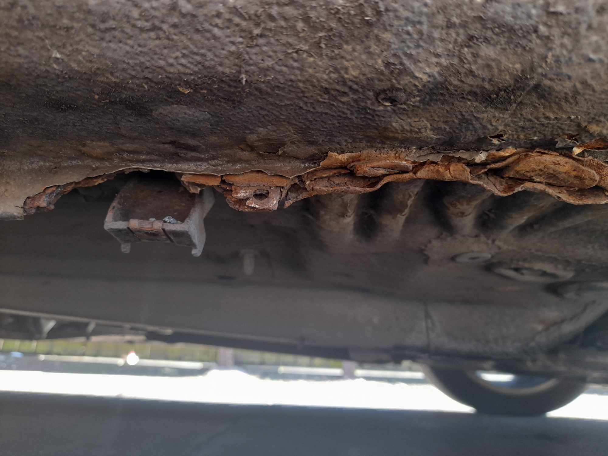

same as mine, jacking point was crushed on both sides, the lip ended up just coming away in my hands so i got the lip fully replaced on both sides and then the skirt sat perfect
that happened to me luck no rust as there was unseal still there but i had to straighten the sill lips then added the old type underseal now the skirt don't look bellowed , told the garage as wasn't happy and do so if they take the wheels off, the gimp who did it is not there now
yeah whenever it needs to go to a garage i tell them not to use the sills now, always use the chassis legs and rear beam, whenever i jack it up myself i drive it my plastic ramps first them use the chassis legs. when i got the sill lips fixed i wire brushed all surface rust and used vactan rust treatment on the whole underneath then when that dried i used dinitrol underseal and touch wood its been good since, 3 mot's with no advisories so far since then.

it is a lift point but they don't use the correct lift puck as they have a V in the middle , you can buy them for your jack at home made of hard rubber and you will have no problem i did have the old style ramps but the hit the bumpers on newer cars and there is hydraulic ramps but dam expensive but verygood , heard good things about dinitrol but i just use the waxoil underseal as it still stops the problem as some of the rust treatment can easy wash off and need doing every year
the plastic ramps are good, they have a more gradual incline so easier to get the car up, might be a problem with front splitters though. i do have some of the v shaped rubbers for my axle stands, will need to get a couple for my jacks.

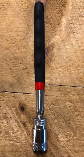

a good long magnet is a godsend for that type of thing, when i did my thermostat i had to go fishing for about an hour to find the bolt, eventually got it from the bottom on a small ledge just above the sump, just had to randomly poke it around until it hooked something, ended up pulling out a random 8mm nut too, god knows were that came from but it was rusty so had been there a while.

I just can't work it out. I dug about with my magnet on a stick, got my endoscope in there too, even tried the old trick of ordering new bolts, because you always find it when you've paid out for new ones. Nothing. It doesn't make sense.
your not wrong lol ive even got one of the cheap extendable ones with a light on the end
