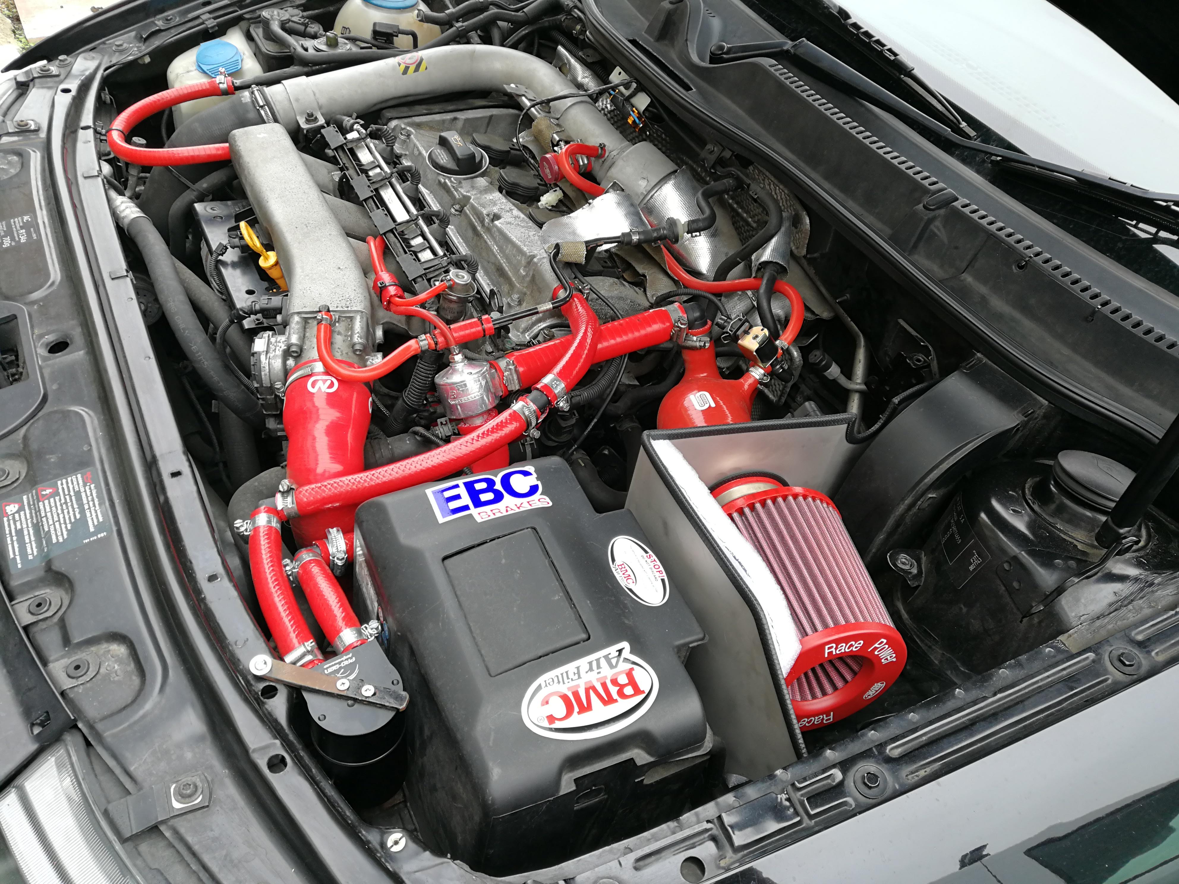

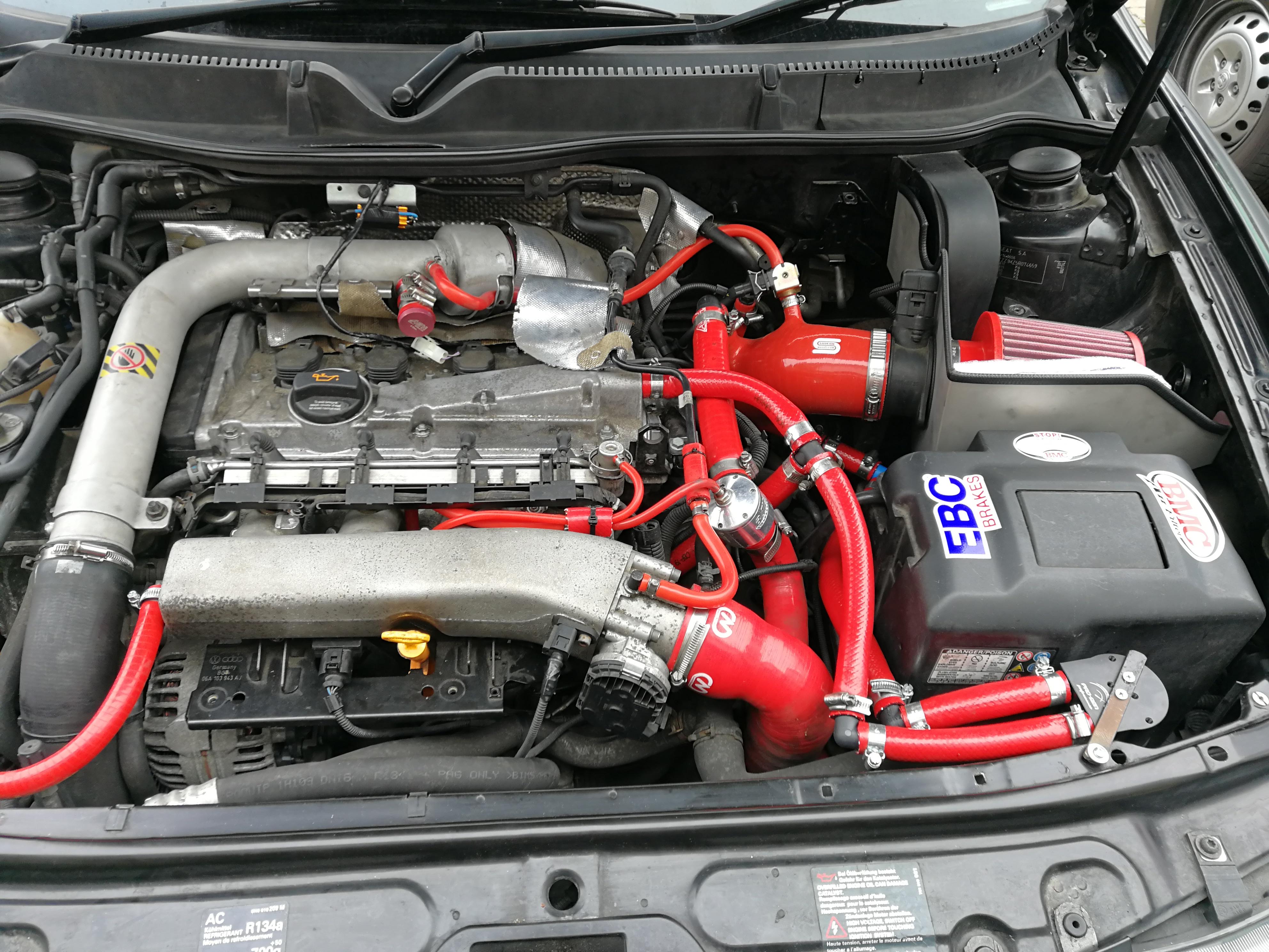

Realised the coolant leak isn't from the temp sender. Held my breath and checked the dip stick and oil filler cap... oil looks normal. Then after another glance around the engine I noticed loads of dried on coolant down the back on the manifold/exhaust so hopefully a loose/split pipe to replace.
Found the source of my coolant leak, the 4” hose that joins on the top of the engine block. Used a piece of silicon vac hose for now until I get a replacement.
