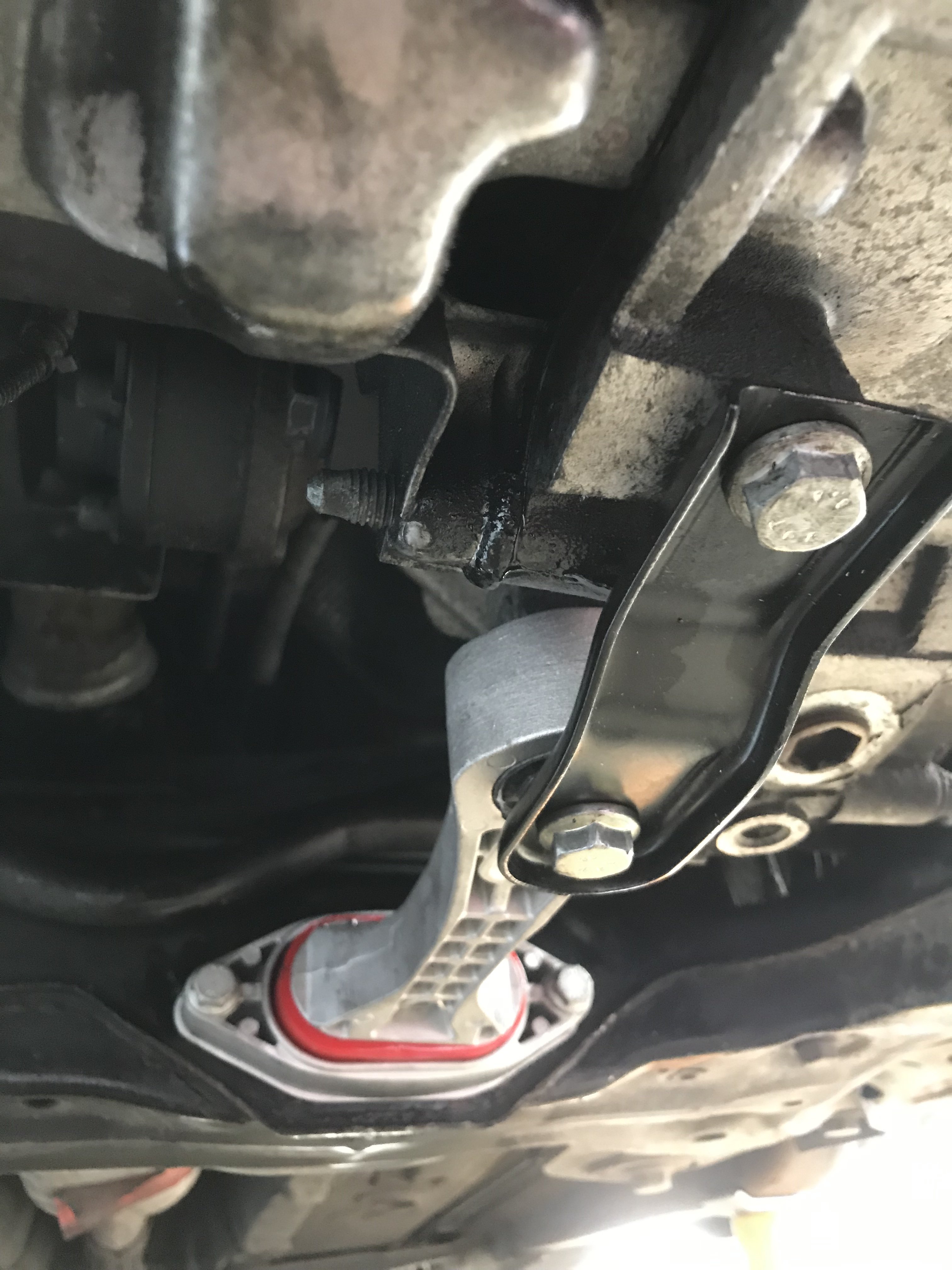

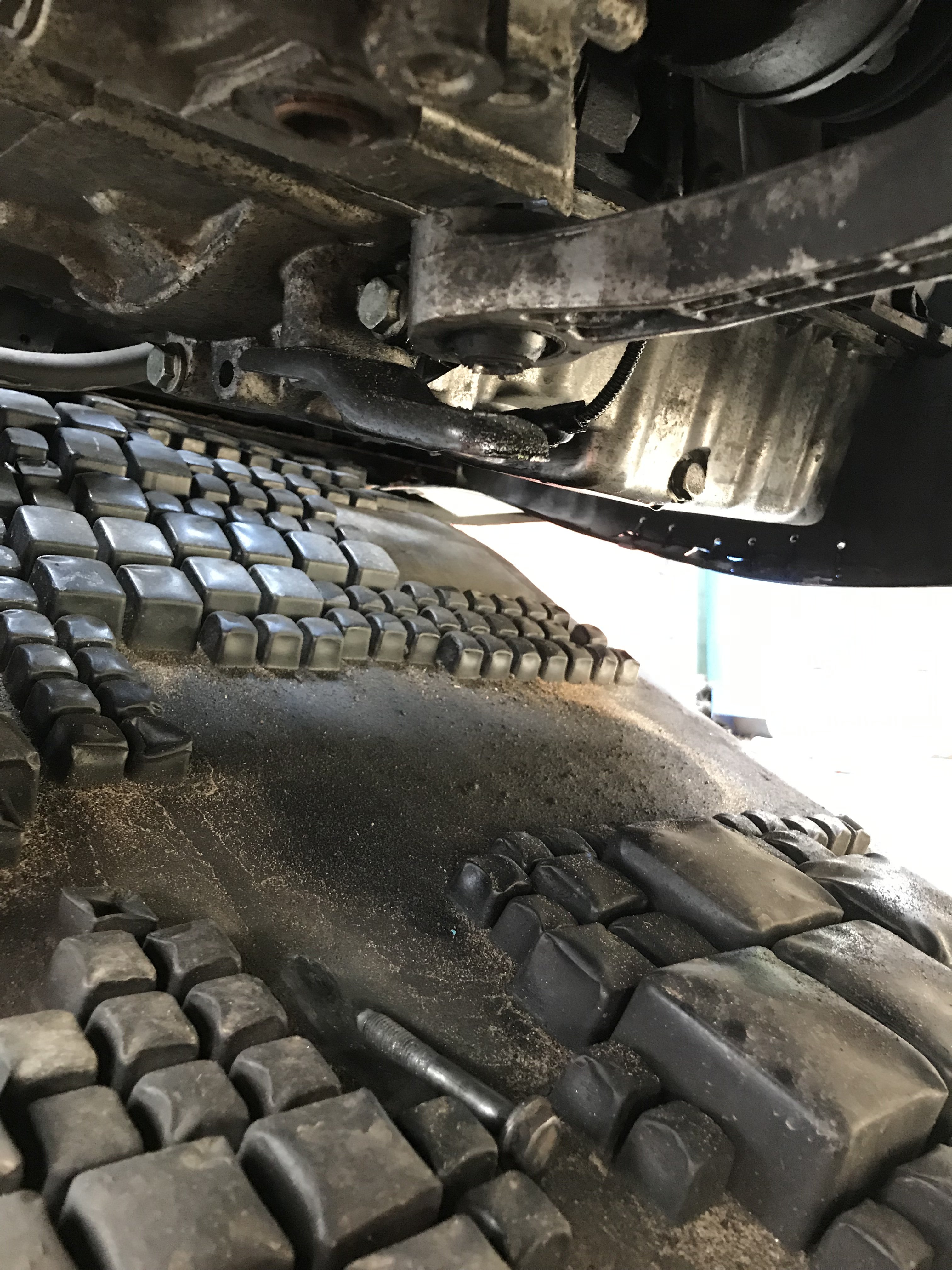

Went to put my brembo pads and discs on only to realise I’ve no 7mm Allen for the callipers (so ordered one for tomorrow). Decided to swap my dogbone with the new one with powerflex bushes and found it wasn’t attached! See bolt on undertray
Then managed to shear off one of the bolts that held it to subframe. Couldn’t shift it so let some WD40 soak on it while I had a sulk. Came back and prised it out with a chisel and hammer and then got the sheared bolt off too (phew).

View attachment 6156 View attachment 6158 Went to put my brembo pads and discs on only to realise I’ve no 7mm Allen for the callipers (so ordered one for tomorrow). Decided to swap my dogbone with the new one with powerflex bushes and found it wasn’t attached! See bolt on undertray
Those two 13mm bolts into the subframe nearly always snap.
The problem lies in the difference in metals of the actual dogbone mount and the bolt, not the threaded section inside the subframe.
The alloy corrodes and binds up around the bolts and obviously when you assert pressure on them with a socket they shear off as they're stretch bolts which have already been stretched to yielding point.
As you found once the mount is prised off of the remaining bolt stub you can almost always unwind it by hand from the subframe.

Bang on. I used some mole grips to turn it once or twice (think the corrosion was holding it) then I turned the rest out by hand.
