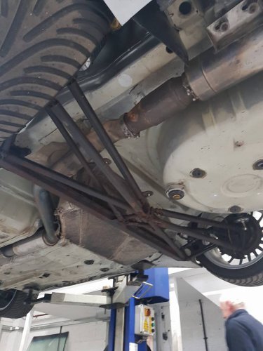

Can some one explain how this would give more control. If you got shorter shocks then yes they can fall out but if you have a proper set up then they won't fall out.
As for being a coil over on a beam axle i can't really see the benefits of it . You get adjustable platforms with your springs in the normal set up and a helper spring too.
It won't change the adjustability of it all
I am just lost on why the extra work for the little if any benefits
Yes I hold my hands up....I wasn't thinking about that beam for a second. That still there it's pretty pointless...springs where they are are the best place, more thinking leads me to think the weight of that bar and the springs being moved is going to change to weight distribution (bar becomes dead weight sat there) I know it's still supported but distribution of weight must play with the back end
Again I hold my hands up, I was very wrong.

When I went to gaz to order my shocks and springs I did ask about a coil over set up for the rear. No going to mention names but the bloke I spoke to asked me why.... why do you want that... and I said well it must be better and the right thing to have lol. His reply did shock me . He said we can make what ever you want . But they for the "benefits " you may get are not worth it. And as no one here is a btcc. Wtcr wtcc or f1 driver we wouldn't fell the difference or he even able to say how it reacts. So I had separate shocks and springs made but got damping and rebound on the rears and mono tube set up on the front with damping control. Only time will tell if there any good... I don't mean gaz as I know they are good as have them on one saxo and AST on the other one
Sent from my Nexus 6 using Tapatalk
It's not about being right or wrong lol. What you said is all true. For independent suspension. I was just going down the route of my saxo. That is beam and torsion bar set up. But there is a bloke who builds an independent set up. So was going to see the cost of some thing like this for the leon
I was trying to think about what the hell is everyone talking about a beam in the rear... then I remember I am 1 of 2 guys on here with 4x4 ... we don’t have a beam... differences below top one is 4x4

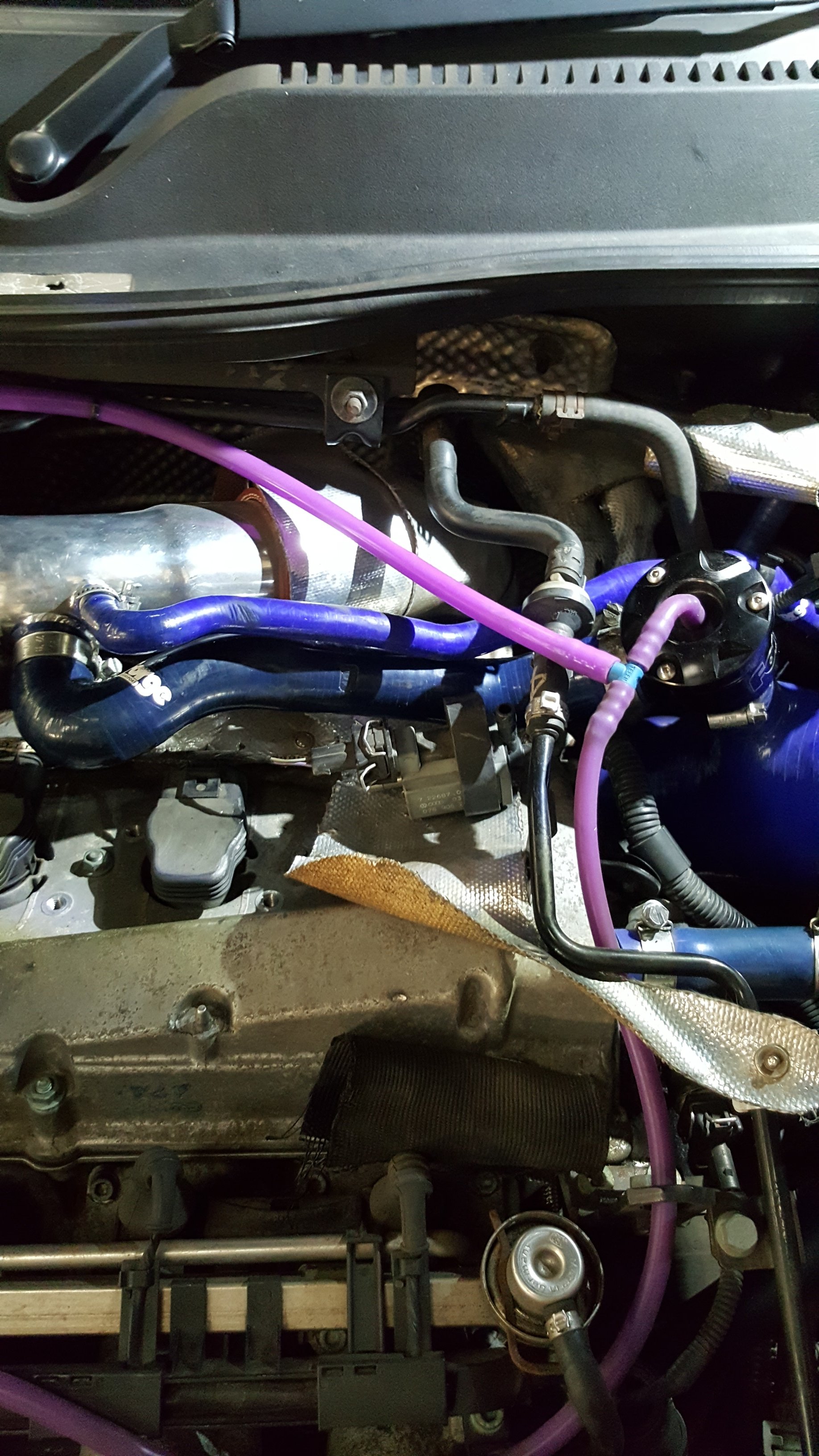

Pulled the sump ad some idiot had fitted the rocker cover gasket with a whole tube of sealant. So was scared about my pick up pipe being full of sealant. Turns out I was right!!
When re fitting the sump had 2 fixings go slack and I think the threads in the black are fookd. One in the rear corner driver side tightened to 12nm not 15nm. The other which happens so be hardest one to get to is shot. Looks like gearbox our to re tap as it’s right up next to bell housing. The gasket maker should keep the seal here as 3 other bolts in the location surrounding to attach sump.
Tomorrow night an donnington will tell.
