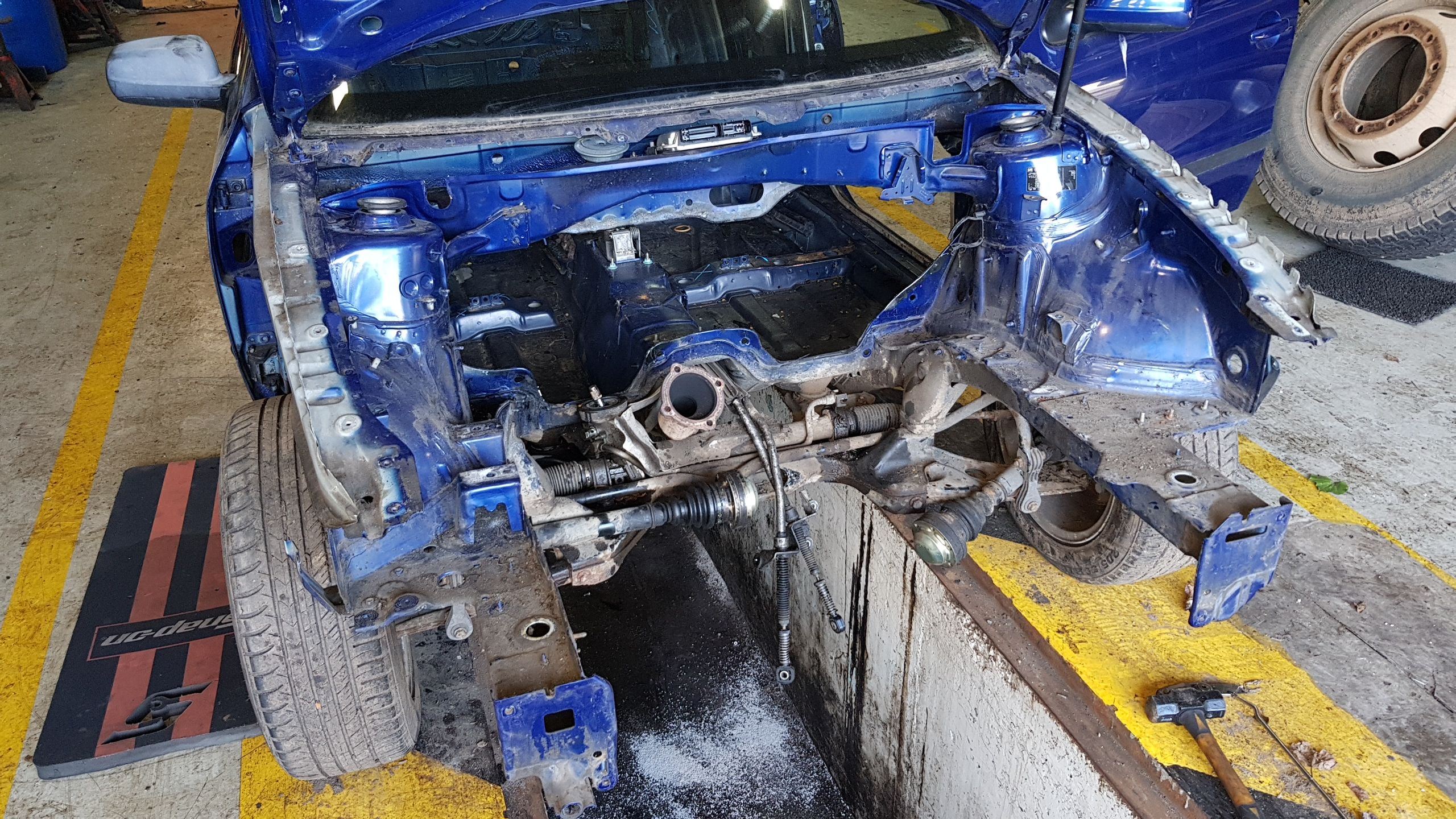

I see I’m not the only one with turbo problems.
I see an oil leak and a cross threaded bolt?
Definitely a leak somewhere mate. No not threaded just put it by a complete moron. Problem was pipe needed to be pulled down slightly and then the bolt went in nicely.

I’m in and around this area over weekend looking for oil leaks myself so if I find anything above turbo it could be il let you know. there is an oil line think it’s high pressure one could be that ??
Reactions: Andrewwright
I took all the top pipework of yesterday mate, dry as a bone. Definitely coming from the bottom somewhere. I cleaned the area yesterday and I'll be out there later today to have a look underneath it to see where it's coming from. I think it's coming from the center "join" so to speak on the cold side of the turbo. Hot side, front of the block,sump all seemed fine but there was too much oil everywhere to say for sure.

Had it back up, covered in oil again coming from the cold side of the turbo on the inside. Took the intake all off and it has shaft play in and out 2/3mm so she done. No movement up and down. Looking at a replacement turbo now. Maybe just the core, also dropped the oil out of it and replaced with some 60% off from euro 5-40 fs. Cheap enough at £17 for 5L
