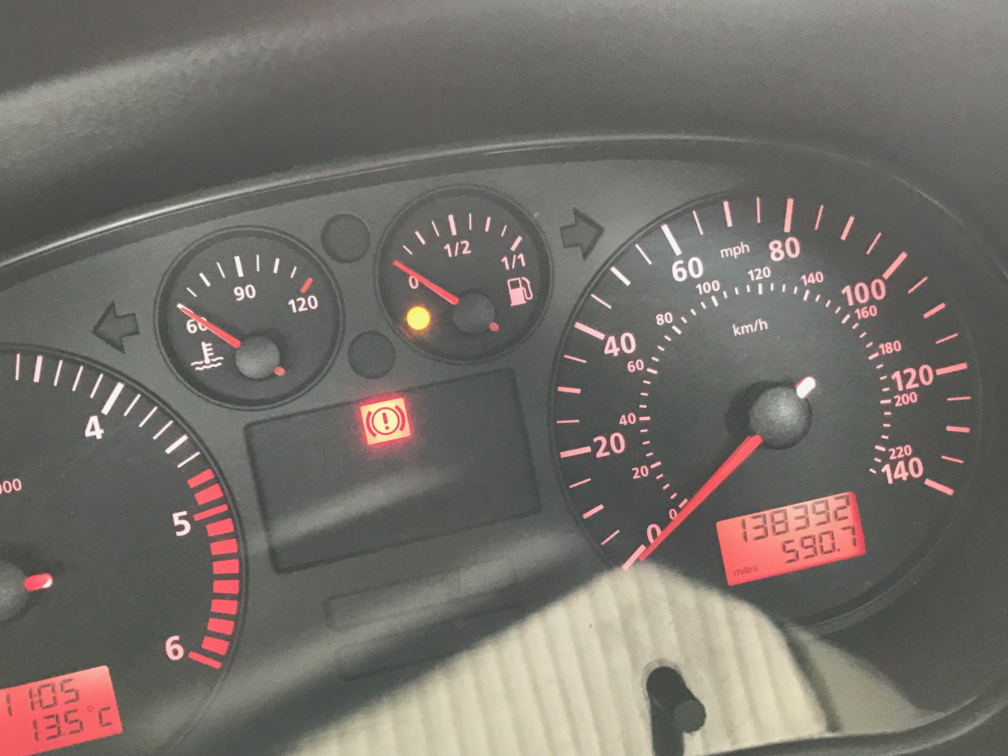

Coolant light back on...
So that's new rad, new expansion tank ruled out.
Noticed the level drops after 'spirited' driving much quicker than pootling around. Does this sound like anything in particular?

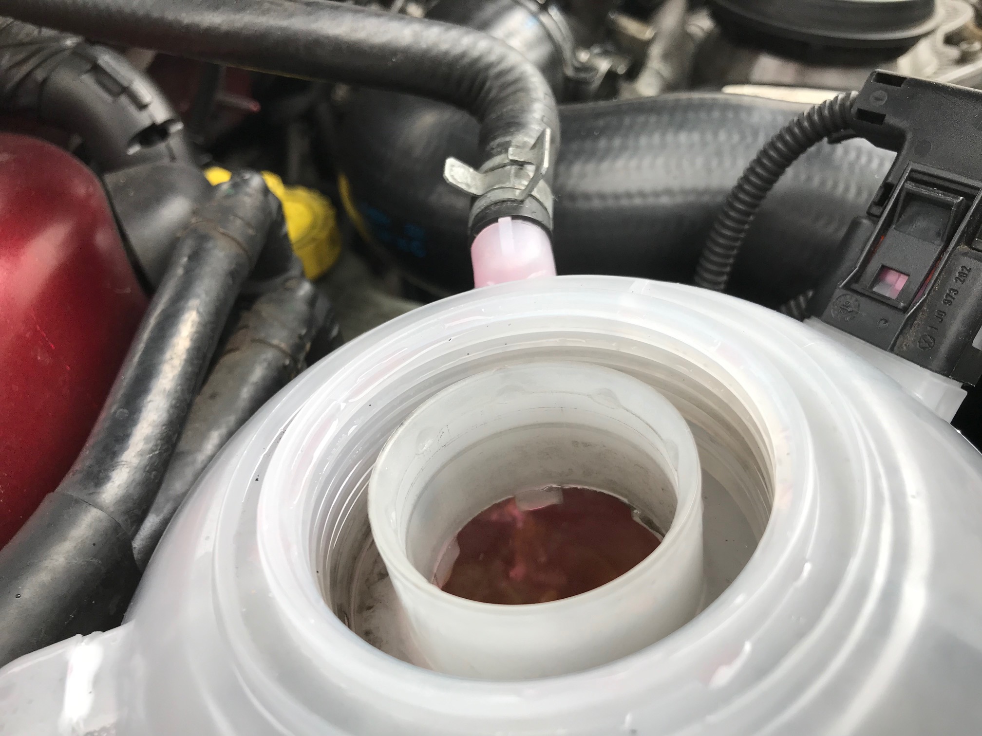

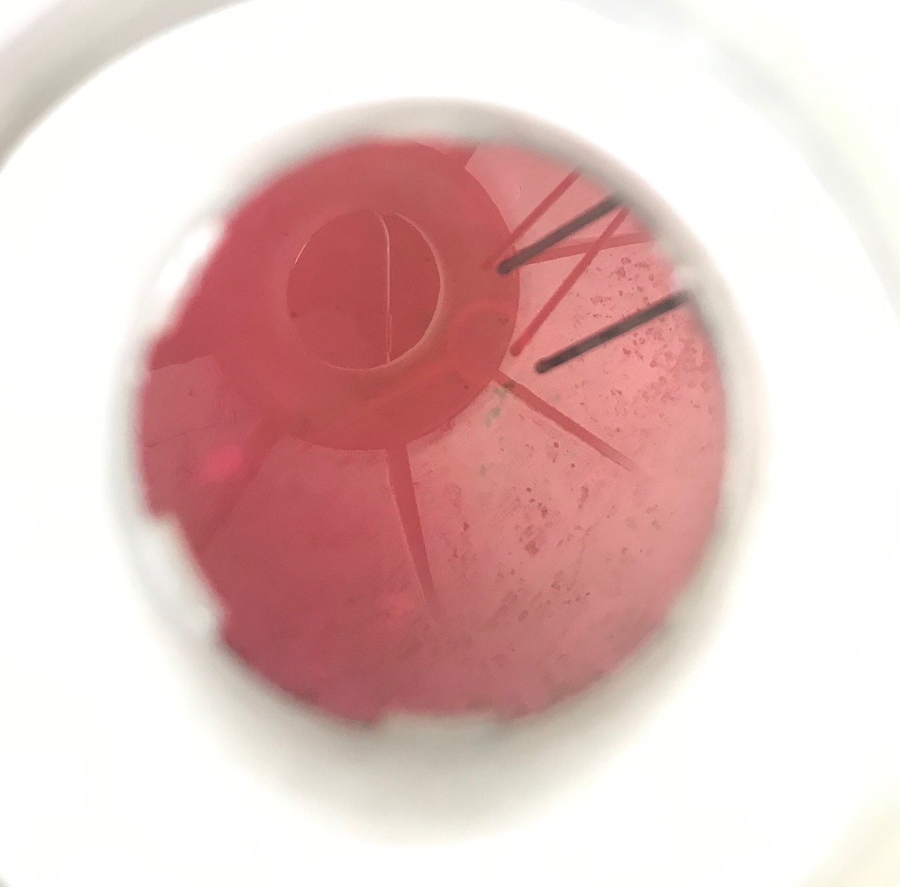

Had a look around for possible causes of coolant loss. Felt round all hoses, felt dry, no coolant crust visible. Temp sender was seated nicely, again bone dry. When I opened cap there was a whoosh and the level rose back a fair bit. Noticed a few black specks in the new bottle (bits of inner hose? Old radiator?)

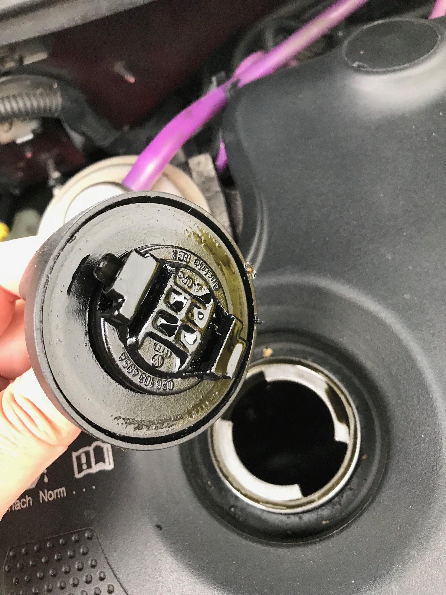

Checked oil filler cap, all good, no signs of milkiness

Coolant constantly flowing back in from top of reservoir too, so I’m guessing no blockages either.
