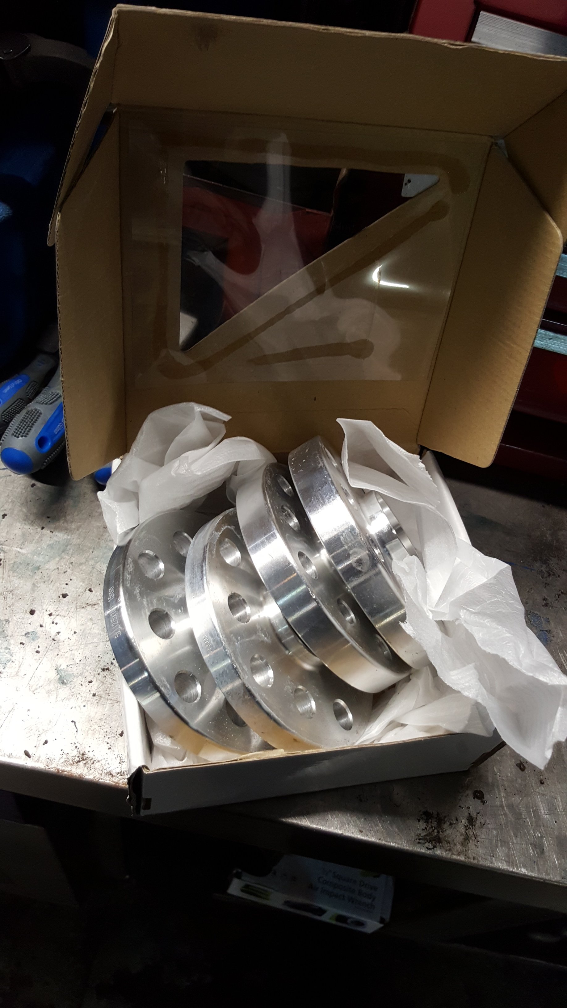

Going to have 20s on the rear and 15s on the front so hopefully not. Goin to fit them when i do my dust seal replacement and new arms.
