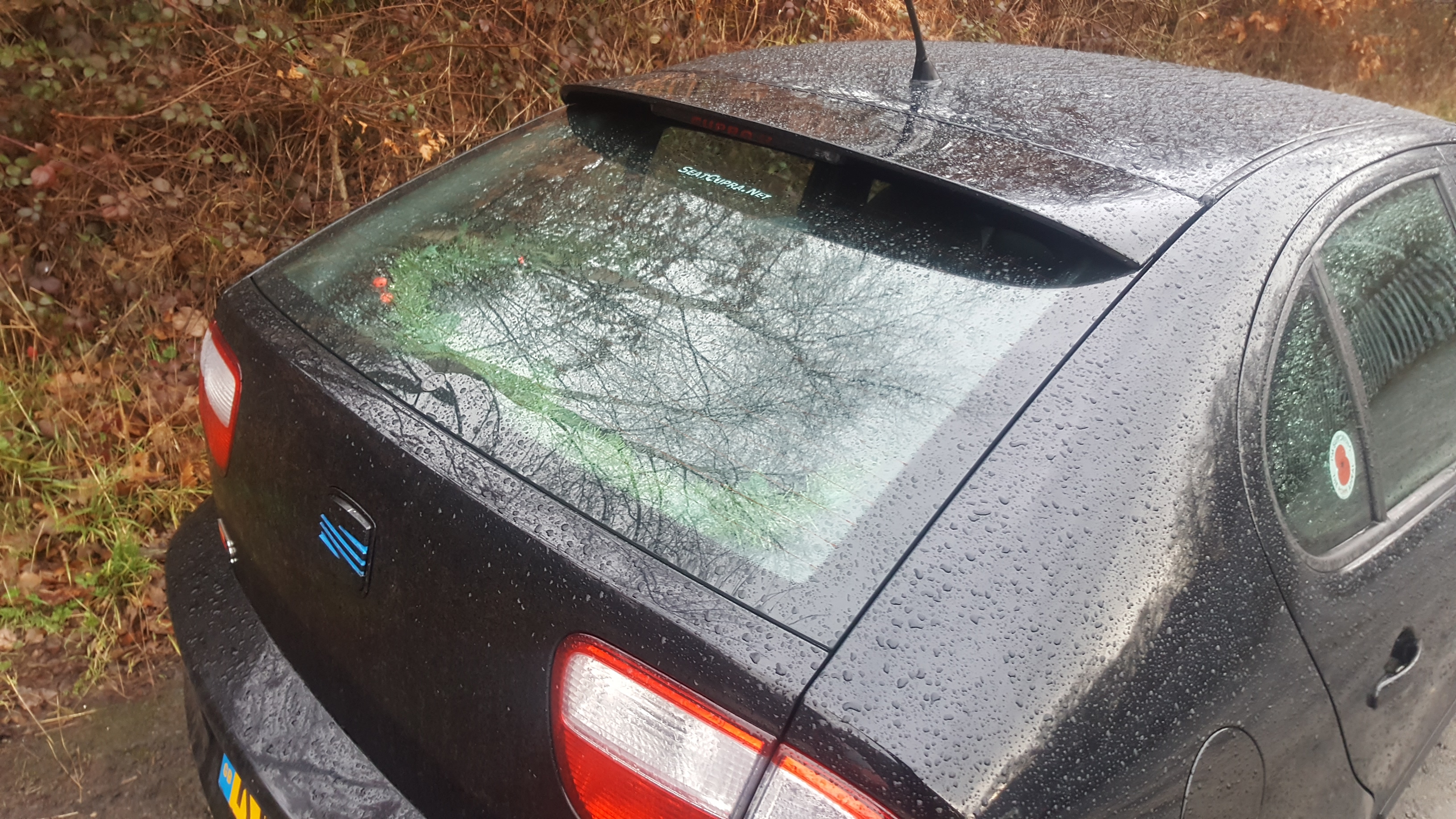

It looks brilliant mate. Who done the wrap. I had a go at a roof and all I can say is I went for the wrinkly effect lol. It's a lot harder then it looks. And also you need the good stuff to start with
Thanks. I did myself over the weekend. Wrapped my brothers car also actually. But your right, you got to start with the right stuff to begin with. and since its my job its cheaper for me to wrap the whole car as painting just some sideskirts and doorguards. So that and mismatching color bumpers made me decide to wrap it. Ibhope to finish wrapping the sideskirts tonight so i can finally fit them. Think its actually the last cupra r part i need.

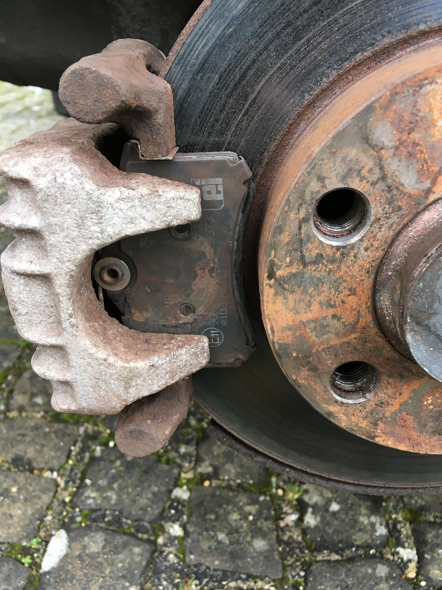

Finally got round to checking on the rear brake caliper. I mentioned here a few months ago that the pedal was hard and the offside rear disc wasn't being cleared while the others were.
Took everything apart and cleaned it all up using brake cleaner. I thought that it might be the pins that had seized and the pads weren't returning, but they were smooth and clean. Wound back the caliper for good measure. Took the disc off as well and noticed that there was a mark on both sides from where the handbrake had obviously been left on for a good while, so cleaned that off as best as I could. Put it all back together again and turned the engine over and pumped the brakes, and everything felt smooth, with maybe a little more travel on the pedal than before, but none of the hardness I was getting.
Haven't done a road test yet, but will probably pop out in a little while and go round the block.
Hard to believe I replaced this caliper in January. The state of it...
Brake test went fine, but it's only clearing the outer 2/3 of the disc. I'm starting to think that when the caliper seized, it caused uneven wear on the pads. When I got a new caliper, I didn't replace the pads, so that might be the root of the problem. When I took the pads off, I could feel that the inner edge (the bit closest to the hub) was more worn than the outer edge.
Say I were to replace the pads, the discs are only about 12-18 months old and I've not done more than 4,000 miles in that time, I'm guessing I could get away with not changing the discs? They look fine, without any pitting or grooves, but I know looks can be deceiving...

If the discs have no grooves and no wobble then you you should be good with new pads, just bed them in nicely
Thanks - new Brembo pads will only cost me £13 from Euros, so I'll pick those up on Friday. It'll give me a chance to jack the car up and check the bearings for play in any case - something else I've been meaning to do.

Do you have the helper springs on the rear calipers?? For £6 it’s well worth the addition and helps return the handbrake arm (have a look on google)
Pretty sure I do - I haven't bought any myself, but if they came as standard, they're still on there. I'll check to make sure tomorrow though - and will probably use first gear/reverse more in future as well to stop it from sticking.
