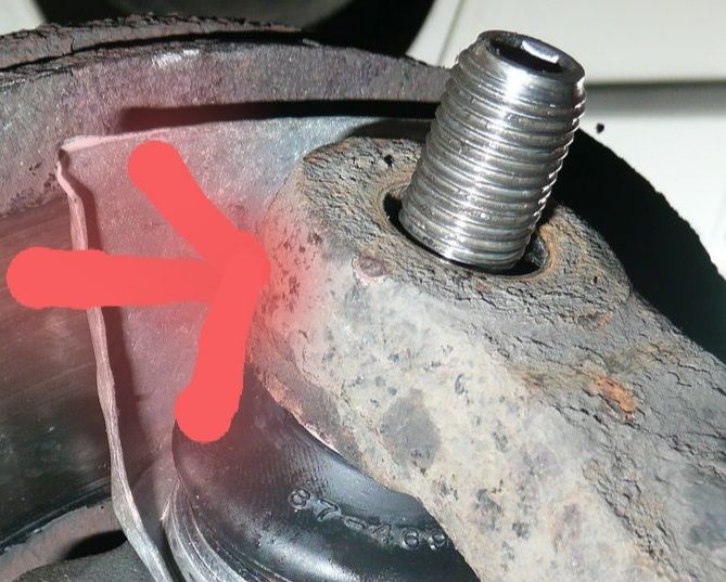

Don't get me started - none of the bolts had been cleaned and there wasn't even a sniff of copper slip. The rear bush bolt made the same kind of noise when that let go too, so they must have got the rattle gun on there super tight. Both the arms are out now though, so I'm going to Hammerite the one that's not new and then get to putting the bushes in. I'm wondering whether it's tempting fate to have a go at the dogbone - I took the undertray off so I could get at the front bolts, so why not...
Having trouble with the ball joints though. I really want to change these, but I'm not sure if I can get these off without undoing the CV bolt, which means I'll need a new one. Is there a way of doing this without having to undo that? I'm guessing I need to get an allen key or something in the top of it?
