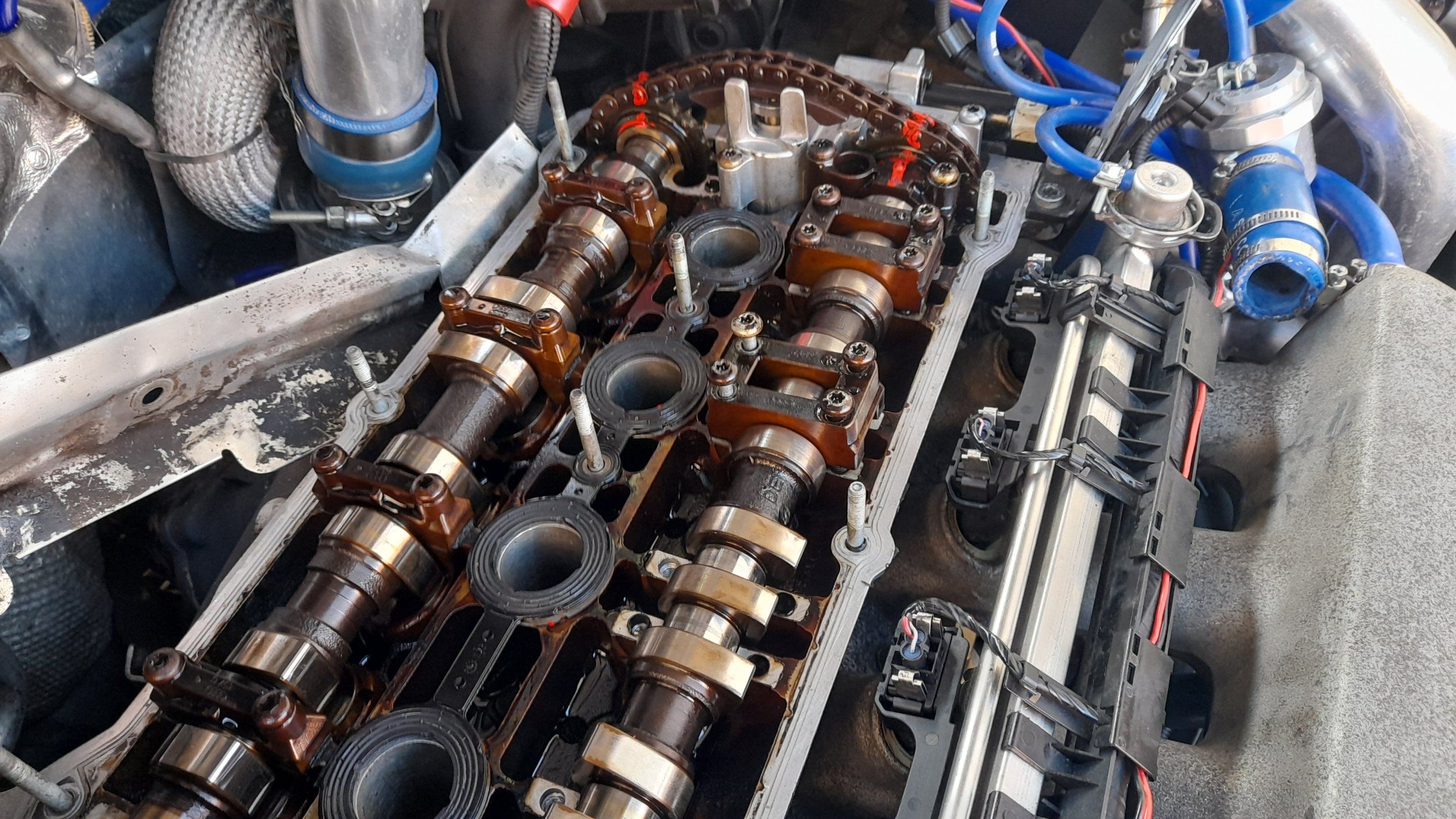

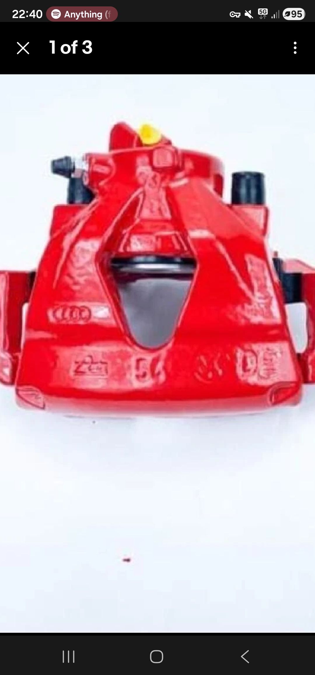

done the chain tensioner today, what a total ballache, got it all done and back together but car wouldnt start after a good 5 mins of cranking, so back apart to check the marks, all timed good, so back together and wouldnt start again, sooooo back apart, double and triple checked the 16 links and put back together, i ran my battery out and a booster pack trying to start it, eventually on the 2nd booster pack it started, ran like **** for 5 mins then sorted itself out, phewwww thank f*ckkkkk.

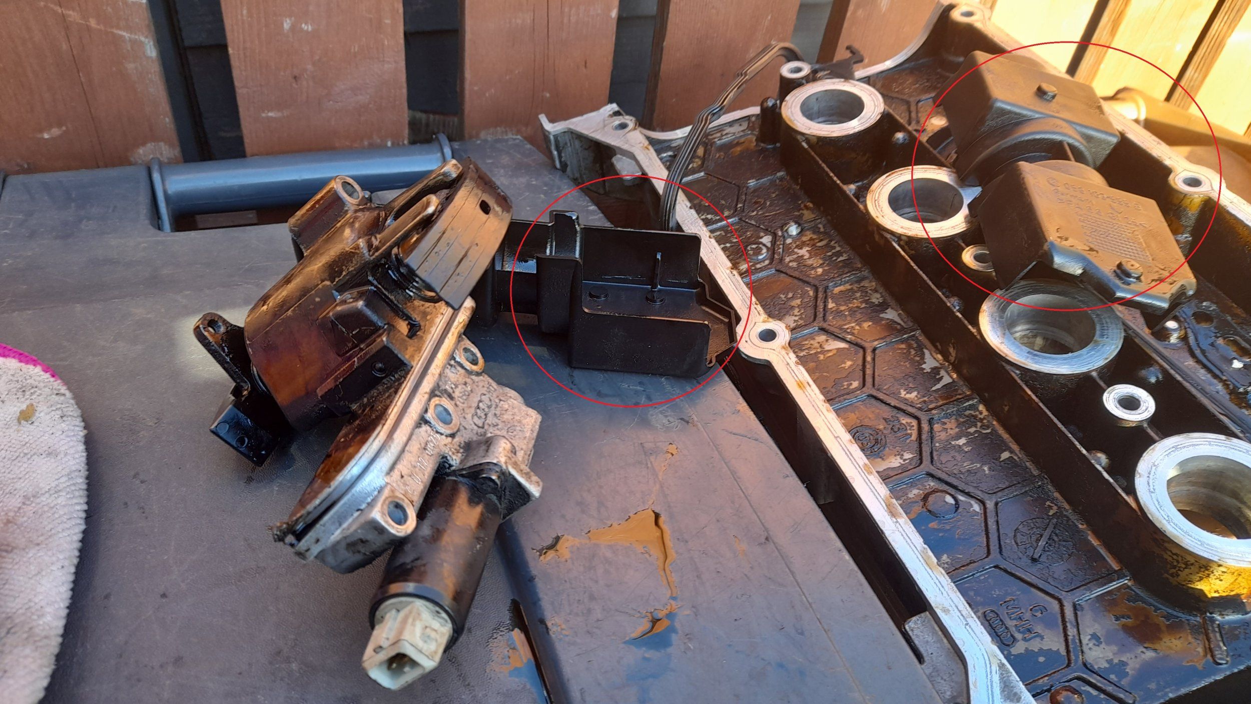

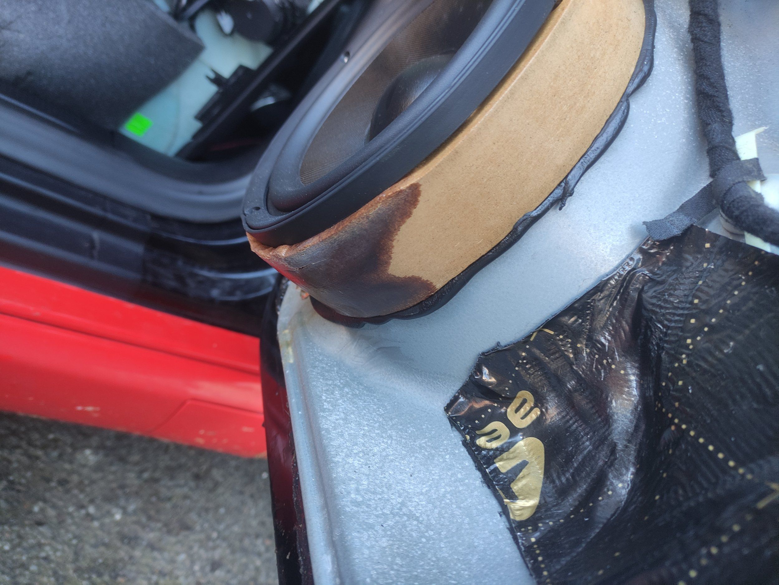

in my annoyance to get it done i forgot to put these black plastic covers back (circled in the pics) do they make much difference, can i just leave them out or do they need to go back.
and before anyone says thats loads of red paint, thats not paint, thats my blood sweat and tears :LOL:
thought red paint were markers lol
  • Haha
Reactions: ExiledWeegie
it is paint lol
i think it took so long to crank over and start because it couldnt build oil pressure quick enough, most likely a partially blocked oil pickup? so guess what job im going to be doing over the next few days :rolleyes:

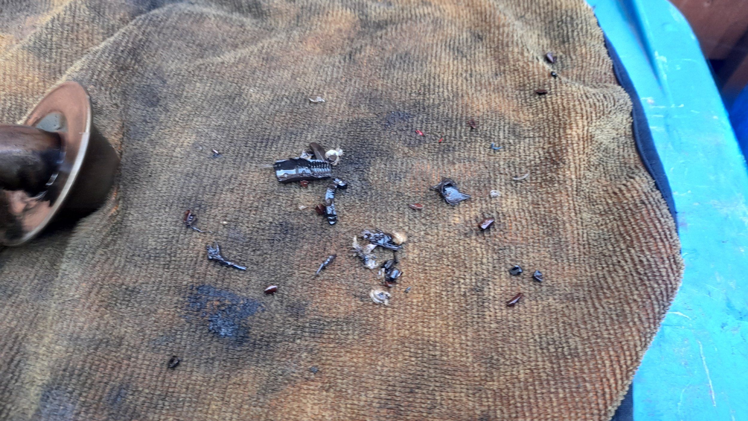

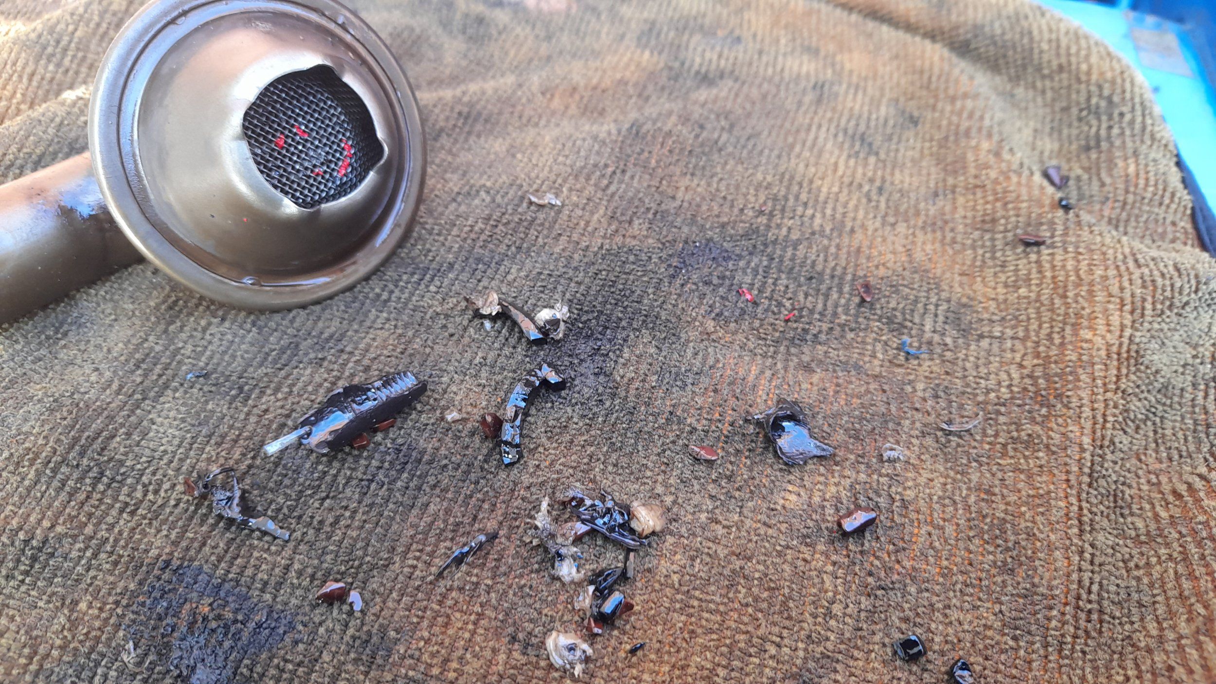

dropped the sump today to change the oil pickup, been getting a slight rattle on cold startups even after changing the chain tensioner to a new gates part, this is the crap that came out of the old pickup, there was still small bits and some red silicone that i couldnt get out. this might be the reason for the oil not getting to the tensioner quick enough in the mornings? will find out tomorrow when i fill her with oil once the sealant sets on the sump

Yeah looks like old dipstick pieces to me as well. You only have to remove the dipstick when it's old and the plastic rings crumble and fall down the tube.
I'd replace the stick and the orange holder
The red might from the Dirko rocker cover sealant if you've had it redone.
yeah the old dipstick was breaking up when i got the car so i bought a new one, looks like theres bits of the old one, some black silicone sealant, bits of the old pcv elbow too, the red i think is the paint i used to mark the cams the more i think about it. hopefully this stops the tensioner rattle now.
Yeah looks like old dipstick pieces to me. You only have to remove the dipstick when it's old and the plastic rings crumble and fall down the tube.
Possibly a stupid question, but can you do that with oil in the car, or is this something I'm going to have to do when I change the oil?
Sorry to jump on the conversation, but my dipstick is getting old and brittle (I hear it happens to us all as we get older - the car, I mean, not me...) and a bit broke off not long ago. Can you get new ones?
Looking at that pickup, I know that's another job I'm probably going to have to do. That's going to be fun.
if you mean just the dipstick and tube then yeah you can do it anytime you want without draining, if you want to clean or replace the oil pickup then you need to drain the oil to drop the sump off the car, then remove the pickup, clean all the sump joining surfaces and on the block and reseal it with rtv, most people do it on these cars a preventative measure because of the dipstick, pcv and sludge blocking the pickup, i did it because of the tensioner rattle and thinking it wasnt building oil pressure quick enough , time will tell on that, takes 24hrs for sealant to dry before i can put oil in and start it up.

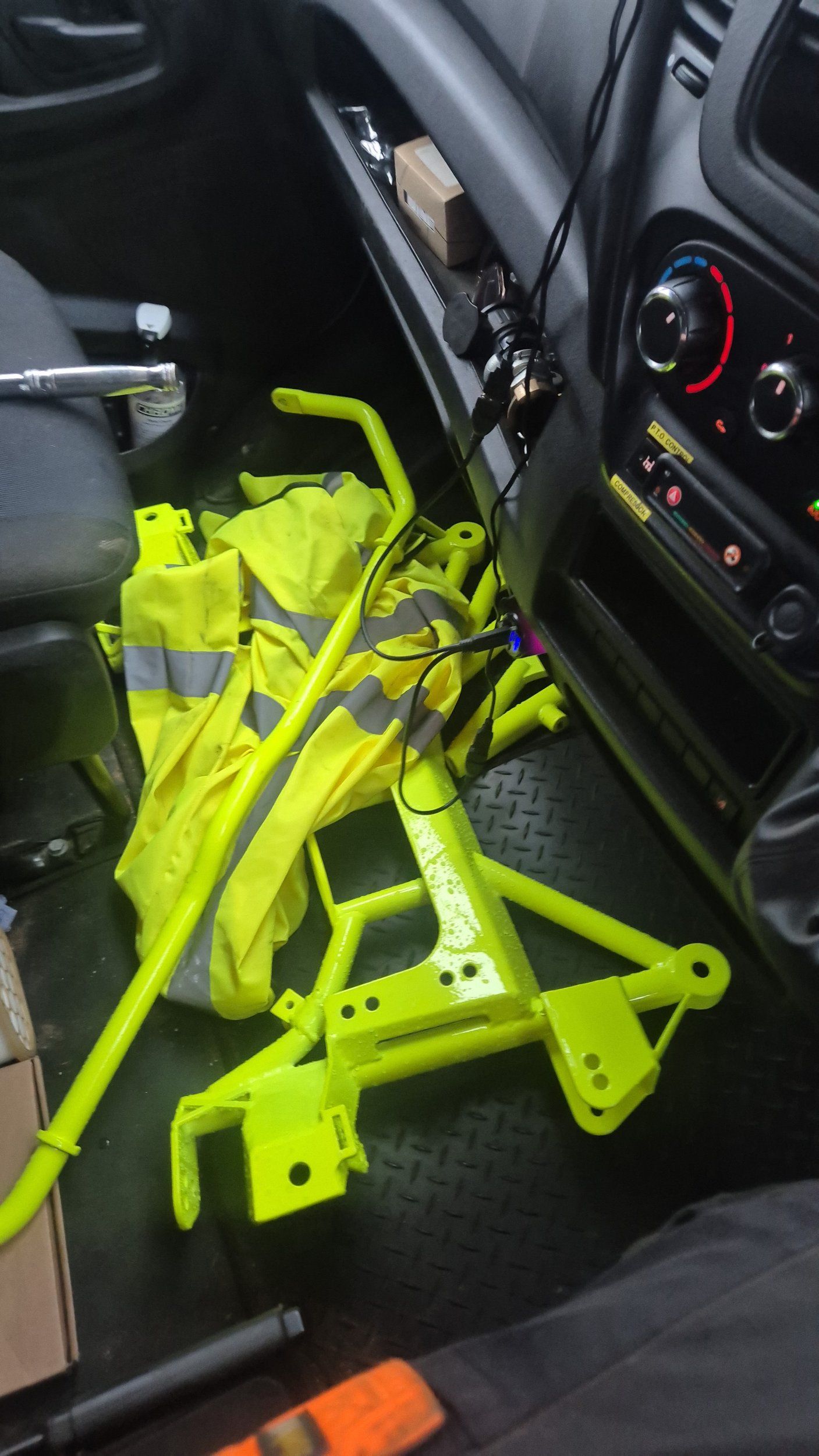

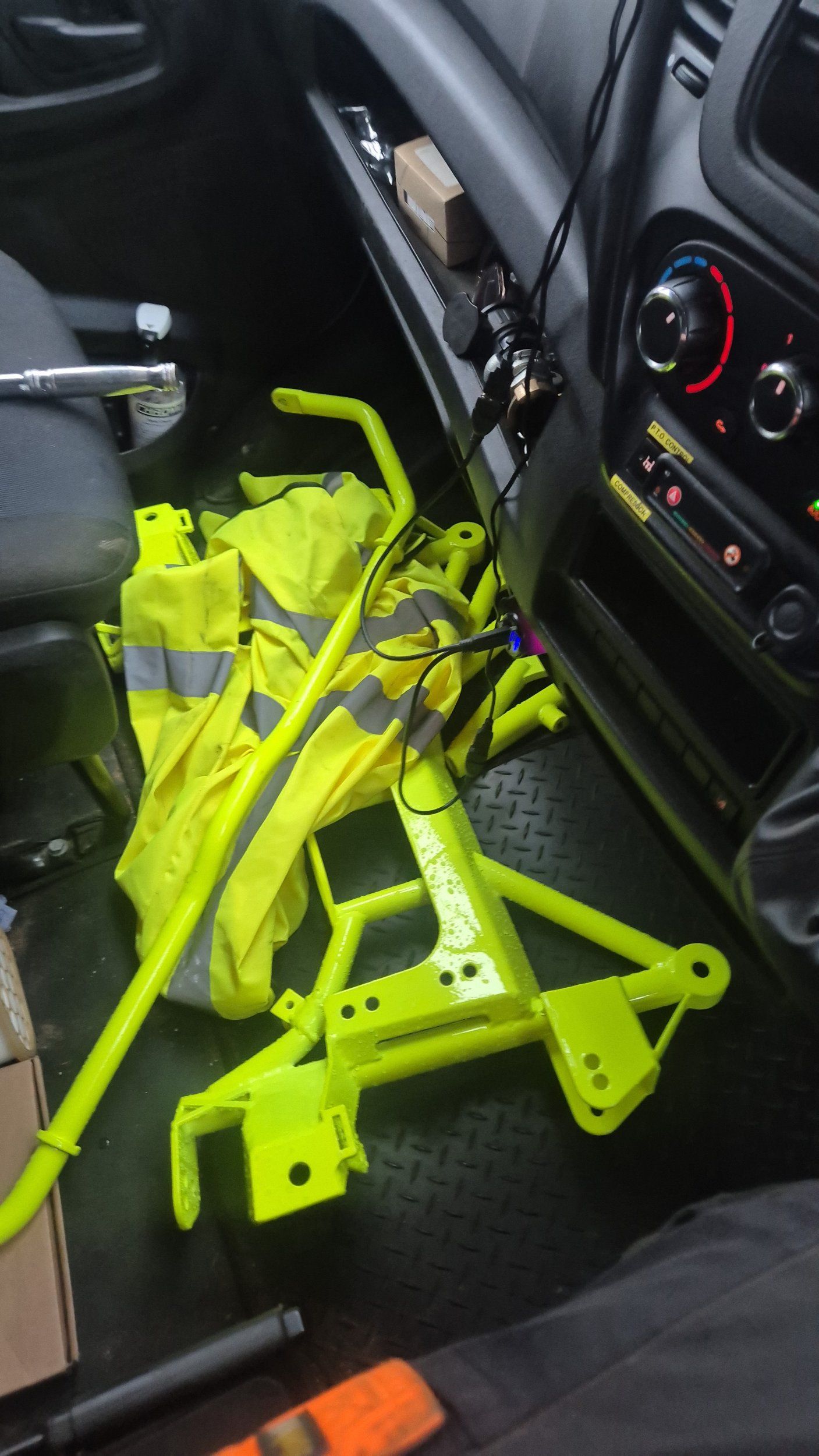

Not sure if I have shown this or not.. sorry about lack of updates... nothing to update really. Just working and home life.
But had the front subframe powder coated.
Was thinking if its silver, grey, or black etc and I get a crack it would be hard to see but.. make it a bright colour I would see and damage and cracks.
So I went for a bright colour..
Also had the front anti roll bar done too.
Just got some welding on the rear axle as I have changed to coil overs. Then that's getting done too.
So I went for a bright colour..View attachment 52661
I really like that, will give the black some added attitude. 👍
