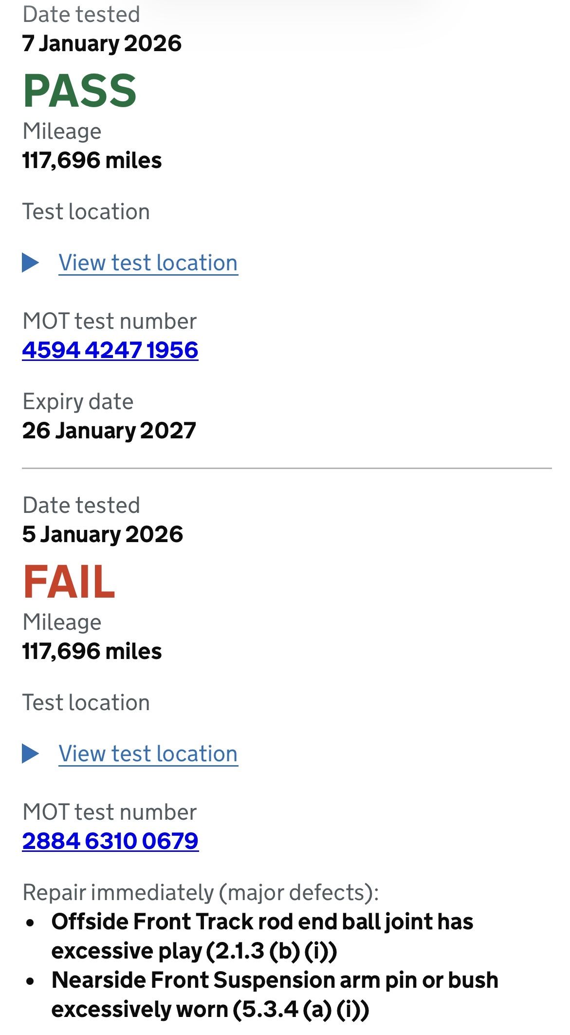

The ride has massively improved after sorting these two issues for its MoT. Didn't realise how crashy it had become.
Also zero advisories, which is a first.
