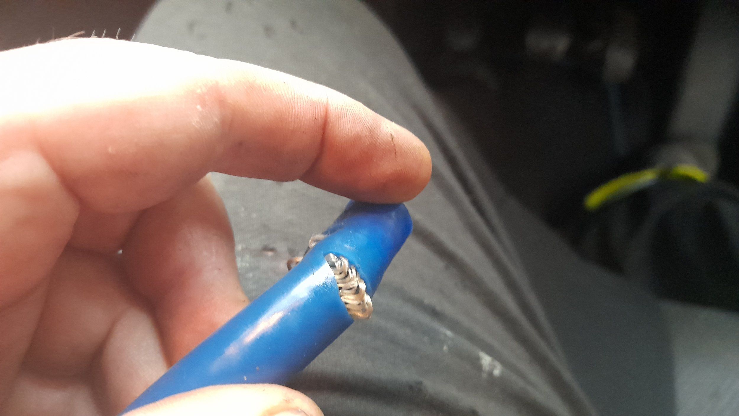

funny you quoting me in this the now, since i done the pickup pipe job my long term fuel trims have been creeping up, usually they are +-2% but mostly sit at 0.0% so perfect, but have been seeing -7% after the sump off job, have been picking my brains thinking ive not sealed the sump right so might be a vacuum leak but theres no oil getting out, thought maybe id disturbed something but nothing down there that i could see.
today with a break in the weather i found this on the back side of the n75, so its been a boost leak just by coincidence its happened when ive done the last job even though i wasnt near the n75. these cars eh... :D
