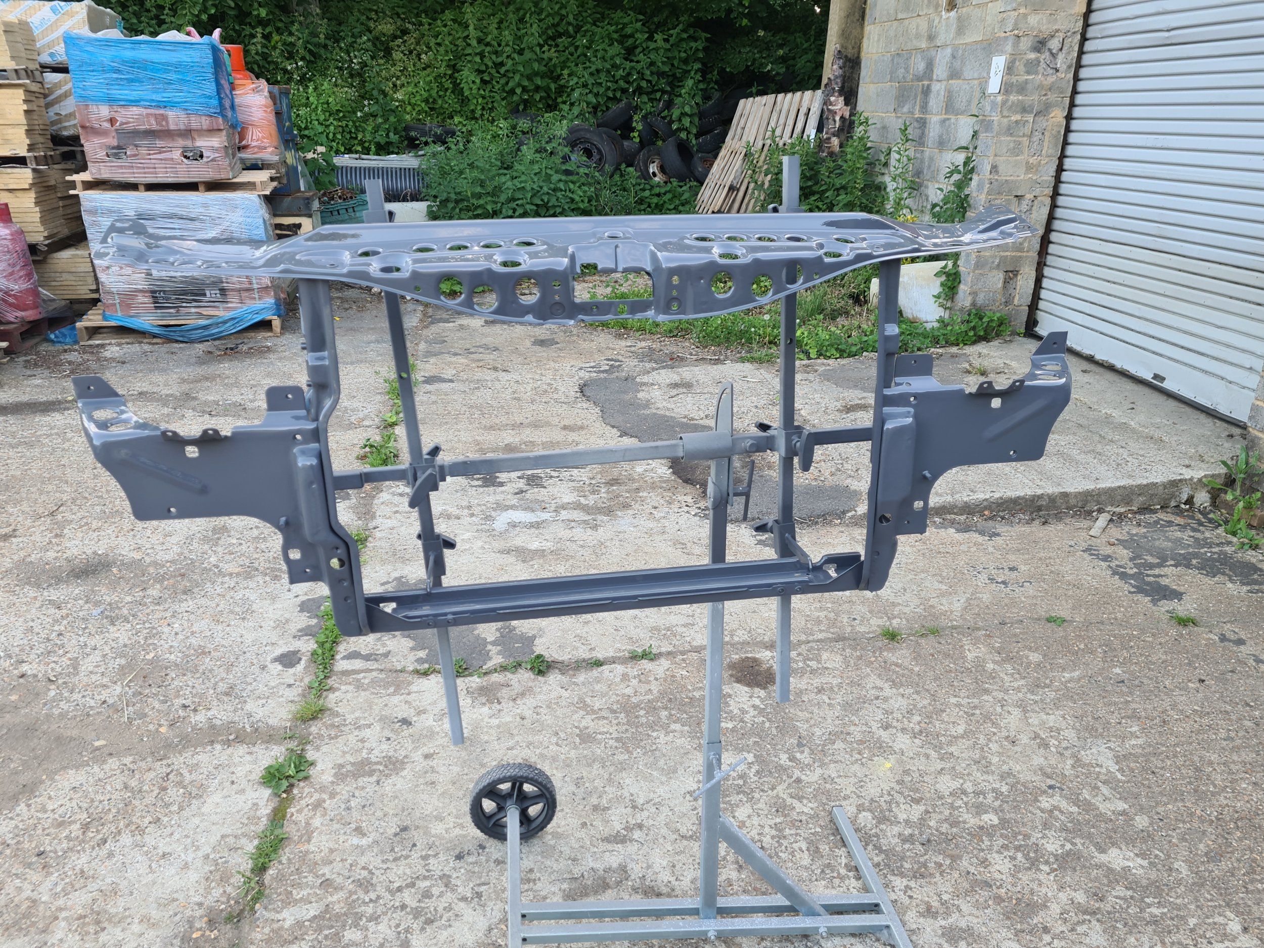

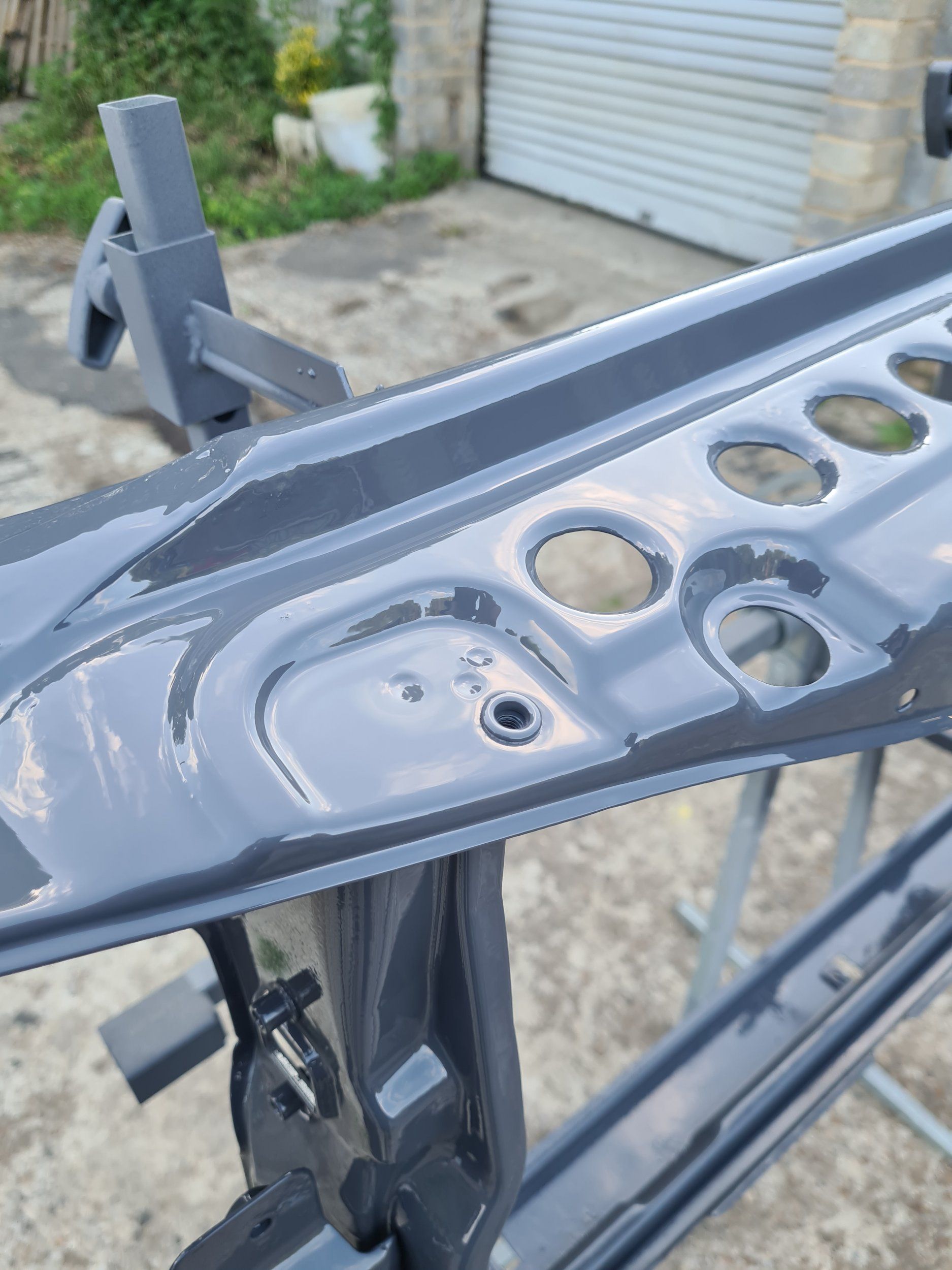

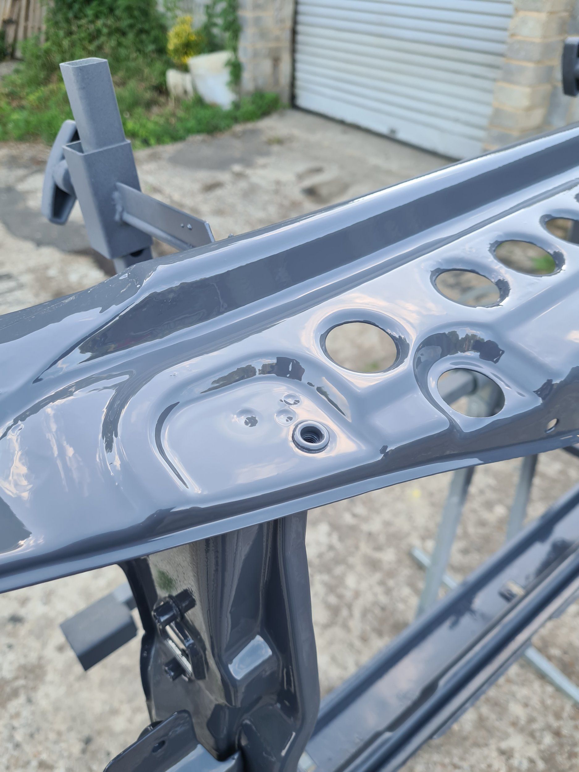

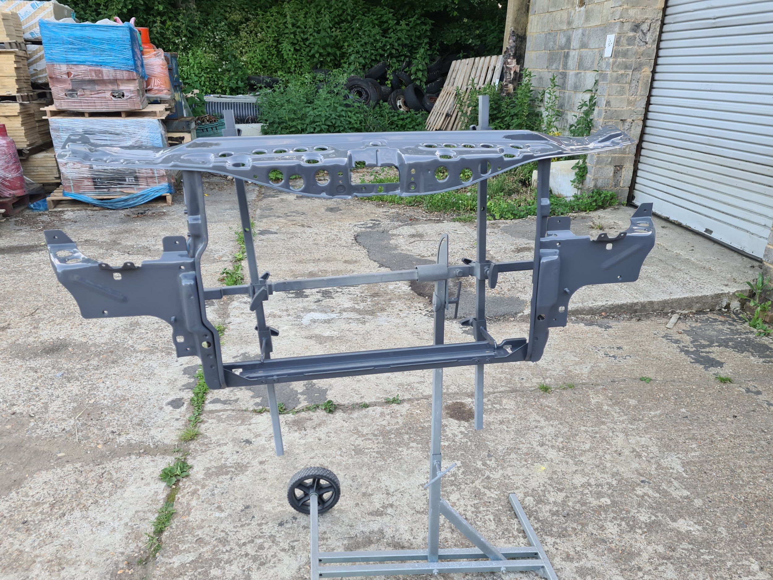

I got all in the race car mood from watching btcc , so went to the yard. From having to do modifications to the front panel I thought I would respray that. So gave it a sand down and scotchbrite . Cleaned it and gave it a 1 over with paint. View attachment 25223
Didn't come out to bad... even a bit shiney tooView attachment 25224
So that's now drying . So tomorrow after work I should be able to rebuild the front end 9f the thing so there's less stuff laying about the workshop. As we know stuff either goes missing some how. Or gets broken

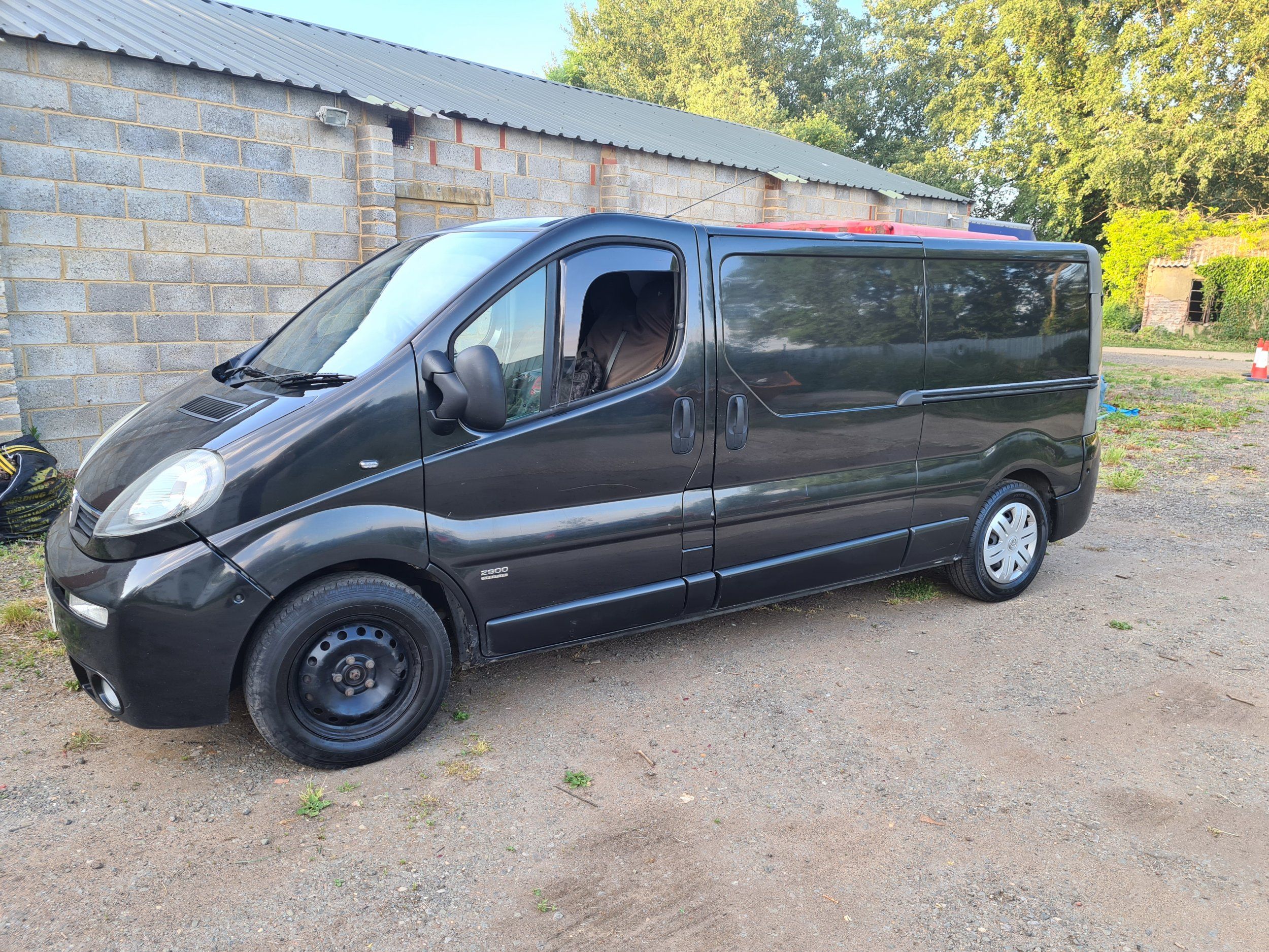

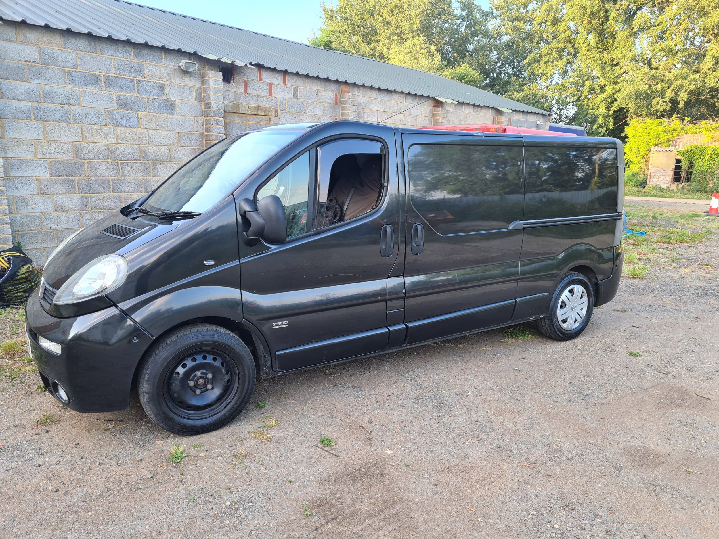

Couple of small jobs to get on the Leon before MOT re test so washed my van instead.
