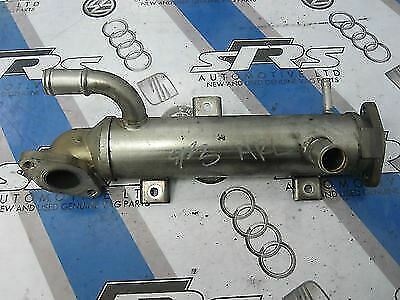

Slowly working my way through the inlet manifold job. Have got the EGR off but the difficult part is how a lot of the videos and guides aren't for the ARL engine and there's the EGR cooler behind the manifold that needs to come off too. I've taken out the 5mm allen bolt that's in the middle of the cooler, but it looks like I have to take off both of the EGR cooler pipes - the one that's on the right and the one that goes to the exhaust manifold. The one to the exhaust manifold has 13mm bolts on it, but the other side looks like an allen bolt on the underside - I'm guessing a 6mm.
Once that's off, it'll hopefully be plain sailing, but I'm not going to rush it - will spray the EGR cooler pipe bolts with penetrating lube and have some lunch, then try to get them off after the lube has had a chance to sink in a bit.
If I don't actually have to do all this, let me know! To get the EGR cooler off, it seems like I'll have to undo some coolant hoses too, which seems like another layer of faff. Ah well...

I didnt take any coolant pipes off when i did my ARL (twice). I think you just undo the cooler bolts and theres enough movement in it to get the bolts/manifold out.
Stupid question, but where's the other one? There's a 5mm allen one on top in the middle, but I've felt around and can't feel anything else in there that feels like a bolt.
Looks like I'll be stopping at Halfords when I get lunch so I can grab an inspection mirror...

Just found this on an eBay listing. Who needs mirrors with all this technology? Looks like the other two are just either side then on the underside...

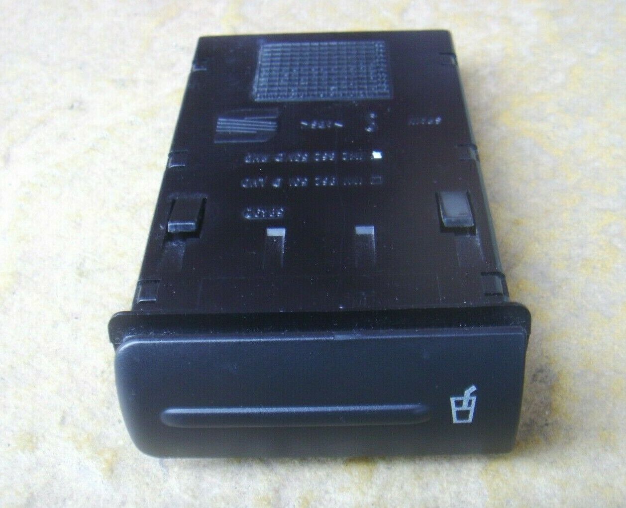

CUP HOLDERS!!!!!
As ive sead before, i want 2 cup holders in my car.
Just out clearing my car out of 18 months of random crap and had a look at the replacement cup holder i bought to replace the broken one i have fitted.
Finding a lhd one can be easier sead than done.
I found that the front panel just unclips and can be flipped round so will go in place of the heated rear window switch.
Just need to remove the white cup emblem from the front and bingo, 2 cup holders.
