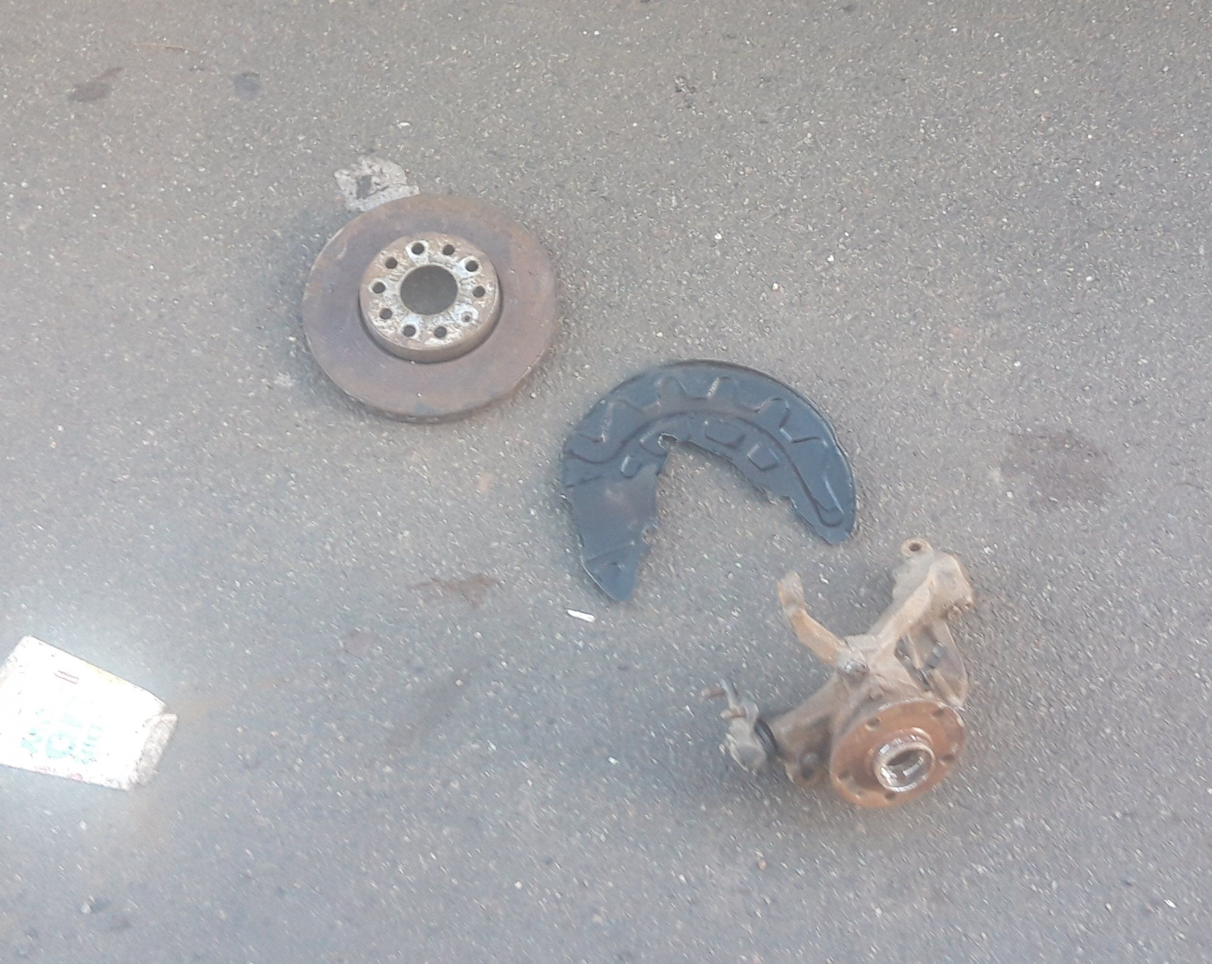

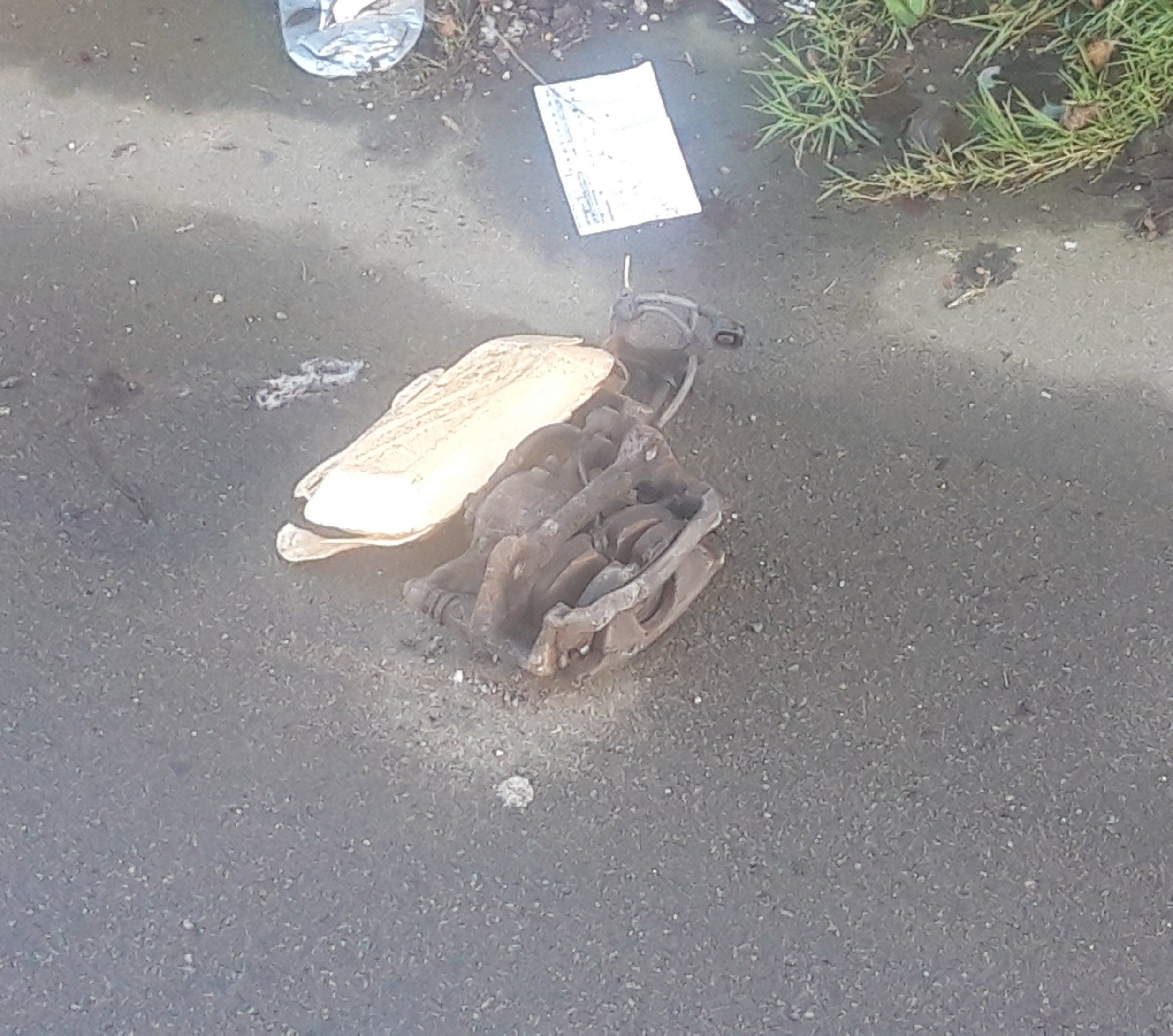

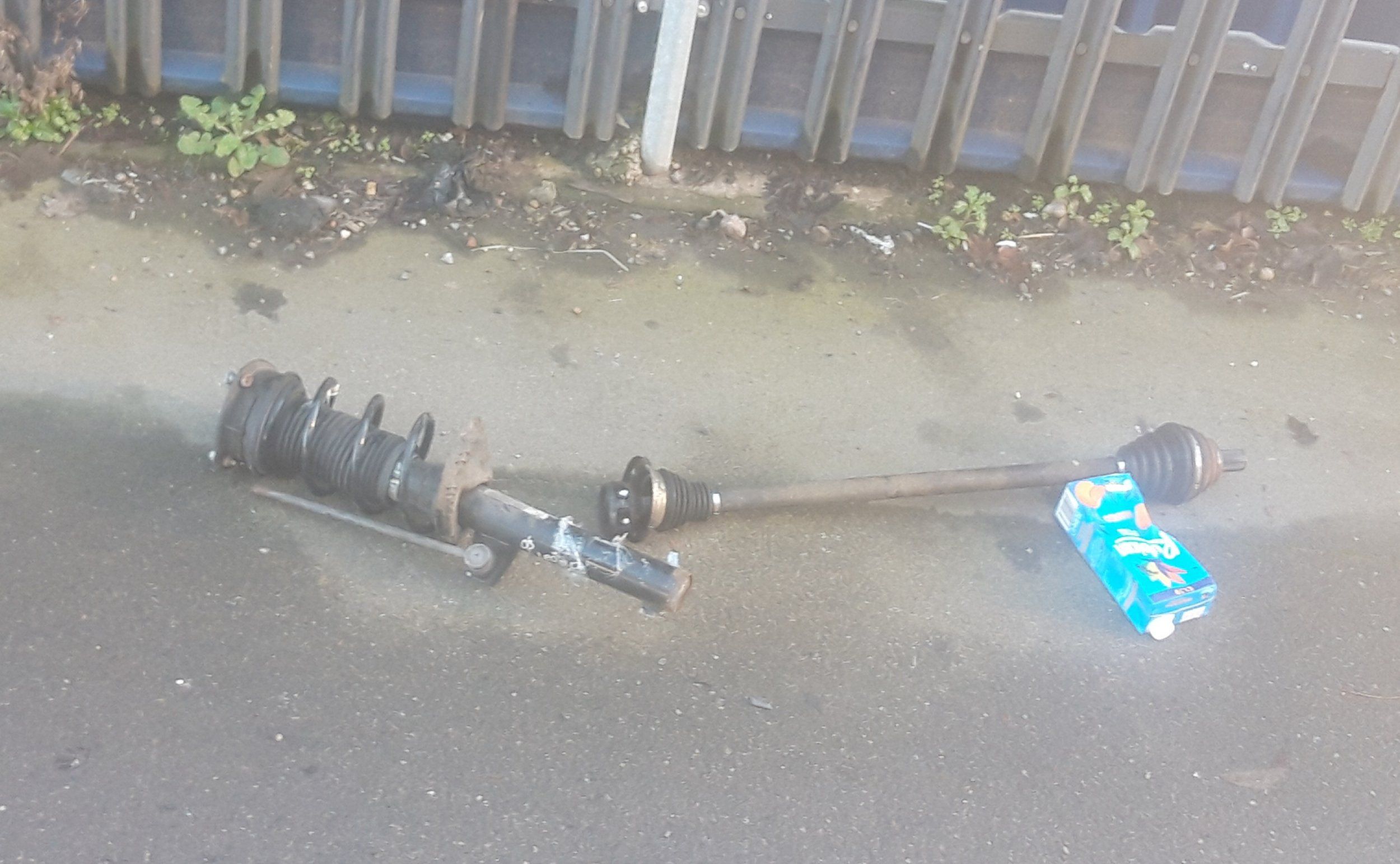

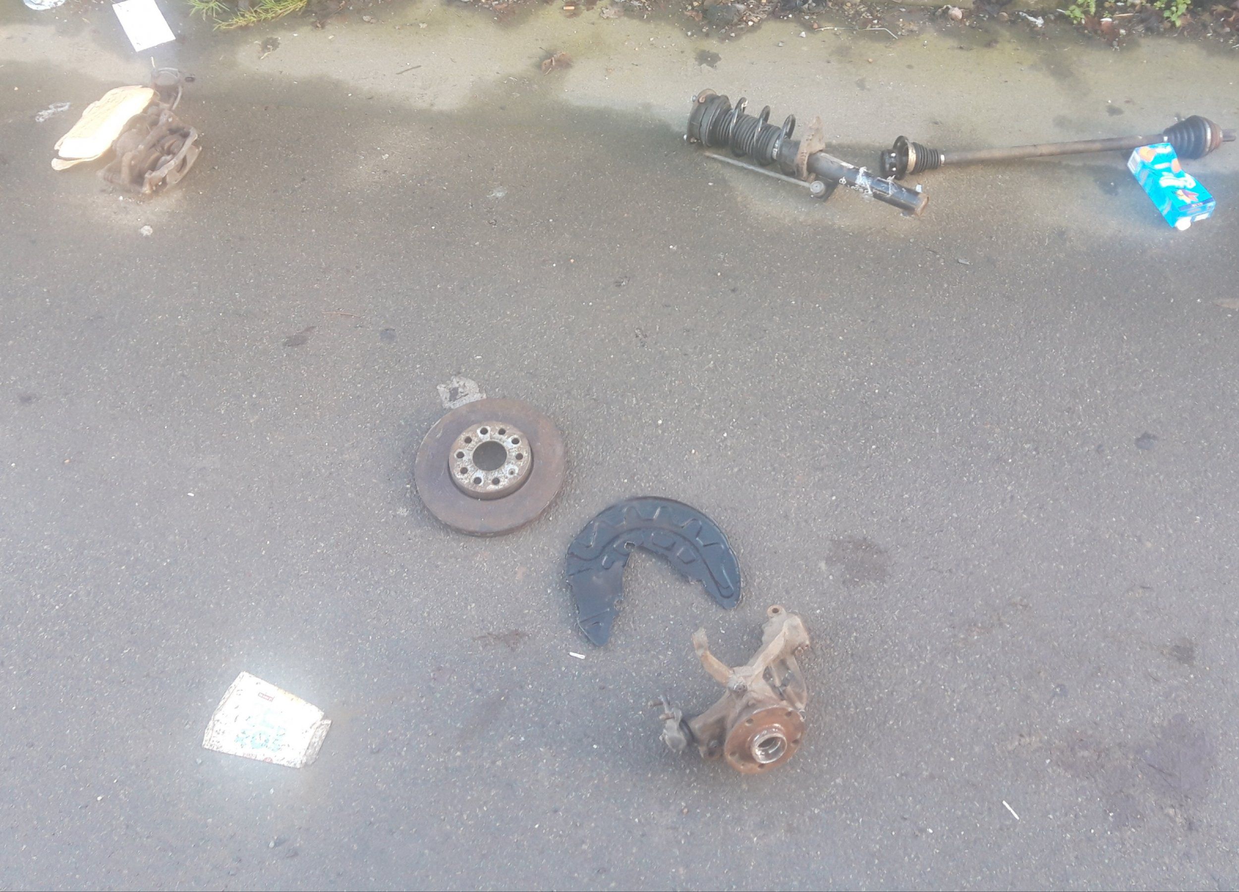

I don't have the space, but I do like doing the spanner work - but that has led me to places I'm probably not qualified to work or I'm a bit out of my depth. It just really gets to me the amount of money some people spend at garages when if they have the time, it's an easy job, and I haven't really worked out where to stop.
The car still drives though, so I can't have done too much damage over the years.
I'm just looking at tools to do the nearside front wheel bearing while it's on the car. I find the biggest problem is that I'm not as fit as I used to be, so the heavy jobs knacker me out.
Thankfully most of the jobs I need to do right now are in the engine bay, but we all know that's not without its problems, and those jobs always mean I end up with raw knuckles - even if I'm just topping up the washer fluid.
I find the best thing about working on these cars is how cheap spares are. For my front wheel bearings I picked up a pair of hubs, rebuilt them and had someone press the bearings out/in (good job too as one near maxed out the press, I'm told it was quite an explosive experience). Took a day to swap them over (although I had new shocks going in which also saved time)
