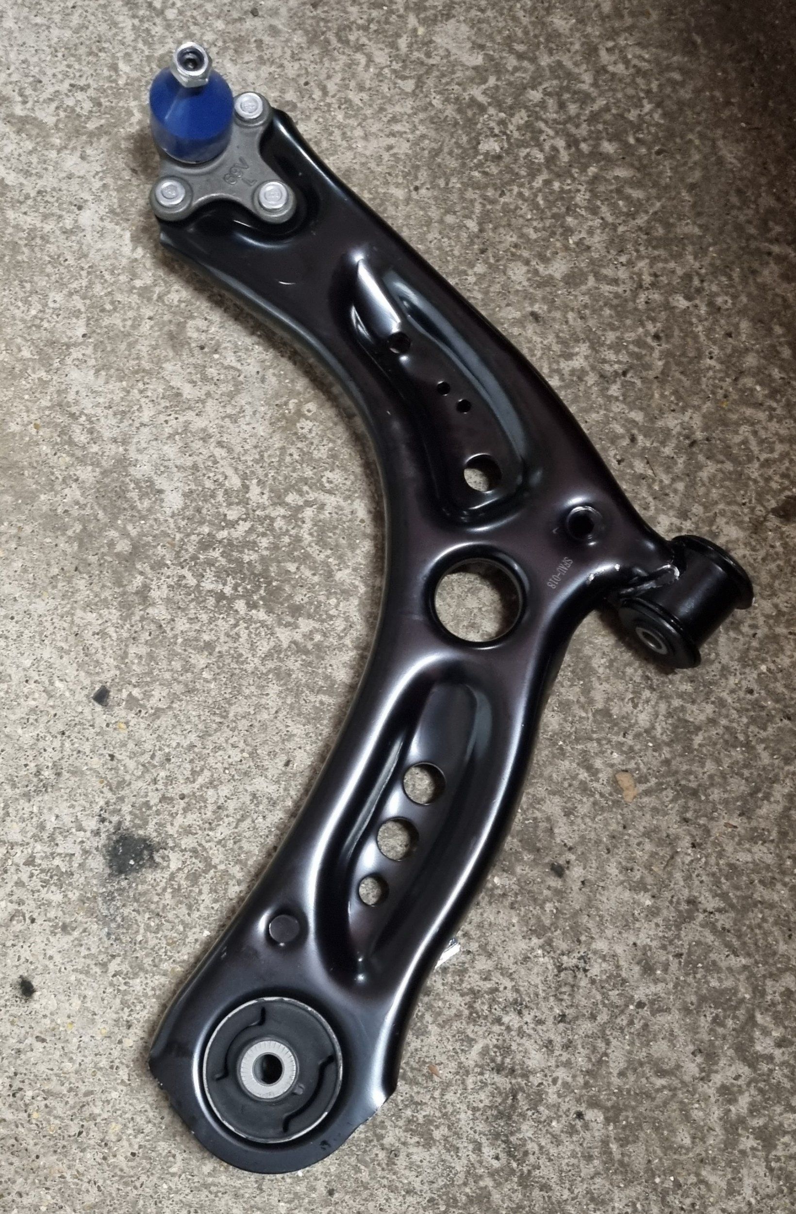

Umm... so I went down a bit of a rabbit hole this week, researching something, getting no real answers, and ended up buying something on eBay
Yes, it's a lower control arm for a Leon... a Mk3/3.5/4 Leon. Looks very similar to the Mk1 Leon one doesn't it.
So the car up in the air and got the tape measure to work.
Everything is the same except the rear bush is 10mm further back and 10mm thicker than the Mk1 wishbone.
May have to get a subframe to gently modify to fit Audi TT 8S wishbones and hubs 😁

From a purely practical point of view, it's not a bad idea. In the coming years, it's going to start getting harder to find parts for our cars as parts aren't produced anymore and stocks run out.
It's handy that we're on the VAG PQ34 platform and share all the components with the mk4 Golf etc. but that's only going to last so long. It's good to know what fits, what doesn't, and what can be 'gently persuaded' to fit.

Also, alloy wishbones + alloy hubs = no rust, and no need for a press to do a wheel bearing. I mean sure, the parts aren't cheap and it means converting to 5x112 stud pattern but still tempting

Got under the car and actually offered up the wishbone. Seems one or two angles are off so definitely wouldn't be straightforward. Still tempted to see what it'd take to get it to fit, just out of curiosity

This is how restomods happen - and I'm totally up for that. I don't have the understanding of geometry and how this might affect handling, but if you can get the front seated OK, the rear could just be a matter of welding the mounting hole and moving it back a centimetre.
Makes me wish I'd been better at maths though...
