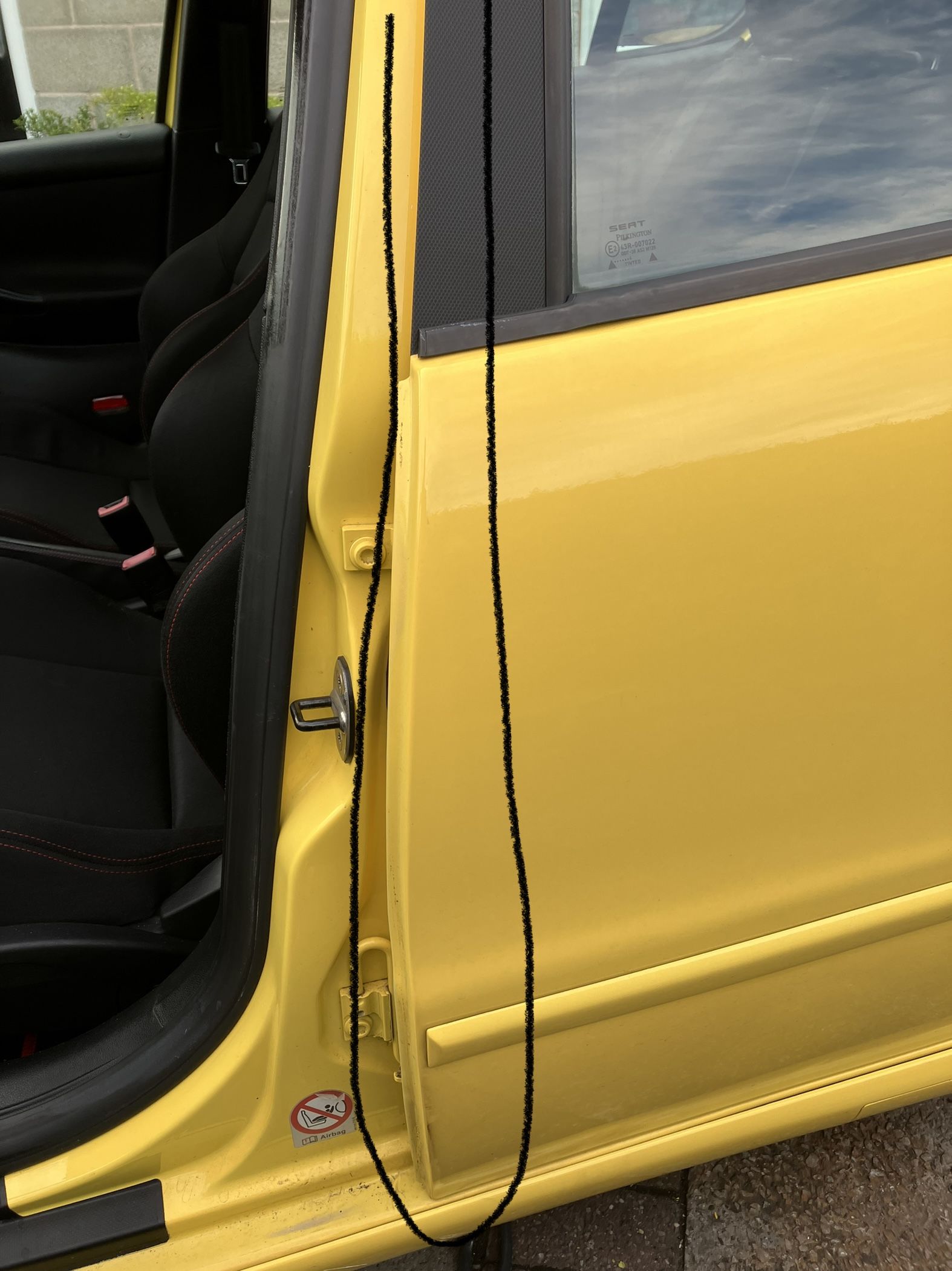

Window and regulator all fixed by the garage, which is a big relief.
"Absolute nightmare" they said, so wasn't just me then!
Check the seal is good.
I had to get my window done promptly a few years ago. Unfortunately my perfectly water tight car, quickly became a foot spa after.
The garage had just hacked the door seals up & the interior plastic handle was damaged too.
Hope your garage have been more professional!
Yeah, need to check it after today's rain. I did put fresh butyl tape seal on it, but some came off when I peeled it off after the glass went into the door.
The garage actually managed to unwedge the glass from the door so it didn't need smashing and replacing. No idea how they did it!
Reactions: BadBoy03

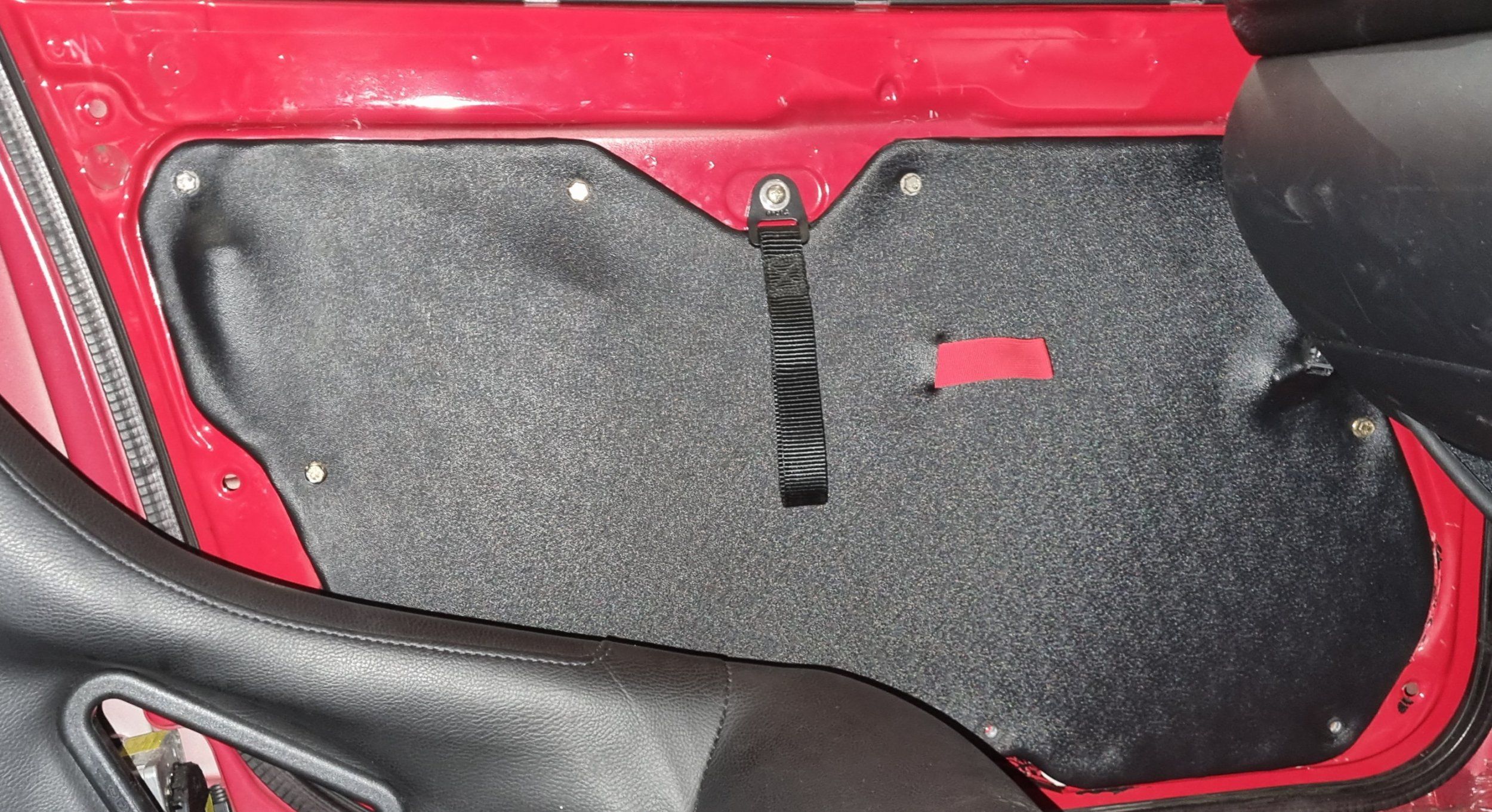

So, been running this door card as a make do sorta thing till I figure out something
Thing is I want to retain the electric window etc because convenience which makes life a bit more difficult.
So, grabbed some plastic, scrap inner card and tools and... well, here's the first attempt
Next is to figure out the essential stuff like door pull (probably gonna use the bolt hole at the top) and pull to unlock but... not bad. Was thinking about extending it further over to cover more of the door but this is kinda growing on me.
Oh yeah, the wiring for the electric mirror isn't routed right now but such is life
