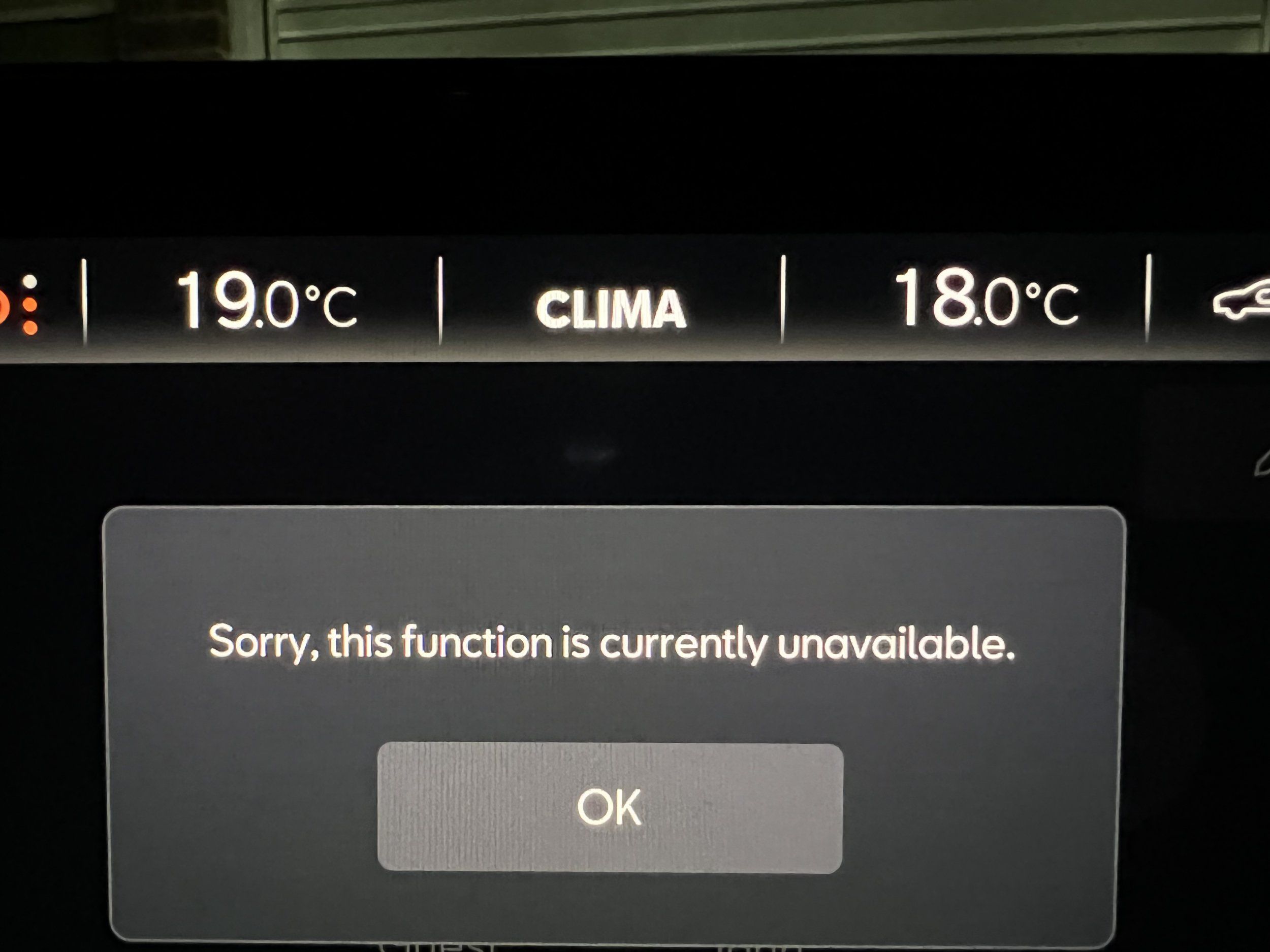

Upgraded to 1896 today, no issues on SOS popping 🙏 But.. i can’t log into my driver profile, keep getting this message.. any one else? Is there a way to re- register the car bu doing the fun 2 key fob thing again?
