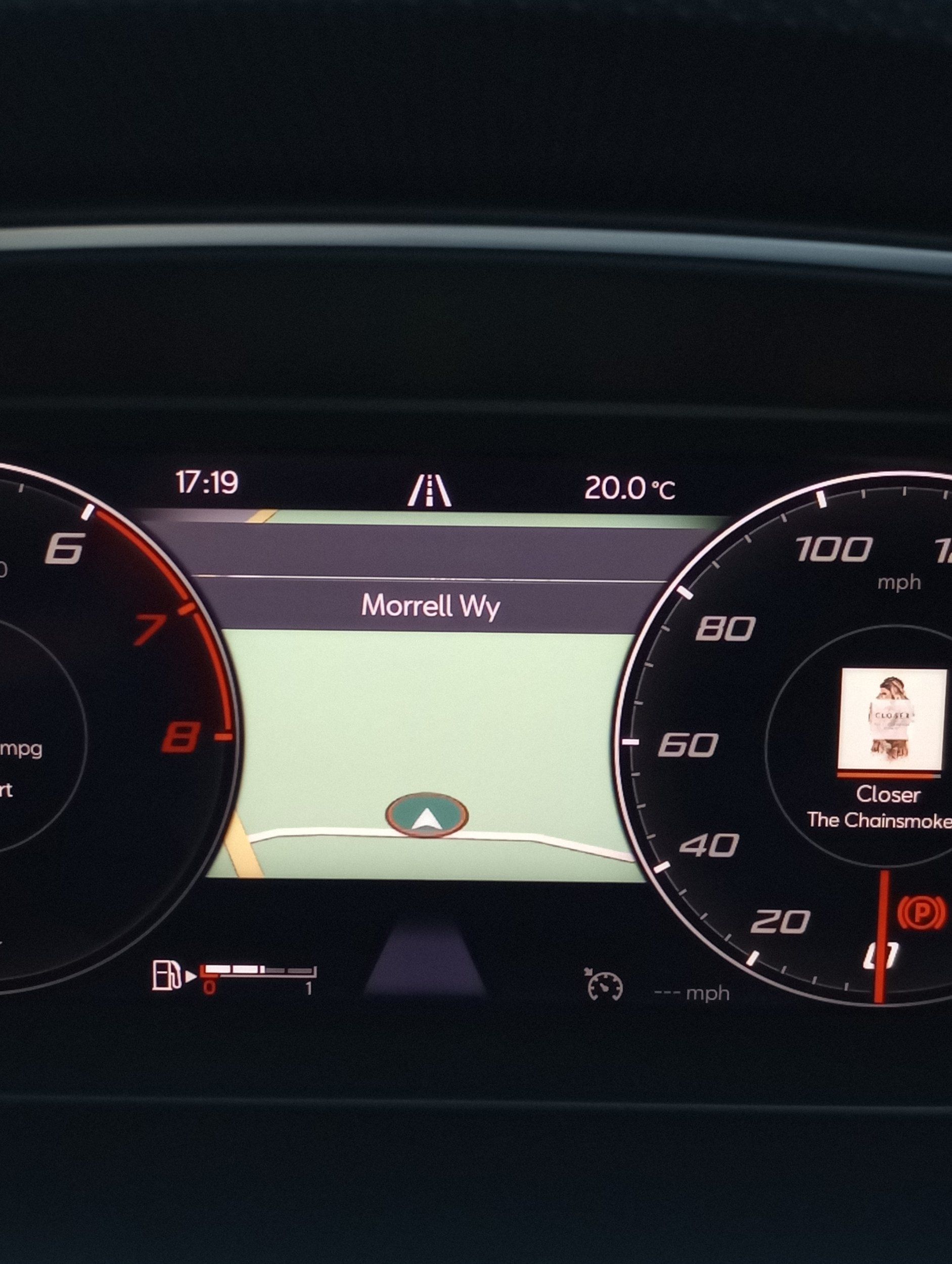

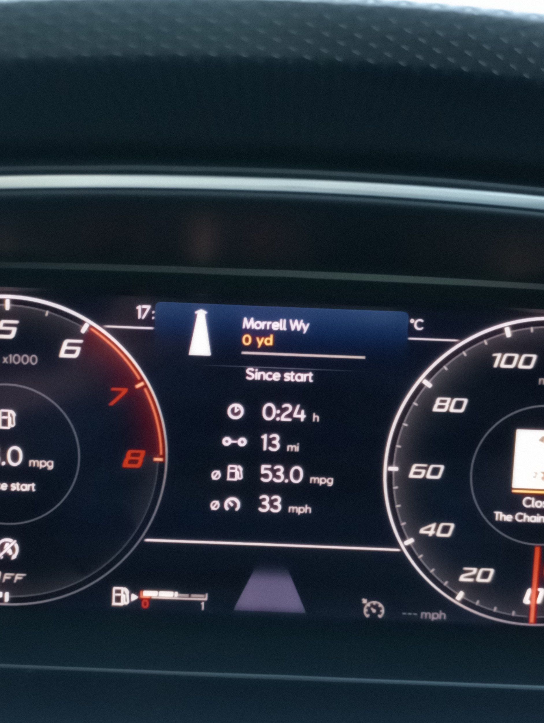

Just had the 1896 update on my 2020 Leon FR. Seems much better overall - just a few issues.
Firstly, I expected to now be able to use wireless Android Auto but still cannot do this - does anyone know if all cars should be able to do this after the update?
I'm now getting the road name showing up on the map on the digital drivers display when using Android Auto but not the directions. Does anyone know if the empty box above the road name in the image is meant to contain the direction? I do get directions when moving to a different view as shown in the other image

The view on the left is the vehicle's own sat nav and not Android Auto. The one on the right is using the directions from Android Auto.
The map is from the sat nav, but the road name is from Android Auto as it disappears when the phone is unplugged and at one point said something along the line of 'Take the 2nd exit' which was directly from android auto. I'm just wondering if other people are seeing something showing in the empty grey bar above the road name when using android auto
