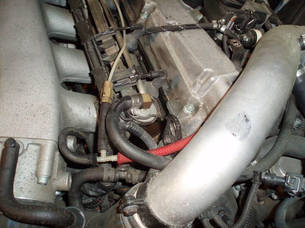

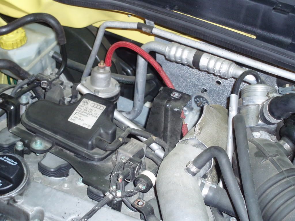

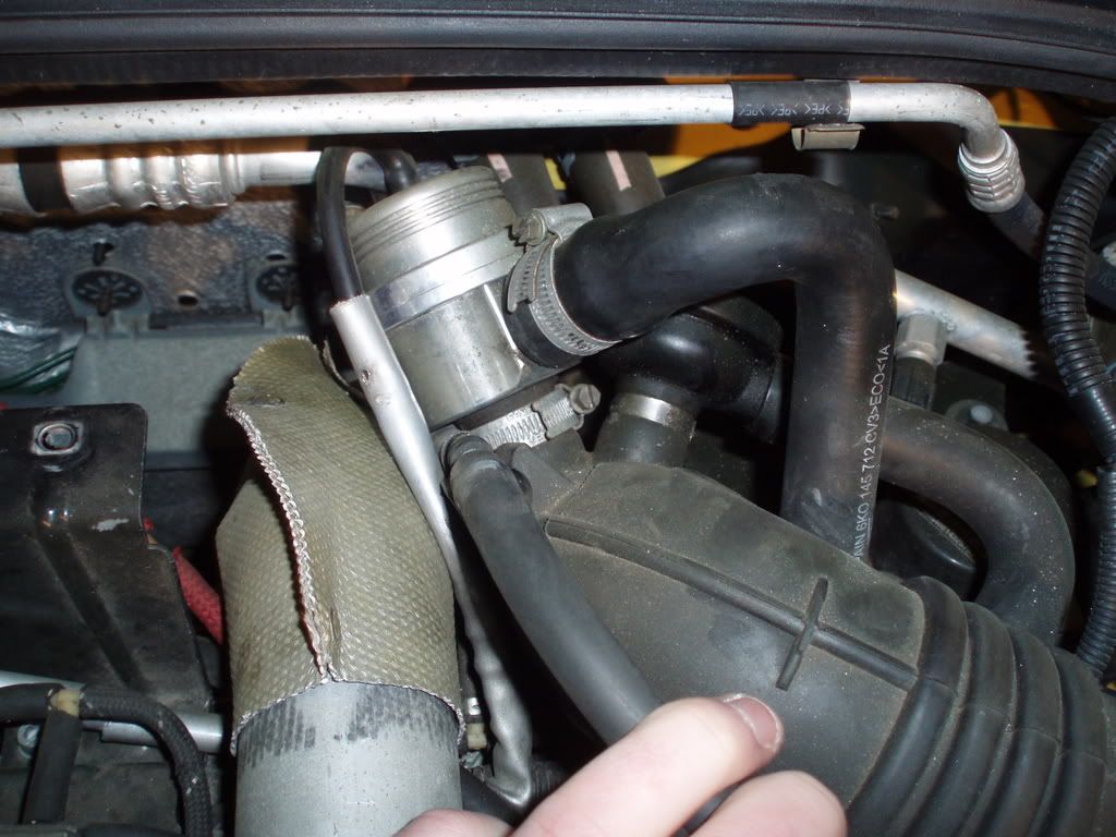

Some photos of my engine bay (possible powerboost valve?) before bypass
Also what type of dv is this

That 'powerboost' valve looks very wierd, never seen anything like it before. If i can make it up the road just after the new year ill have a look at it and see if we can get it out of there :)

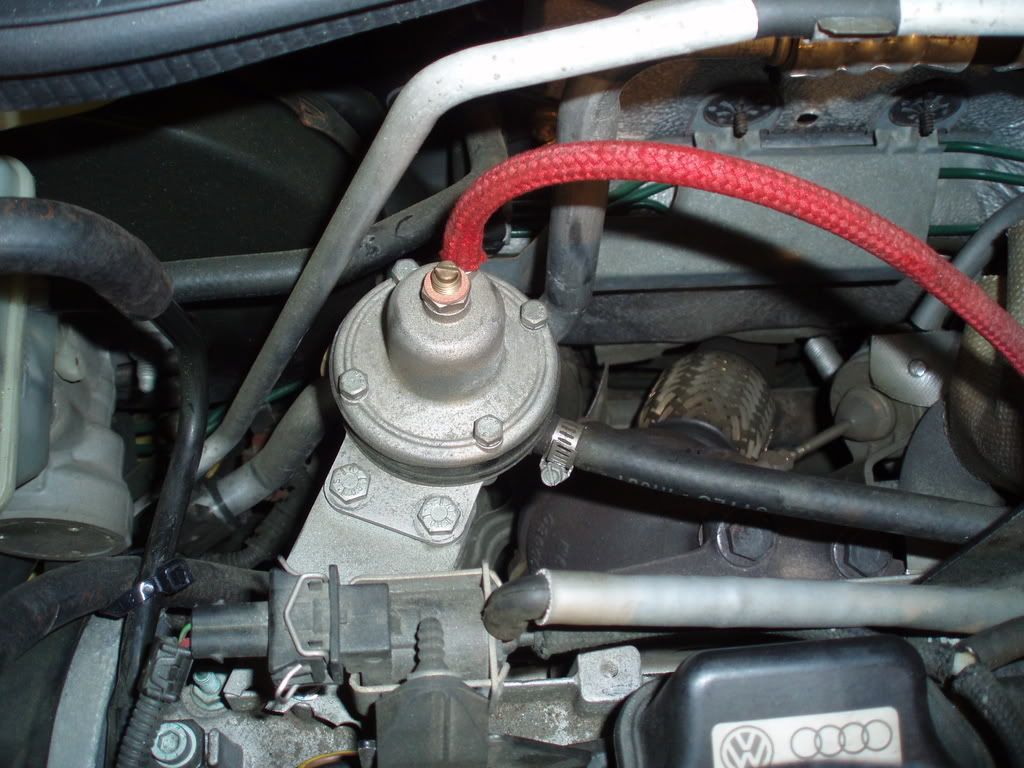

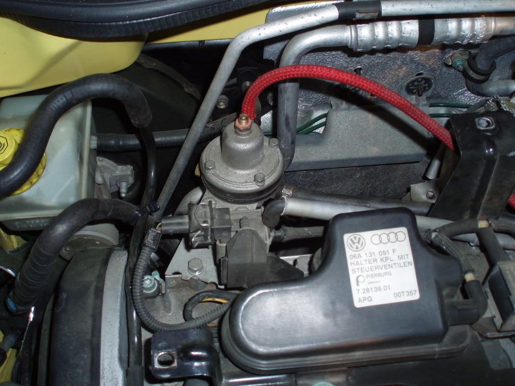

Right guys done some searching and it looks like its a fse powerboost valve
Are these any good? i know i would need to go buy a guage but is it worth it or would it be better to go back to normal fuel delivery?
Pidge
I
Oct 11, 2008
76
Aberdeen
Ah thats what i suspected it might be will.
A rising rate fuel pressure regulator. Bit ghetto if you ask me :doh:
Has your car been mapped at all past standard? Depending on the map you should get a 3 Bar (standard) or a 4 Bar fpr ordered up from vw. My 4 Bar came to ~£60 so id imagine a 3 would be slightly less?
Could give you a shot of my old one (3 bar) when i pop up to get you going if you need. I should be able to make it up after the 13th of jan (last exam :funk:)
With that rrfpr removed you could get rid of all that nasty red braided line **** and replace it with some proper vac hosing that wont fray and split! Oh and itll tidy your bay up as well :thumbup:
