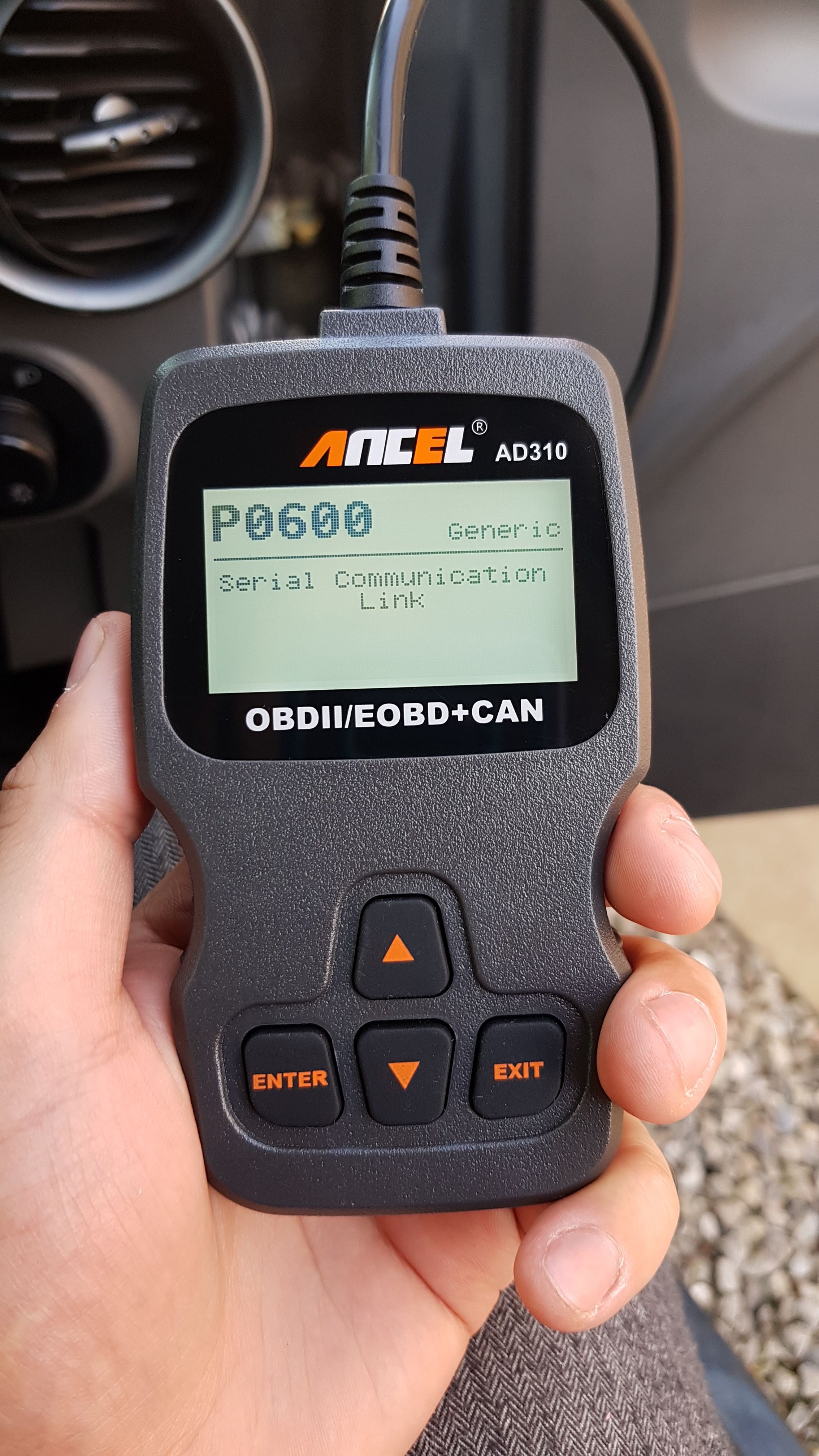

I forgot to mention that sometimes when all the lights come on the engine check light also comes on and stays on. I have an obd ii reader and the code it gives is P0600. Which is a serial communication link, picture attached.
From looking it up I think it shows up when the engine control unit looses communications connection with a component multiple times.
I clear the code and the light goes away but comes back after the abs and other lights come on and off again a few times.

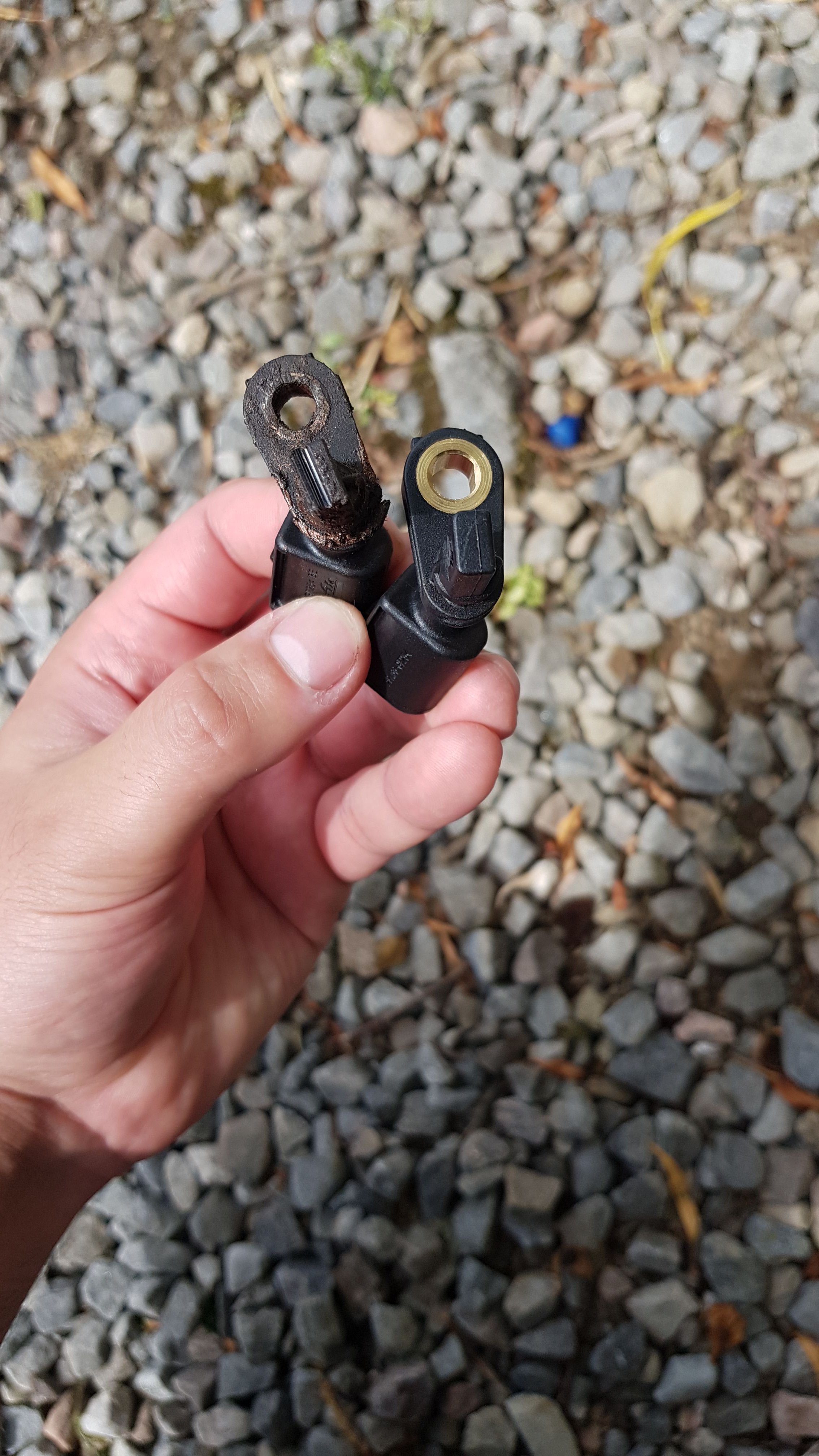

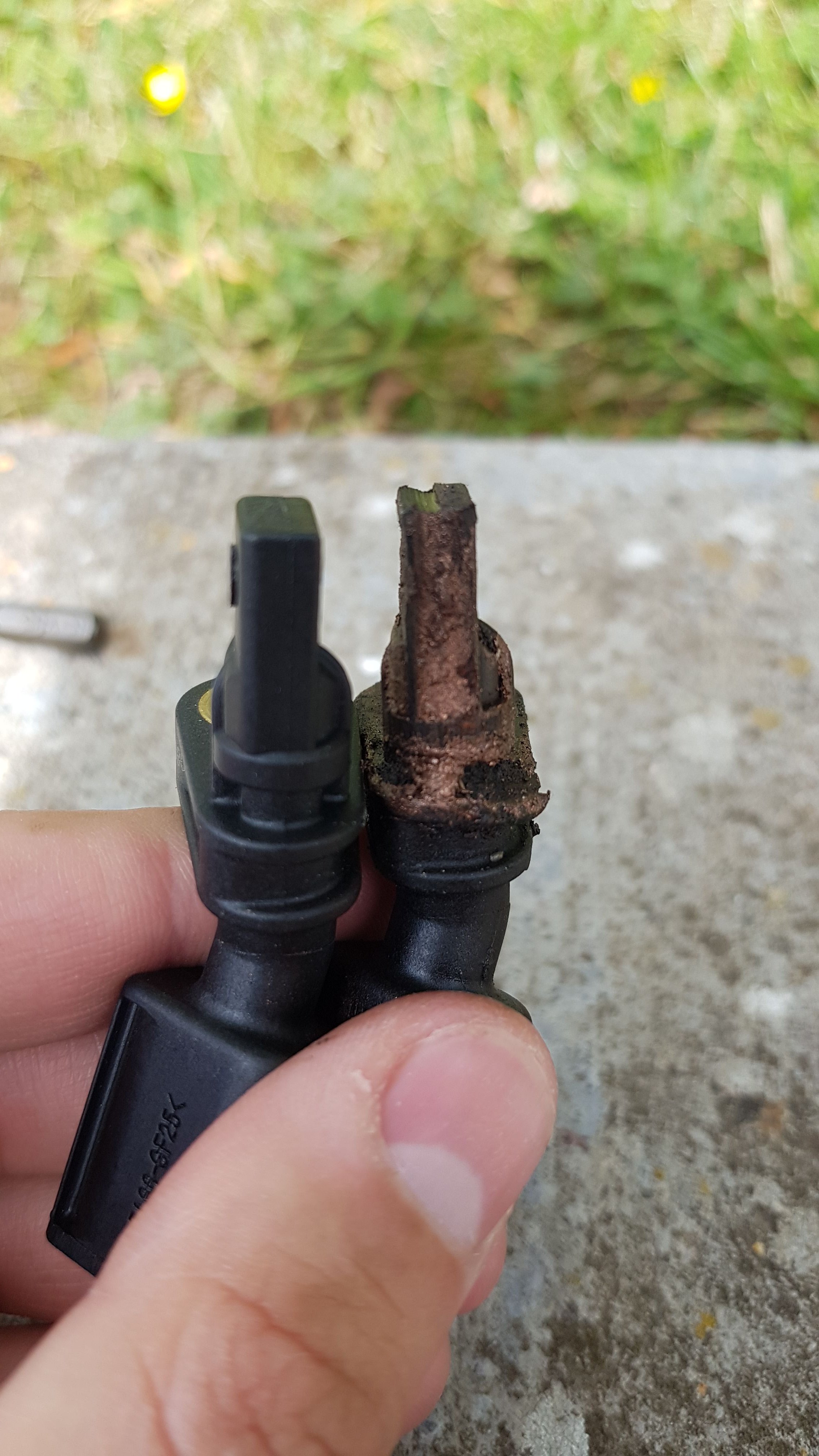

Fitted the new sensor in. There was definite damage to the old one, as seen in the pictures.

The issue persisted a couple more times before the bearing was replaced but at a much reduced frequency. Went down from happening everyday to happening once or twice a week. The old bearing had damaged the new sensor I put in as a week after I put it in I checked it to see and there was a lot of gunk around it and scratches to the bottom. So when the new bearing was put in another new sensor was also put in and now it runs brilliantly.
