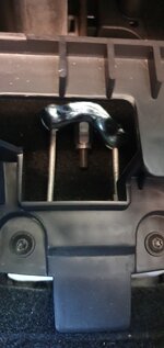

I've recently replaced a OSR calliper on my leon for being siezed. I replaced the rear discs and pads also! However since I noticed the handbrake did not feel great and had a bit too much travel. Seems to be binding (working harder) on the OSR. I checked the adjustment mechanism to find the cable pulled tighter for the OSR. any help would be appreciated.

Could need new cables?
Did a rear caliper and pads on mine not long ago, handbrake didn't feel great after so cables were done and it feels perfect now.
