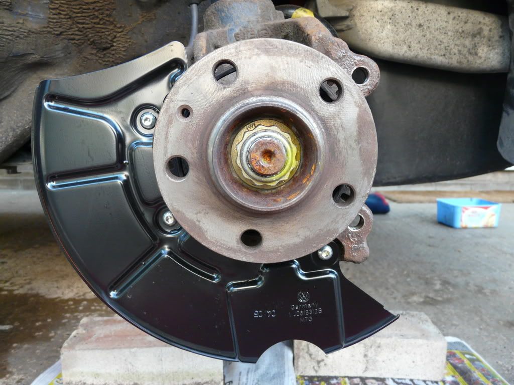

I'm looking to upgrade my front brakes to 312mm and have everything I need apart from the splash guards. I do want to fit these but my dealer seems unable to help as i don't have the chassis number or reg of a car with these parts fitted.
So basically does anyone know the part numbers for the 312mm disc splash guards for a Leon?

Assuming they are the same as a Mk4 Golf with 312 brakes the part numbers you need are:
-312 Splash guards 1J0615311B and 1J0615312B
I did this to my Mk4 Golf the other week, they worked out about a fiver each inc vat.

If it had the 312 brakes from the factory then it should have the 312 splash guards.
Some people upgrade from 288's to 312's but don't necessarily fit the bigger splash guards.
When I converted to 312's I wanted it to look factory so for an extra tenner I bought the 312 splash guards.
I assume the splash guards are there to try and prevent the discs from warping or cracking from splashed water when the discs are hot?

I'm about to do the conversion & I won't be putting back plates (splash guards??) back on. No point in my opinion as they just reduce the ability for the disc to cool. In motorsport, they remove them to aid cooling.... With regards to cracking discs, a few years ago I did road rallies in a Nissan Cherry Turbo & on events the discs used to glow orange regularly and with being in Wales the roads were very wet very often & I had no problems with cracking or warping. Unless you want the 'OE look', don't waste your money to reduce efficiency.
also i think they may prevent stones getting in behind and damaging the abs sensor too, like what happened to mine...

Im going to be ordering some 312mm splash guards next week for my upgrade. Do they also do them for the rear in 256mm or would i not need them for the rear??
Yes you can get them for the rear however they are a bit of a pain in the backside to fit because you have to remove the rear hubs to be able to remove the old ones. It is a bit of a faff and you will need a three arm puller. The other option is to cut the lip off the original one. Personally I went down the OE route and brought the rear guards and am very happy with how it all looks. Plus I can sleep easy knowing that they muck and stone can't score my discs.
