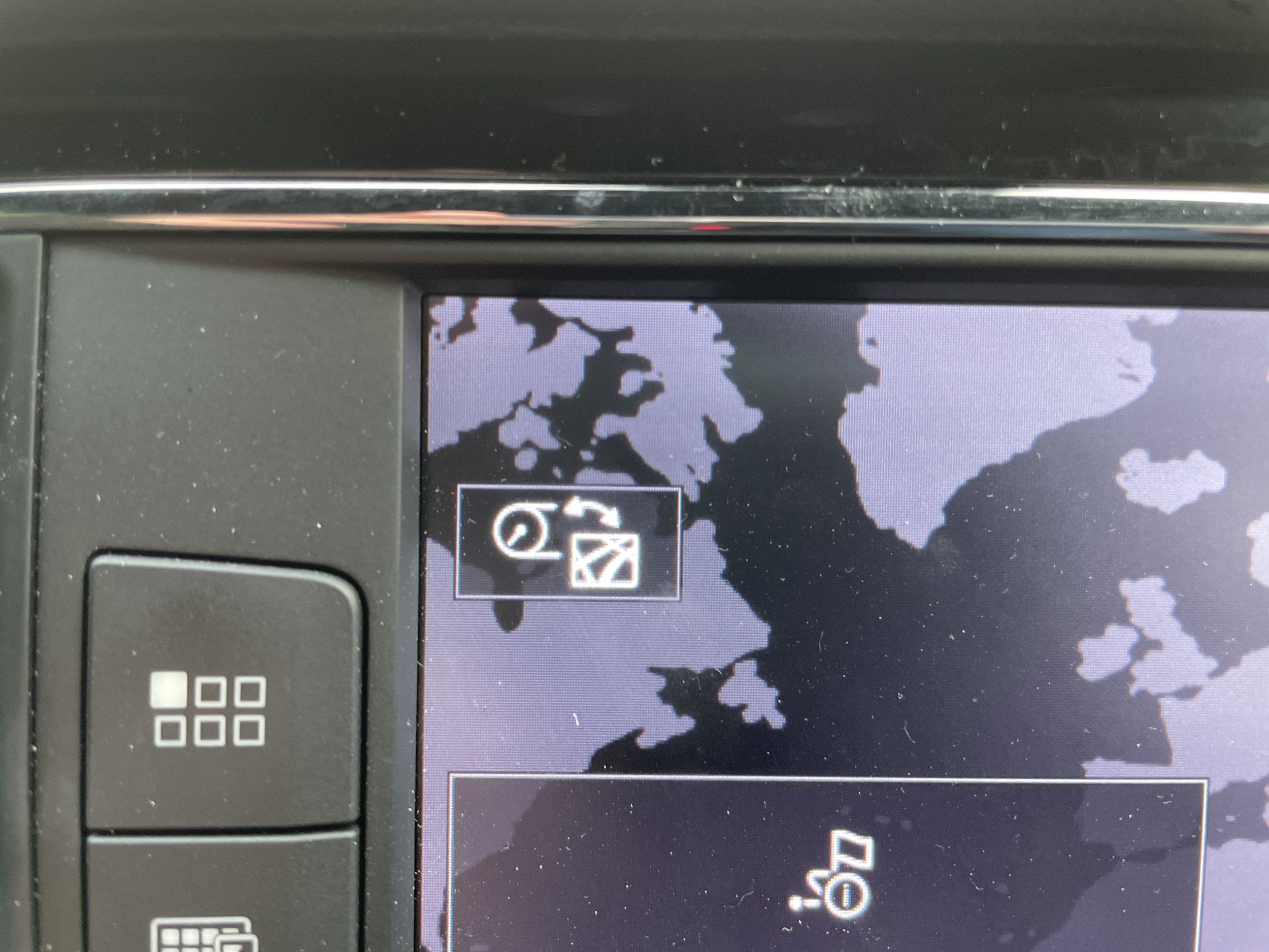

open the navigation on the radio and click the map flip icon on the top left. In the case of the MIB2 standard unit, you can display the map on a virtual cockpit or on the radio (at the same time it is impossible)
while on the virtual cockpit you have to click the arrows (those on the right on the steering wheel) to change the view to the map

I guess that there are two different issues here:
i) is the dash/nav/infotainment hardware configuration able to perform the function and correctly coded?
ii) if correctly coded, the above method for transferring nav display from infotainment to digital dash is above (picture below with the icon required on infotainment screen).

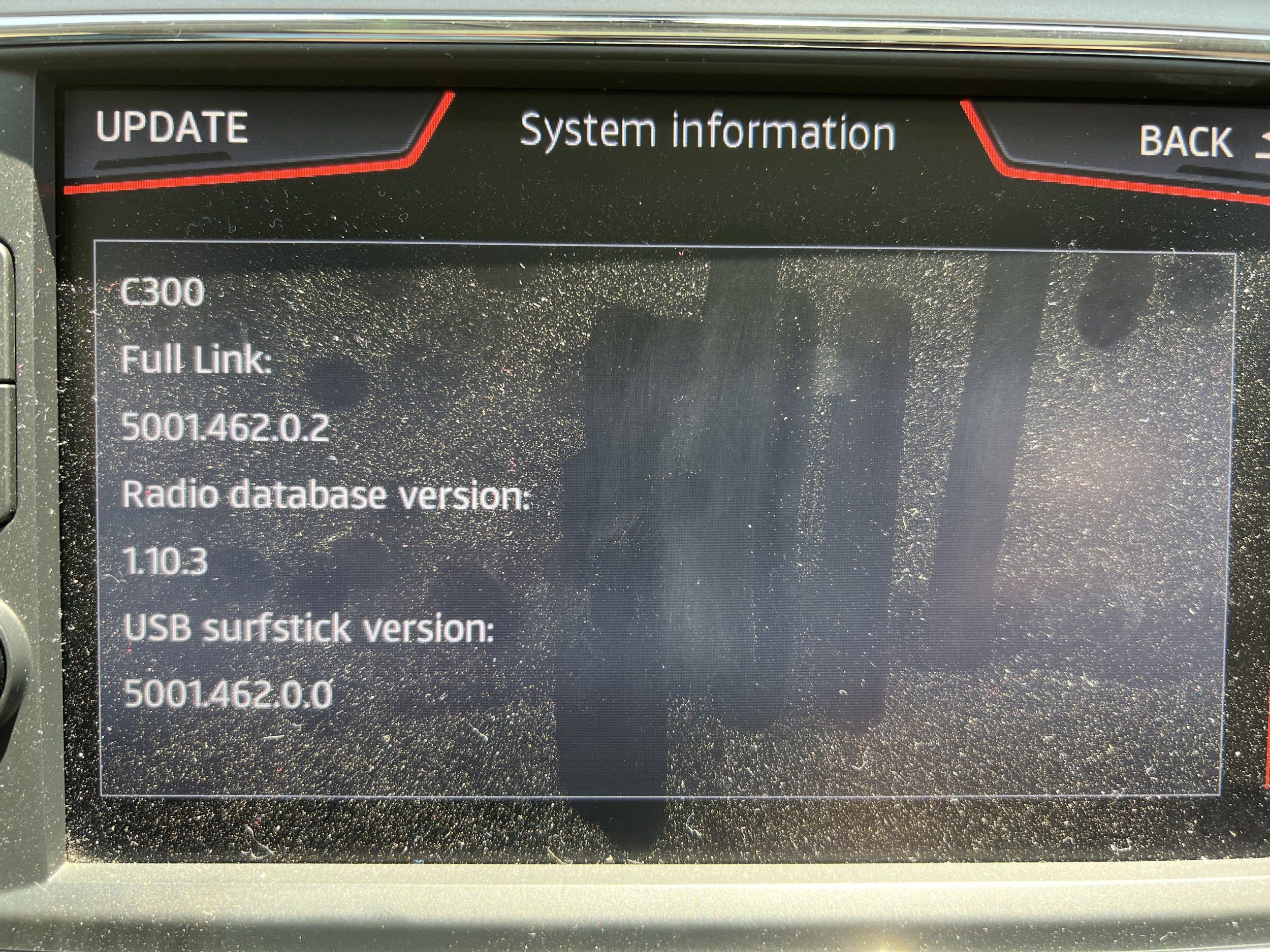

Dear All,
please find my attached picture as it shows my infotainment system model and info,
i tried to move maps to virtual cockpit but again i could not, i think i dont have a navigation built in, and i want to know if there is any code i can do so i can activate it ???
i just need any help
Dear All,
This information isn't any use. We need to see the system part number
If your unit doesn't have navigation,then you can't have navigation on the instrument cluster without changing it
Is the cockpit factory fit or retrofitted?
all of them are factory fit, my virtual cockpit is factory fit, but I found many people activating it with coding but I don’t have any idea if they add maybe the navigation hardware to fit in the system.
You need a navigation unit to have navigation
Go to settings, system information & take a picture. Part number will start with 5F or 5Q
