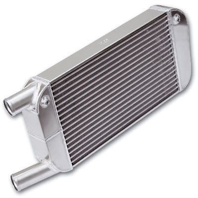

We can confirm that the FMIC kit will fit the Mk4 Golf, Audi A3, A4, Seat Leon Cupra with VAG 1.8T engine. We are not too sure about the Cupra R. However if you are willing to try it on your car and provide us with feedback then I'm sure we can come to some agreement.
The dimensions of the core is: 510mm x 165mm x 70mm.

Looking at the intercooler it should fit the R and not the Cupra as the inlet and outlet pipe are either side of the intercooler.
The cupra has one single intercooler and needs the inlet and outlet pipes the same side - I owned a cupra and i had a intercooler with the inlet and outlet pipes the same side - the only way it would fit a cupra is with alot of pipe work
Im no expert just from speaking to people - so hope this helps ;)

Ive got two pictures so if i didn't explain it well enough :)
Both of these intercoolers are from Forge
Cupra R Intercooler - Inlet/Oulet Either side
Cupra Intercooler - Inlet/Outlet Same side

Yeah to me the turborevs one seems concidurabley smaller in height than the forge one too which surely will reduce cooling also wondering how the turbo rev one will be mounted as with forge you get a modified crash bar dont you
This to me seems that it is in fact designed for the lc due to the excessive amount of alloy pipes you get
which simply would not be needed for the LCR
It also does not state the TT/ S3 which to me is concearning as its more of a TT one is required than a golf one

what doesn't make sense is that the turborevs one has the inlet and outlet on opposite sides which, would imply that it had been designed for an LCR however, they say it is designed for the golf etc. (which is presumably the same design as the LC) so their design is counterproductive to simple and correct fitment (on an LC/Golf/A3)!!!
If that little thought goes into the design, one assumes that little thought has equally gone in to the rest of the design, i.e. mounting, performance, etc. I'm inclined to think that performance wise it will not stack up against the one from forge but perhaps for the difference in cost (on an LCR) it might just be worth that bit less performance wise.
Also, as has already been pointed out, if this doesnt come with a modified crash bar, fitting it to your existing crash bar could be an absolute bitch!

That is pretty small dave, is the Forge one not about 800mm x 300mm or summit?
