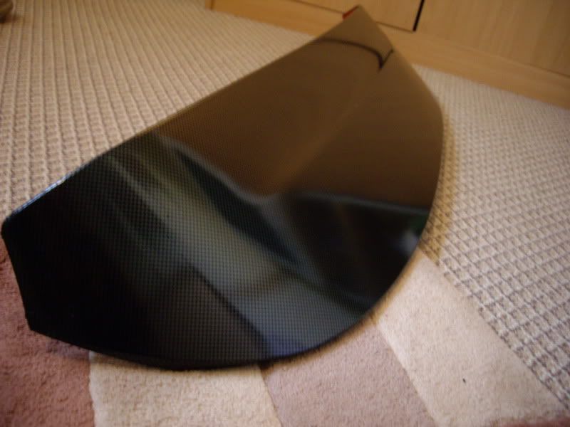

Small Update:
Bit of a marmite mod.
Spot the obvious ;)
All had my brembos deliverd Friday but im not going to bore people with pictures of those until there fitted.
Should also have pictures of the new Kinetic manifold this week when it finaly comes out of customs, Once thats fitted along with the Brembos the car should be pretty much back to full strength.
Once the car is sorted after a few problems ive had ill be carrying on with the bay and will get some WIP pictures up.
